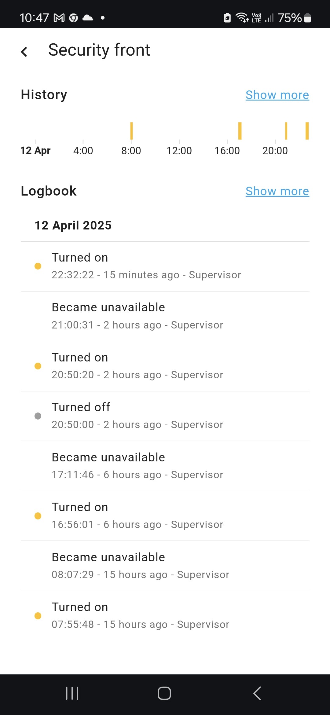

Similar issue. Switch goes off line. I goto the ewelink tab, switch is ok. Back to the main page switch is back on line.
Similar issue that I am having - I have a POWR3, 4 BasicR4’s and 3 4CHPRO3’s. All are running through a Deco P9 mesh system (with decent signal strength) and about 24 clients on the mesh at any time. My system is used to control the central heating and hot water via Home Assistant and, electrically, it’s fine, but it’s really frustrating to discover that these Sonoff units are randomly becoming unavailable (even though they can be seen by eWeLink) and will come back on line if powered off.

Sorry for reviving an old thread but this describes exactly the issue I’m experiencing with all Sonoff devices in HA. They all work fine using the ewelink app but become unavailable in HA seconds after reviving them by opening the ewelink app or turning them off or on manually.
Has anyone found a solution to this yet? I am using the SonoffLAN integration and have never installed the ewelink integration.
