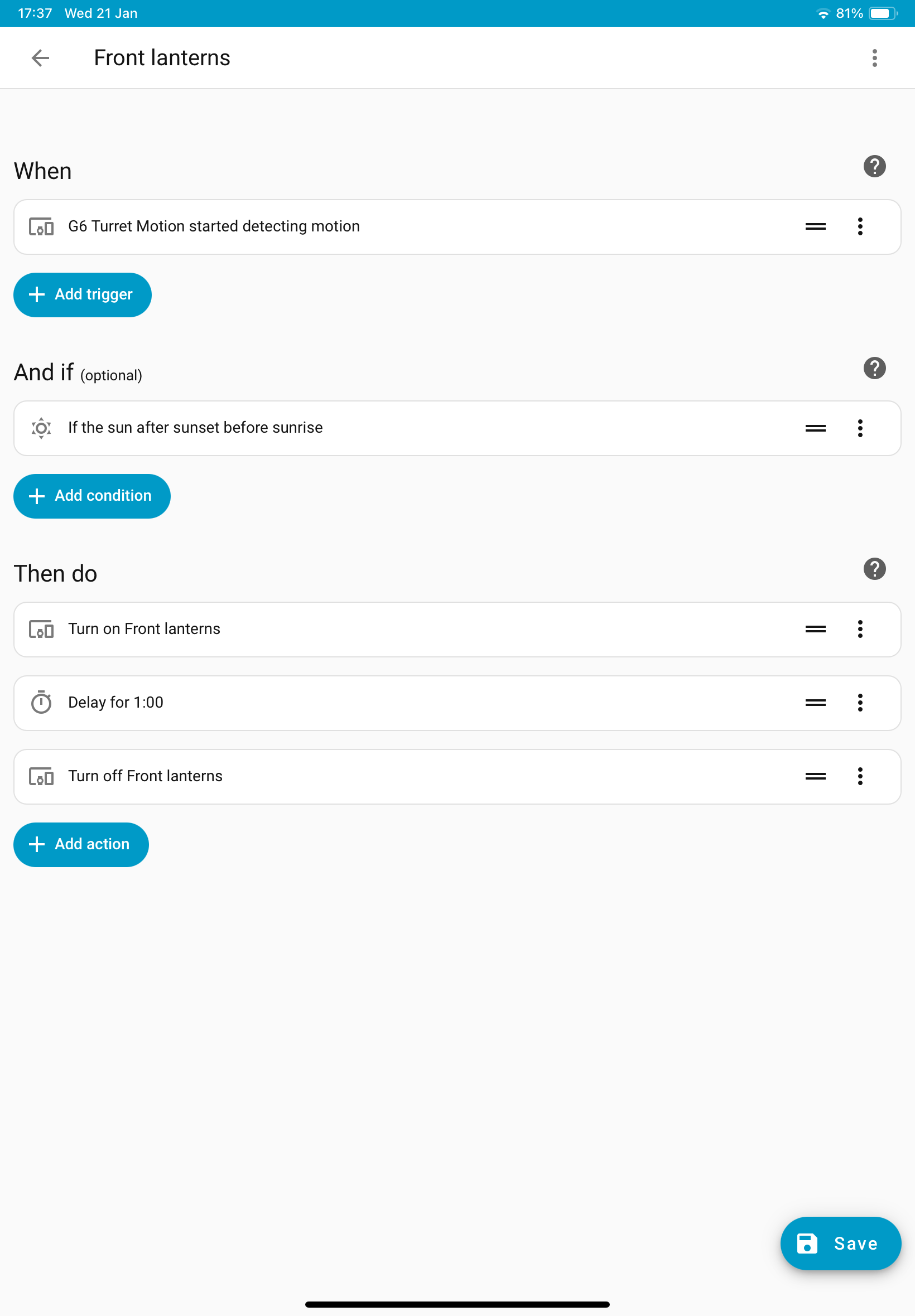

I have a Sonoff XB Mini R2, zigbee switch on an automation running 2 porch lights. When the Unifi camera detects motion the lights come on and go off after a minute.
However, when I want them on, say for Amazon delivering in the dark I switch them on to stay on.
The problem is if the camera detects something it starts the 1 min timer from the automation I set. How do I get around this. I want my manual on to override the 1 min automation. Anyone have any ideas?
There are a couple ways to accomplish that, each method has their own limitations…
One option would be to just add a condition to your existing camera-based automation. Have it check if the light is already on using a State condition in the Conditions (aka “And If”) block.
Another, more complicated but possibly more specific, option is to use the context values to determine what turned the switch on.
I would probably set up a separate automation that triggers off the switch turning on, using context. If it is turned on manually, set an Input boolean. Then, in your original automation, check the state of that boolean to determine if the light should be turned off. Make sure you include some mechanism that resets the boolean at the appropriate time.

As mentioned above, there are different ways to do this, but my recommendation:
  • In this “Then do” block, click the blue “Add action” button, and search of “if-then”
  • Then you can add a logic to check whether the light (the ZBMINIR2) being off
  • If off, then execute your 3-step actions
  • Otherwise, there will be no action at all under else
That way, when the light switch have already been turned on manually, your 3-step automation would be skipped.
Sounds reasonable? Hope this helps.
