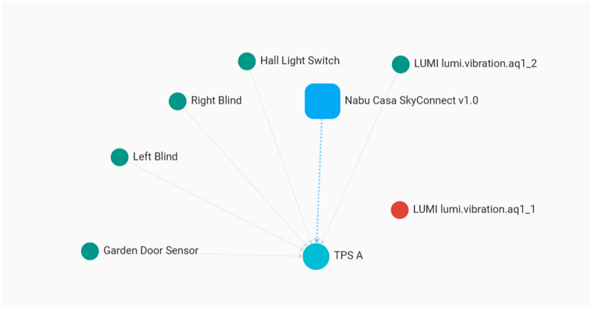

SkyConnect v1.0by Nabu Casa
Connected via [Nabu Casa SkyConnect v1.0]
Firmware: 7.4.4.1 build 0
Zigbee info
IEEE: 04:87:27:ff:fe:1e:ae:7b
Nwk: 0x0000
Device Type: Coordinator
LQI: 255
RSSI: Unknown
Last seen: 2025-06-25T15:04:41
Power source: Mains
