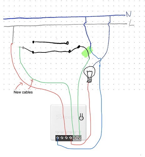

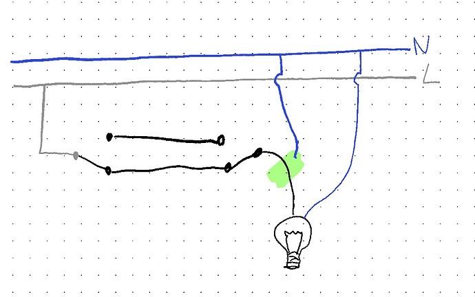

I am trying to install a Sonoff ZBMini (not the L2 version) with a two-way switch, but I am not having any luck. Perhaps it has to do with how we tend to wire lights in the Netherlands. Does anyone have this working, and perhaps has a tip for me? My wiring diagram is below. Do I need to run a dedicated N wire to the light for this to work? I do have an N wire where I want to put the ZBMini (the green highlighted area).
You don’t have an “L” there. It probably needs both “L” and “N” to work.
You’ll need to wire 2 extra cables going to the relay on switch 2 (one for live input, and for S1)
