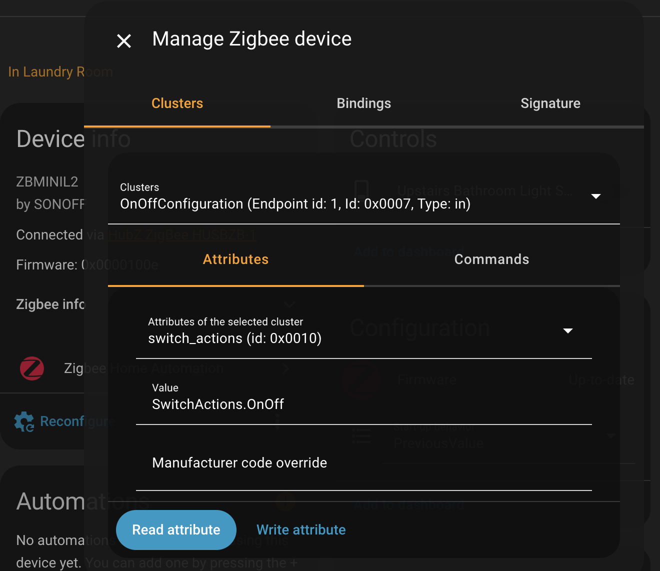

Is there a way to do this? I’m able to make it happen with the Shelly Plus 2PM but I can’t figure out how to involve the “real” external switch status with the ZBMINIL2. I noticed that ZHA exposes a switch_actions cluster but I can’t find any documentation on what it may do or how to use it.
