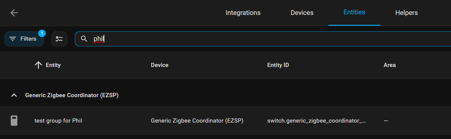

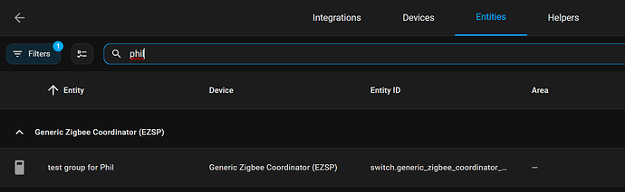

I just created a ZHA group for you and didn’t get any tick boxes, yet I can see the group when searching under Entities. It also shows up as an entity under your Zigbee Coordinator device.

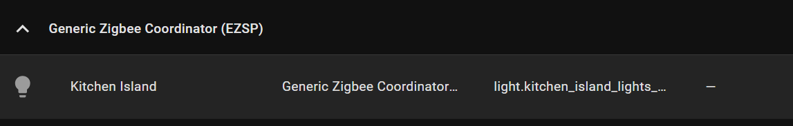

Try filtering your entity list by Integrations > Zigbee Home Automation. Your group should be visible under the coordinator. My group is named Kitchen Island (I deleted the phil group after I replied to you):

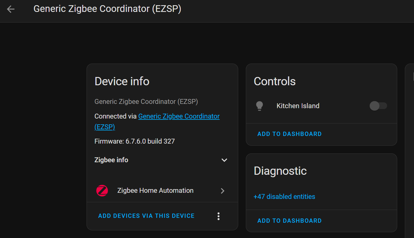

Either that or find your ZHA coordinator and check if it’s listed there:
