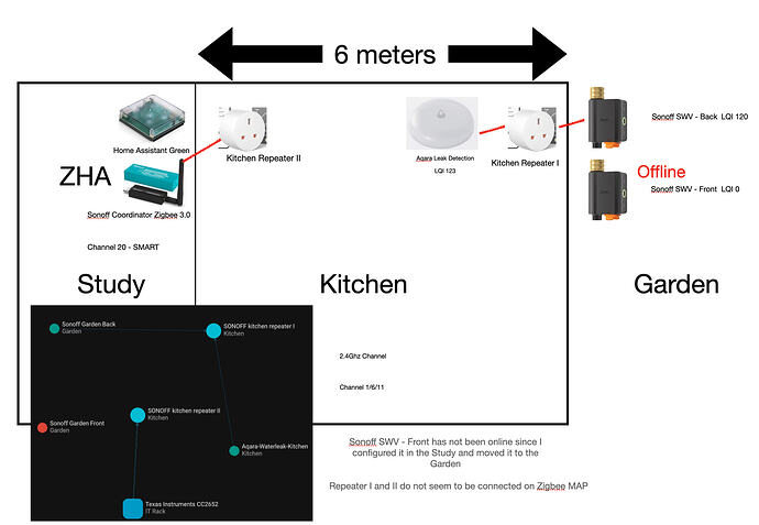

I have a HA - Green and bought a Sonoff Zigbee 3.0 coordinator use it with ZHA.
I mainly use it for my new Sonoff SWV units in the Garden
The distance between the Garden and the Coordinator was too big and the LQI was reading only about 5-10 but devices were mostly offline
I introduced a Sonoff Mains Powered Plug and installed it on the other side of my Study Wall, this did not help, I then plugged it in closer to the SWV unit and this did not help much either, only when I introduced a 2nd Mains Powered Sonoff Plug (II) did everything come online and LQI reading of connected devices is now around LQI 120
Great, so i bought a 2nd Sonoff SWV and configured it in my study but as soon as i installed it outside in the Garden it lost connectivity and it has not reconnected in over 12 hours
Also when i look at the Zigbee map I cannot see a connection between the Coordinator and the Kitchen repeater I, it only shows a connection to repeater II (or router)

I have powered down the SWV Front device and pressed the button on the front but it has not reconnected
Should it not find its way to repeater I and then come back online?

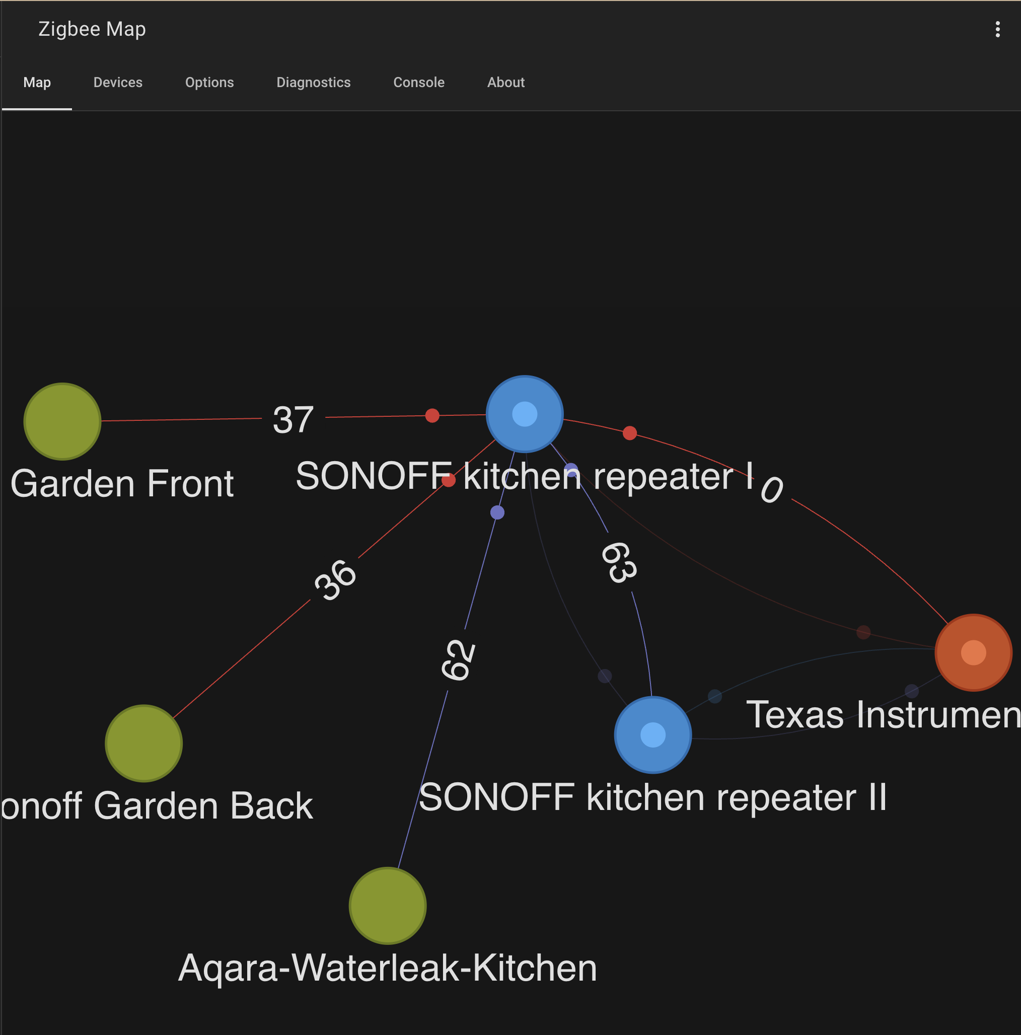

I installed the Zigbee Map HA integration and the LQI values shown in this map are much lower than the LQI values shown in the build in Zigbee map
Not sure which one to believe but sofar I have had 24 hours of solid connections, long may it last!!
I recently added a 3rd SWV in the same location and the front garden SWV continues to go offline so my conclusion is the device is faulty rather than then network as the other 2x SWV have been rock solid, have logged a ticket with Sonoff support, given these things are not that expensive may just return the faulty one to amazon and get it replaced
