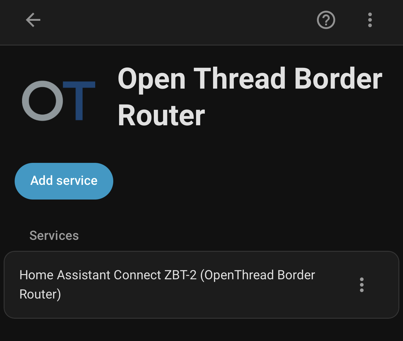

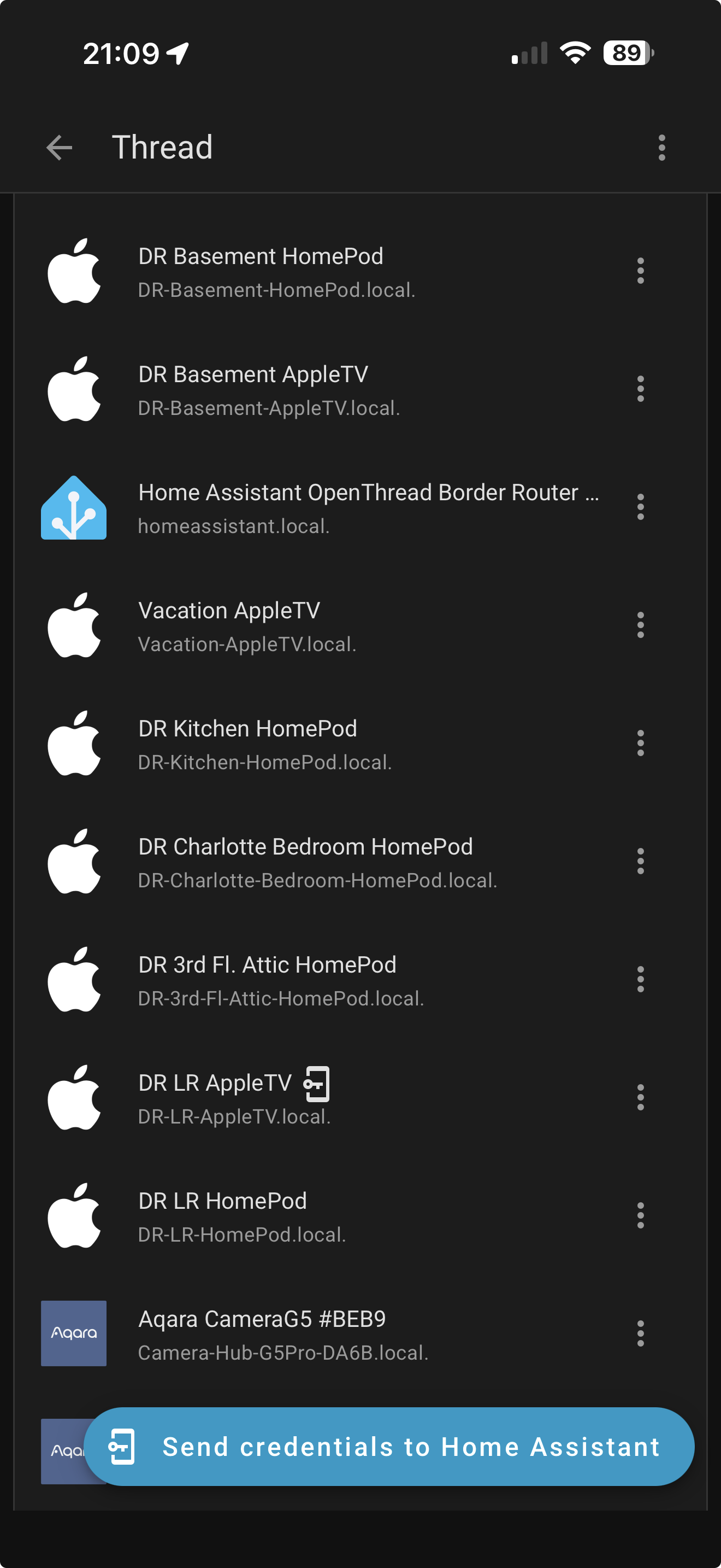

I’m seeing this in my OTBR logs in HA, and my ZBT-2 is
part of existing Apple thread network at my smart home.
Any advice from anyone?
I’m using a Eero max 7 with ipv6 enabled and again, everything is ‘working’ just trying to clean up logs for smoothest running home.
Thanks!
