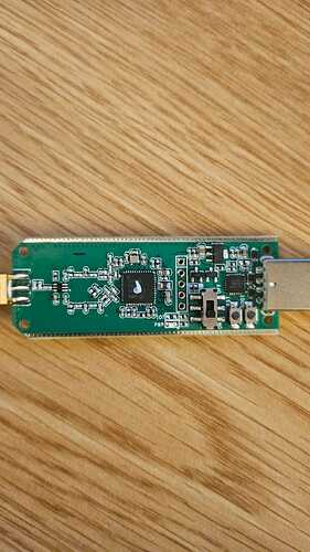

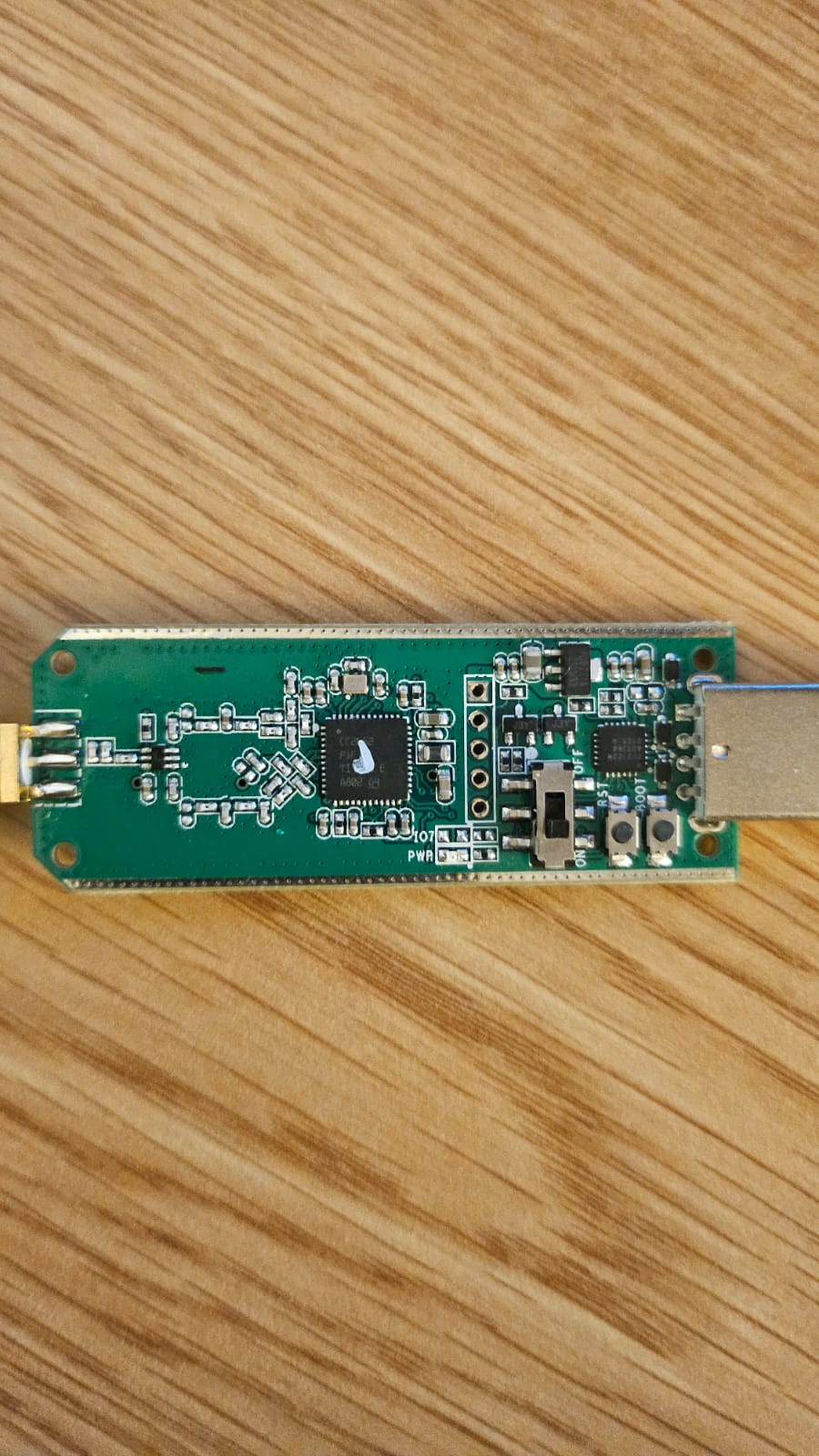

I have the sonoff zigbee 3.0 usb dongle plus (model ZBDongle-P)
I flashed it with the router software. I need more signal in my shed.
However no matter what button i push i can’t get it in discovery mode.

After flashing the router firmware to the ZBDongle-P, you need to keep holding the Boot button, then press the RST button once, and finally release the Boot button.
The Dongle will enter pairing mode when the green light starts flashing.

The best way I have found of doing this is to put your thumbnail on the BOOT button then roll it onto the RST button (so BOOT and RST held at same time) then roll off the RST button, then off the BOOT button.
Once you’ve done it a few times it gets easy :smile:
