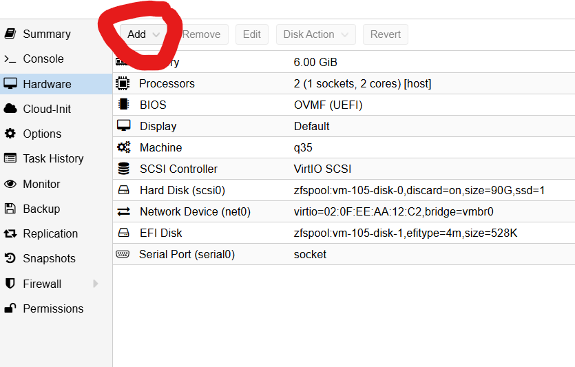

Have you added it to the virtual machine?
Meanwhile the problem is solved.
I’ve found below Internet site and followed it step-by-step.
Proxmox USB Passthrough to Home Assistant VM - SmartHomeScene The USB Vendor/Device ID Method
