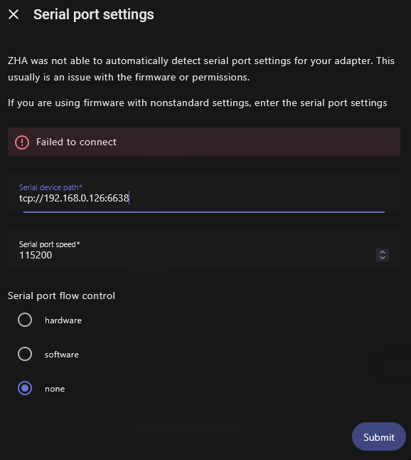

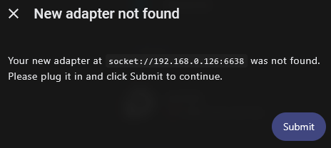

I’m trying to migrate from a Sonoff Dongle Plus to the new Dongle Max. I’ve been following the instructions, but whenever I click the “Add” button in HA, I am greeted with this error:
Configuring manually gives this error:

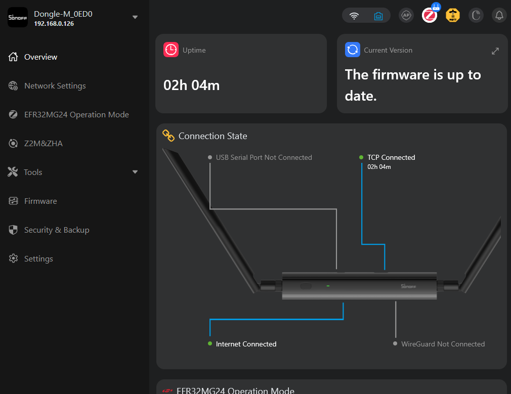

However, the Dongle Max seems to be working fine when I connect to it directly via browser:
What could be the issue here and how would I fix it?
Thanks for your help!!
Looking at your sonoff webgui, something is already connected to it via tcp.
Ahh, that was it. I had it connected to my testing box and hadn’t disconnected it when moving the adapter to my prod box.
