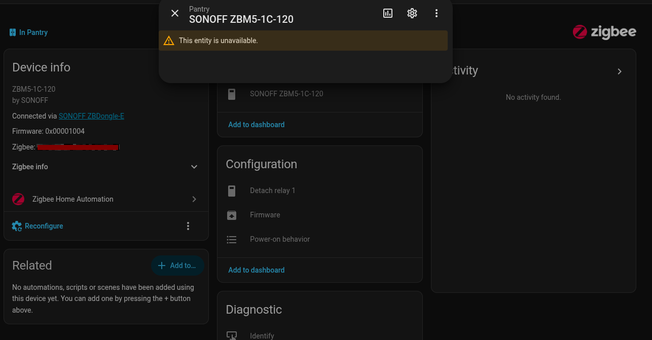

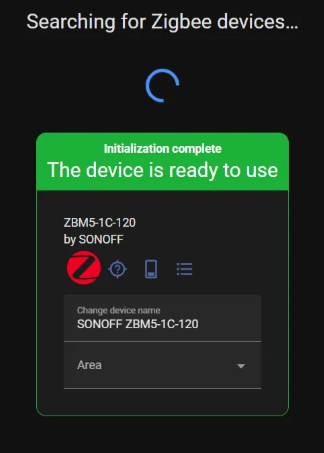

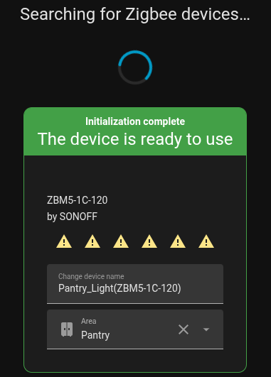

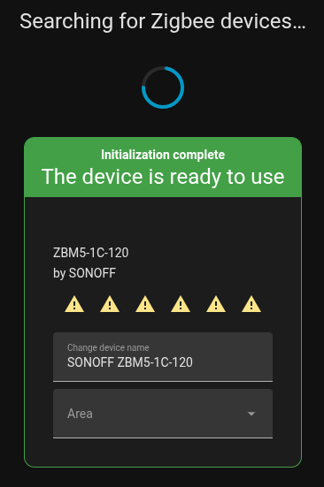

I purchased two of these ZBM5-1C-120 smart wall switches and can get neither of them to work. Initially, I connected the first one to neutral, powered it on and paired it with HA by selecting “Add Device” under Zigbee Home Automation. The switch was detected, however, the usual icons associated with a new device:
did not show up on mine:

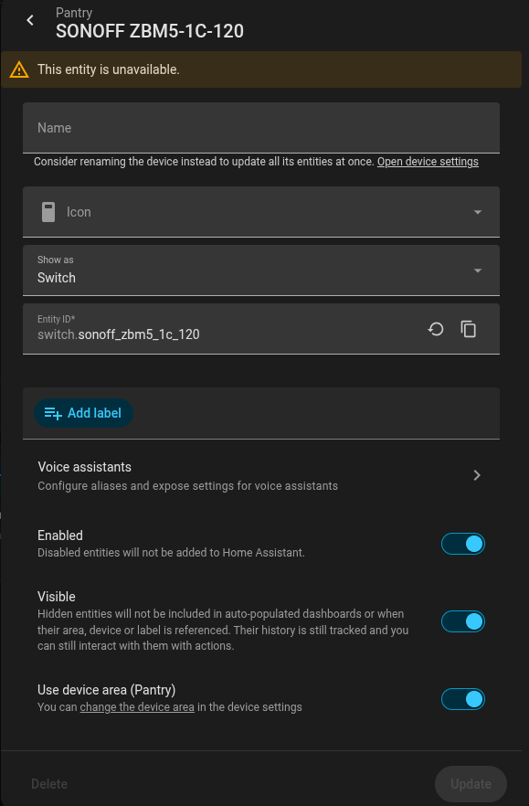

I waited for several minutes and the status did not change. I then went into the device and every entity is unavailable - even though they are enabled.

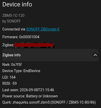

I’ve tried: restarting HA; rebooting the HA host; powered off the device for several minutes and repairing it; tried a second device; removing the neutral wire and pairing again; re-configuring the device, etc. The device is no more than 25 to 30’ away from the Zigbee-E Dongle and RSSI shows -59. Which is fairly decent.

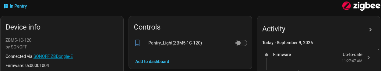

Ok, well. Apparently, I did not wait long enough. After about 1/2 hour, I went back in to HA and found this device working correctly.
I waited another 1/2 hour and found it no longer working. :man_shrugging:
[Note: One thing that concerns me about these switches? There’s no place to attach ground :thinking: ]
And now? It’s working again.

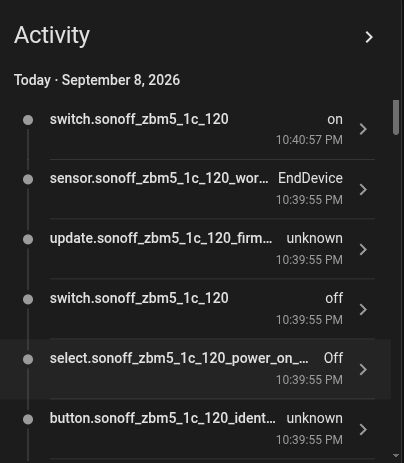

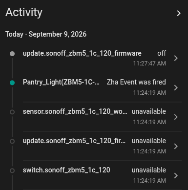

3 minutes later? It’s not working. RSSI is -57. Events are being recorded:

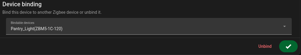

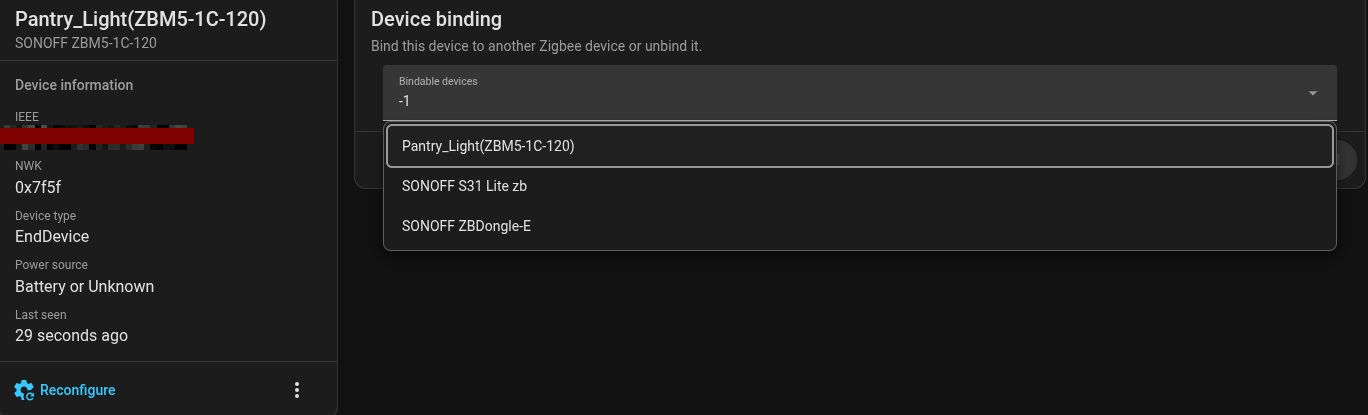

But… No love. I tried binding it to itself. To my S31. But, everytime I go back into bindings? It’s at -1.

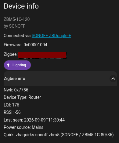

I noticed you initially had neutral connected, but later removed it and re-paired as part of the troubleshooting. If you still have neutral available, I’d probably go back to using it, factory reset/re-pair the switch and see how it behaves then. The ZBM5 operates as a Zigbee router when powered with neutral, whereas in no-neutral mode it operates as an end device. Your screenshot currently shows it as an EndDevice, so that may simply reflect the way it was last paired.
I also checked the firmware because mine are on 1.0.6. Your ZBM5-1C-120 is on 1.0.4, but that appears to be the current firmware for the 120 model, so I don’t think you’re simply missing an OTA update.
On the binding issue, you might find ZHA Bindings Manager useful. It gives a much clearer view of the actual endpoints, clusters and bindings than the standard ZHA binding screen, and may help show what’s happening when you bind it and subsequently see -1:
https://github.com/hsolgaard/zha-bindings-manager
Considering that you’ve tried two switches, have decent RSSI and are still seeing the device alternate between working and unavailable, I’d be interested to see whether going back to neutral mode changes anything. If not, it could point more towards something specific to the 120 model/firmware or its interaction with ZHA rather than a basic mesh signal problem.

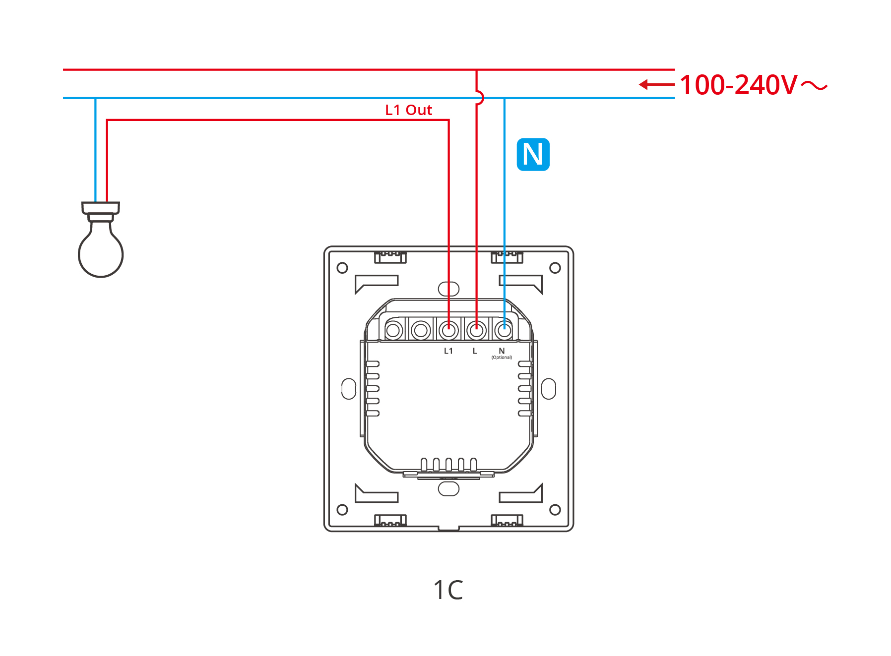

Prior to creating a post here, I did go through the “Help” at Sonoff’s website but it does not appear I am doing anything exotic or experimental and my device is wired exactly as shown:

I performed the steps according to the instructions mentioned above and yet, the devices still comes back showing the “null” icons upon discovery:
It’s now at -56, so the signal appears to be slowly improving? :man_shrugging:

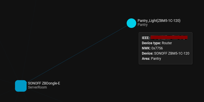

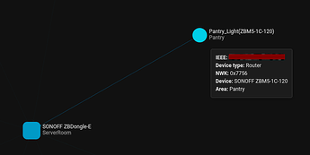

The device finally shows up as a router. I am not going to touch it for an hour and see if it remains in this state or it (as I suspect it will) falls back to “unavailable”
This is a good sign - it’s still “active”. @hsolgaard - you may have been on to something. I’ll keep this post updated.
