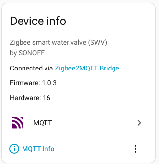

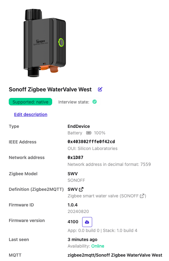

However while the Zigbee2MQTT Dashboard shows the correct firmware levels installed (1.0.4) the device details in the Homeassistant device list still shows 1.0.3.
I am not too deep into Zigbee(2MQTT) but I wonder how/when the firmware levels should get updated in the device details or I need to take manual action on this somewhere!?
Zigbee2MQTT device details:
Hass integration/device details:
Browser cache issue? Try clearing the cache on your browser when you’re on the HA device page. If that doesn’t work, short press the physical button on your SWV to force it to fire a state update to HA.
