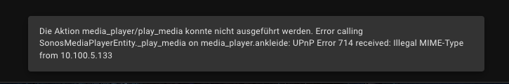

Unfortunately I get this error:
I guess that 10.100.5.133 is the master.
Taleya
December 3, 2025, 1:38am
4
I just tried the same station and got the same error - I even went and double checked radiobrowser.info and we have our answer:
Streaming server info
|Server url|https://live.ecr.co.za/|
|Error|No server info available: ResultDecodeError|
so it’s not you, it’s them. Maybe see if there’s an alternate listing?
