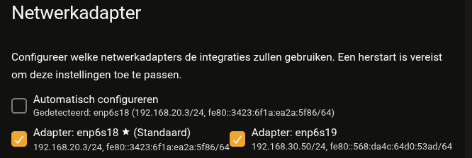

Now HA receives 2 IP addresses. Let HA boot, and in network settings you see 2 adapters. The left one is often the primary one.
If it is the wrong one, scroll down and deselect automatic. From here you can select them manually. Make sure your original VLAN is the standard one.

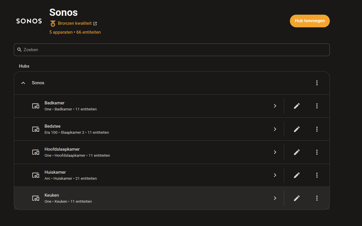

Reboot HA and check if the original VLAN is primary, and the seconday is the sonos VLAN. If it doesn't auto-discover go to intergrations -> Add -> Sonos and it should find your speakers.
