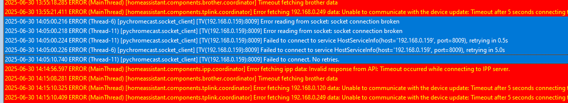

Update- there was an update available for the TV. I ran it but the problem persists. Below is what the error log is showing for the TV, in case it helps.
Check that you don’t have eco mode or some other power save crate enabled that turn off networking
We’re back in business! The thing that seemed to work was rebooting my router and then reloading the integration. Thanks for your help.
