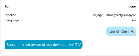

You can see your problem in the log.
Look beter at your image
It is looking for a device called T<> V
If you give it a 2nd alias with T V (with space) then probaly it will work.
You’re right - it works!
