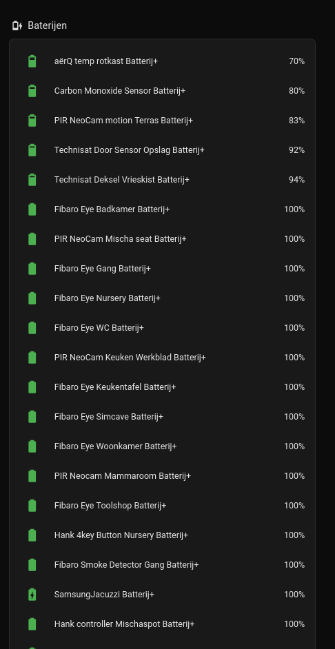

type: custom:auto-entities
show_empty: true
card:
  type: entities
  show_header_toggle: false
  state_color: true
filter:
  include:
    - options: {}
      entity_id: sensor.*battery_plus*
  exclude:
    - options: {}
      entity_id: sensor*body*
sort:
  method: state
  numeric: true
i get this:
without even writing all the battery sensors out piece for piece :wink:
Thanks … it works OK now
