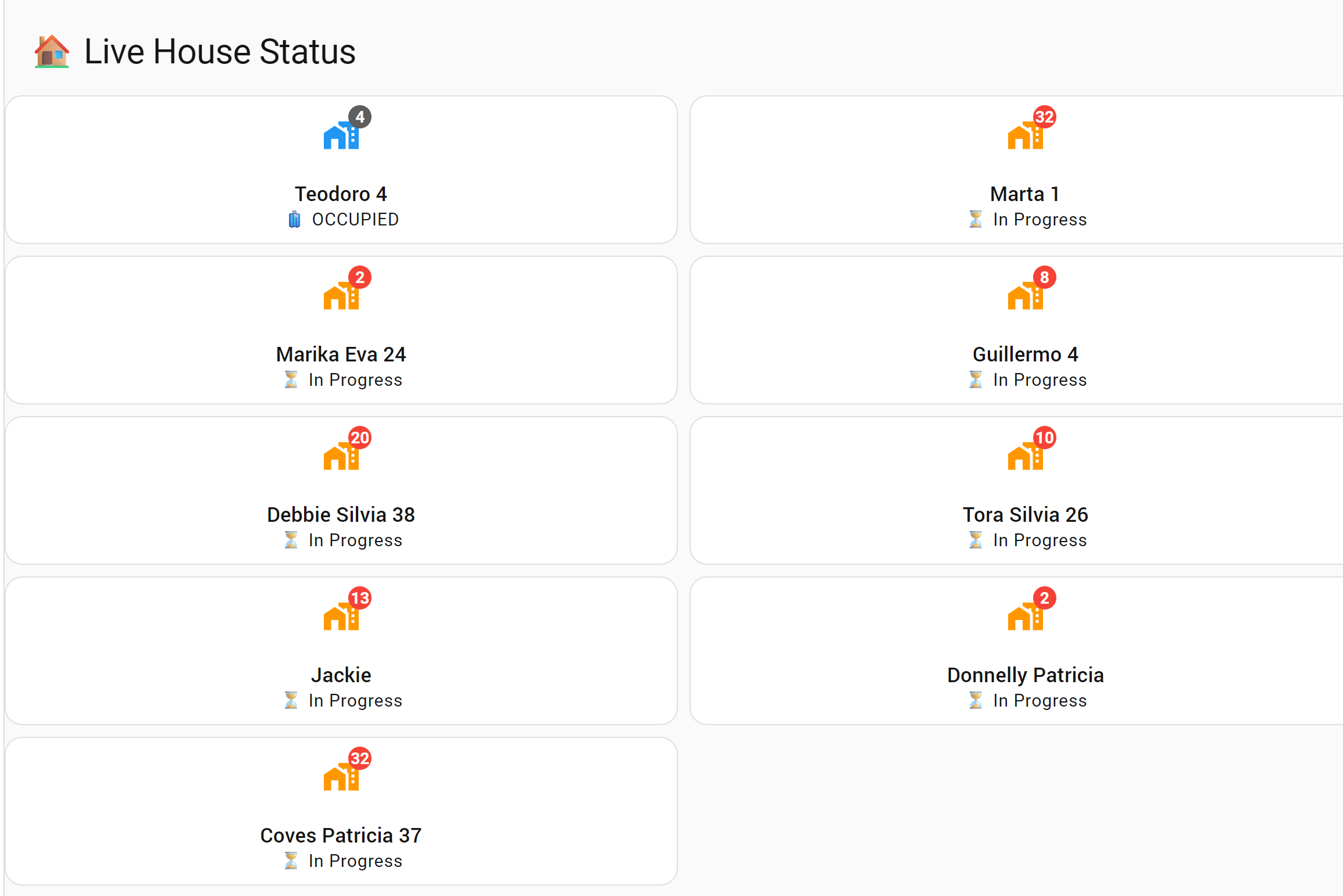

Sorting Mushroom Template Card
Help trying to sort the houses by date of next event in my dashboard.
Can't work it out. "Occupied" houses are essentially "hands-off" for the next few days—they don't require any immediate action from us so I would like them to sink to the bottom.
Also I would like the badge to show the days until next event even if the task is off however I don't know if this will work ....
Any help much appreciated!
