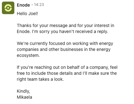

I did send an enquiry to enode.io but haven’t heard back yet. I’m guessing they must support AU given that evlinkha.se is using that service.
Yeah I have, I’ve also reminded them a couple of times.

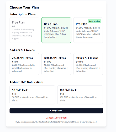

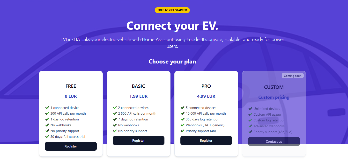

Not sure I’ll continue using it after the paid period though. The pricing when you look to upgrade doesn’t match the advertised price
Advertised
Reality - the $1.99 plan is limited to 10 api calls a day and requires you also purchase token packs
You will find that overall only one account can be logged in at once, even if it’s a separate authorized account. Quite annoying when you have multiple drivers.

Following up on this; I wouldn’t keep my hopes up unless you bring big $$$
