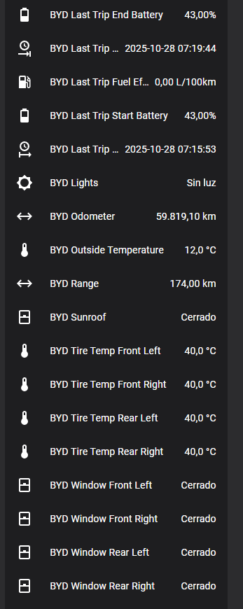

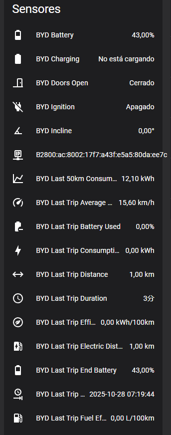

This looks interesting, will try it out. Is there anyway to connect this to home assistant?
Not yet, unfortunately.
Oh wow! Been looking for a way to bring my BYD into HA for 2 years. Can’t believe how easy it was in the end. Thanks.
