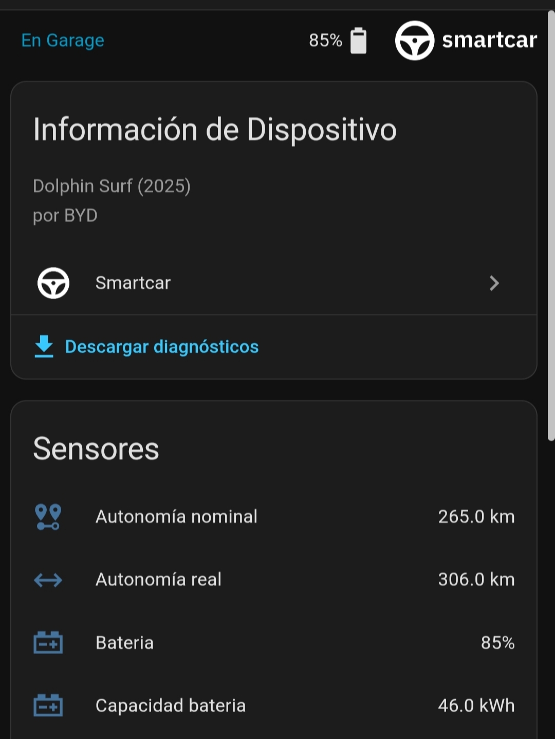

I’m pleased to share that I have successfully integrated my BYD Dolphin Surf sensors into Home Assistant. The best part is that this method doesn’t require any “unofficial” Chinese APKs or unlocking the infotainment system, so the car’s warranty remains intact and the system stays secure.
I used the Smartcar integration, which I recently found via HACS. I must admit, the setup process is quite demanding. If you plan to try this, I recommend sitting down at a computer with a notepad ready, as you’ll need to manage several credentials: Client ID, Client Secret, Team ID, Tokens, Webhook URIs, and the Redirect URI for Home Assistant. It can be a bit frustrating and took me a whole afternoon to get the handshake working correctly.
I opted for the Free Tier (Starter Plan). While it limits the number of available sensors compared to the paid versions, it provides exactly what I was looking for: Battery SoC, Odometer, and Range. For my use case, I didn’t mind losing out on climate control or cabin temperature sensors.
With this data now in Home Assistant, I can finally automate my EV charger. For example automatically stopping the charge at 80% SoC to preserve battery health, or bocking the EV charge if the Solar Forecast integration predicts a low-production day (prioritizing my home battery storage).
In conclusion, it works! I hope BYD eventually releases a more open API so we can access all sensors in real-time without these workarounds, but for now, this is a solid, non-invasive solution.
Attached is a screenshot of my current dashboard.

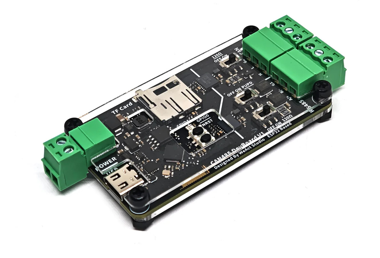

Anyone looking for economical hardware for using ODBCII might be interested in this cheap esp32 dev board with canbus

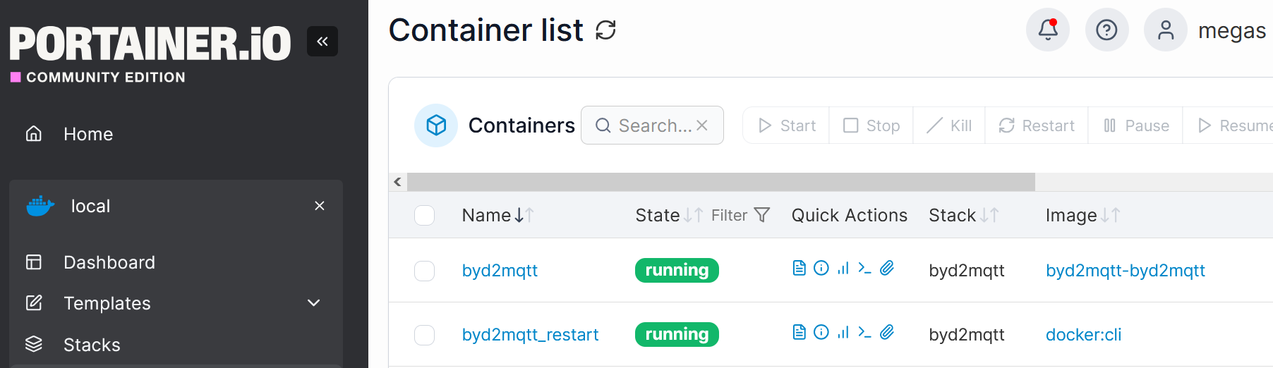

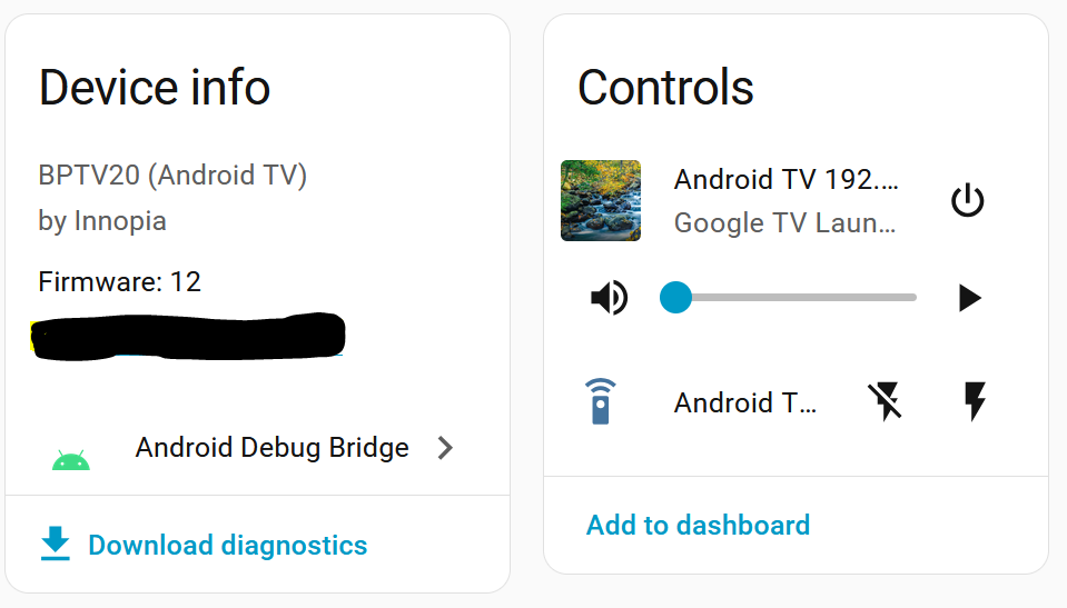

I installed the official byd app on google tv box, that runs without monitor.
Previously I had issue with mobile battery swelling up etc, when i ran it 24x7.
Also mobile needs to wake up, leaving screen on 24x7 causes issues as well.
I created run python script in proxmox docker container.
Adb commands are handled by home assistant via automation.
Need to authorise second email account from main byd app.
Summing up
  1. byd app runs on google tv box - can get used ones for $30-50
  2. home assistant handles adb commands
  3. python script runs on proxmox docker container
  4. sensors = mqtt sensors
If anyone is interested with detailed instructions, please let me know. It will be a very long post.
