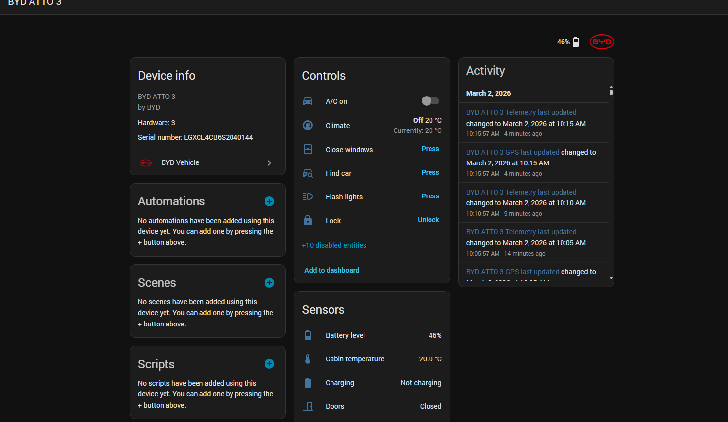

Add the integration as a custom repository in HACS, then you’ll need to sign in to the integration like you would for the app.
However, it is strongly suggested that if you plan to keep using the app - then you should create a separate account and share your car with that account, and use the new account to sign into the integration.
Otherwise your phone app will keep getting kicked out.
Here’s a screenshot of my instance:
