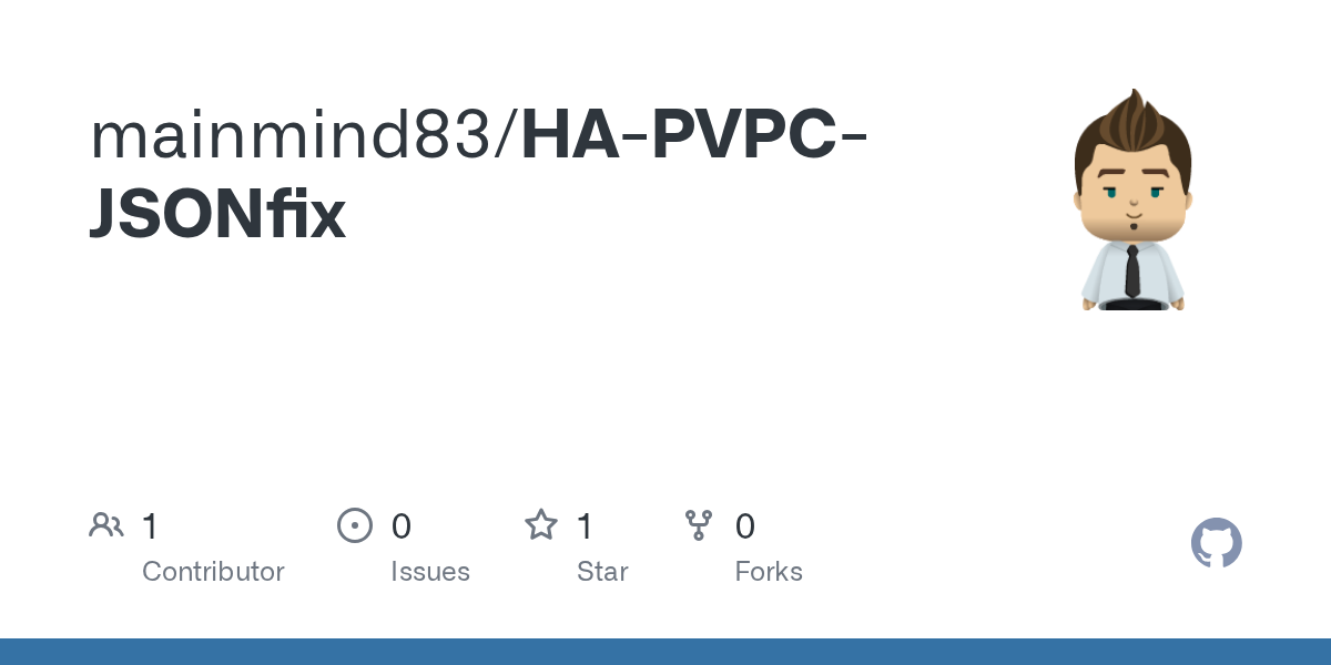

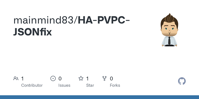

Improved patch: correct P3 holidays via external JSON file
The defaultdict(set) fix described above prevents the crash, but it has a subtle issue that goes unnoticed: for 2026 onwards, national holidays are lost. This means days like May 1st (Labour Day), October 12th (National Day), November 1st (All Saints), December 6th/8th (Constitution/Immaculate), etc. are not recognized as P3 (valley) days — they get billed at P1/P2 rates instead of P3 all day, as Spanish regulation requires.
I’ve published an alternative patch that loads holidays from an editable JSON file (/config/pvpc_festivos_p3.json) instead of leaving them empty:
:white_check_mark: Prevents the KeyError crash (same as the other patch)
:white_check_mark: Correct national P3 holidays for 2026 and 2027
:white_check_mark: Yearly update without touching code — just edit the JSON
:white_check_mark: HACS compatible as a custom repository
Installation
  1. Copy the official integration to custom_components (same method as @Viking described above):
docker cp homeassistant:/usr/src/homeassistant/homeassistant/components/pvpc_hourly_pricing \
  /config/custom_components/
  1. Add as custom repository in HACS:
    • URL: https://github.com/mainmind83/HA-PVPC-JSONfix
    • Category: Integration
  2. Install from HACS (overwrites __init__.py and manifest.json)
  3. Copy the holidays file to your config root:
cp /config/custom_components/pvpc_hourly_pricing/pvpc_festivos_p3.json /config/
  1. Restart HA
Yearly update
Just edit /config/pvpc_festivos_p3.json and add the new year. Out of the 10 national P3 holidays, 9 have fixed dates every year — only Good Friday changes. When the BOE (Spanish Official Gazette) publishes the labour calendar (usually in October), you add one entry and you’re done.
Comparison
Solution Prevents crash Correct holidays Updatable without code
defaultdict(set) :white_check_mark: :x: empty for 2026+ :x:
ha-pvpc-next :white_check_mark: :white_check_mark: :white_check_mark: (full new integration)
HA-PVPC-JSONfix :white_check_mark: :white_check_mark: :white_check_mark: (edit a JSON file)
Repo: GitHub - mainmind83/HA-PVPC-JSONfix · GitHub
I’ve also commented on the core issue (#160084) offering this solution and volunteering as new code owner, since @azogue has been inactive since 2024.
