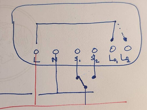

Does anyone know of a smart (Zigbee or matter) relay which can do the following:

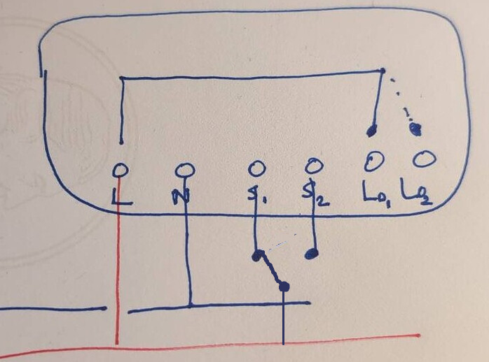

AC or DC? Current and voltage requirements? Battery, mains, or third party powered? For input and output as well as your device. In your diagram, your choice of color implies DC voltages, but your wiring layout is common for AC control.

I’m guessing you need this for an intermediate switch on a 2-3 way switch setup. Technically, you should be able to pull it off with a relay which supports interlock.
I think the Aqara T2 relay will suit your purposes, though you’d either need 2 switches or else hook up a single switch & automate the relays based on the switch state. Image below is taken directly from their product page & shows how you could wire it up with 2 switches. (Nuclear weapons launcher replaced with Roller Shade Motor in picture below :roll_eyes:)
Smart relay with dual output and dual input contacts likely doesn’t work by shorting S1 and S2.
So if you place SPDT switch there, you have SPDT relay.

As for the use, it’s for a mains voltage light, to switch between “PIR” and “always on”. So 230v AC both in and out. Zigbee or matter, I don’t mind as I run both. Controlled by home assistant, hence posting here. The switch is simply a manual toggle.
Shelly 2 can handle that.
Thank you. There seems to be very many Shelly models. Which one are you recommending?
I see that they are mostly Wifi rather than Zigbee or Matter. Is there a model in the Gen4 range (which I think has Zigbee) which would work?
I presume the WiFi models need the use of the Shelly app to set them up? Can they then be used in Home Assistant?
There are many older models and some named like “Shutter” but i think Shelly 2PM is the only one actually manufactured. Gen 4 has Zigbee.
Wifi models work locally via web interface out of the box, you don’t need app, neither HA to set them up.
How do the Wifi modules work - how do they get connected to the Wifi network without being able to enter a password? Are they secure?
You mean smart relays like Shelly? Either you use them in AP mode (often not practical) or you give them your wifi credentials and let them connect to your wifi network.
Are IOT devices generally secure? I personally consider Shelly pretty secure.
Thank you. I’ll get one to test out. Cheers.
You’re welcome
