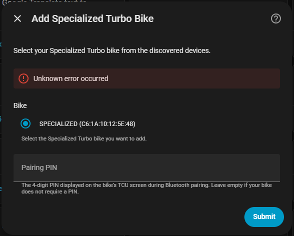

I wanted to try it with my 1gen Turbo Levo (2018). But I immediately get no_devices_found error when trying to add integration (after install via HACS). But I can see the bike advertised as near bluetooth device via HA.
Do you require the name of the bluetooth device to be named “Specialized Turbo”? Not sure if I am reading the code well.

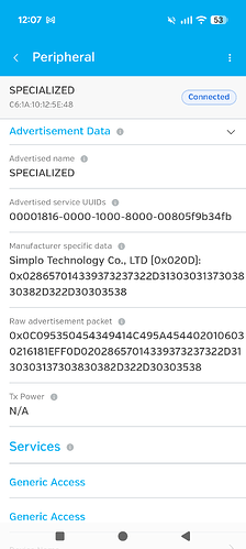

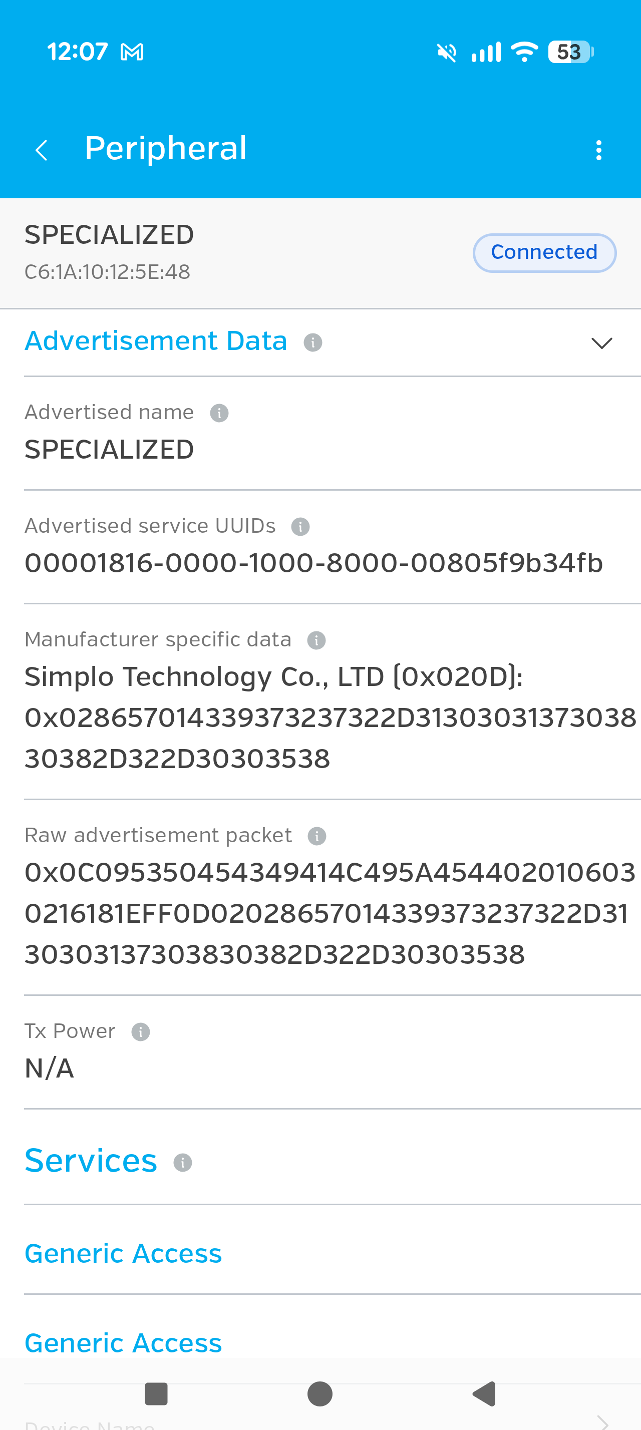

Thanks for trying the integration! Unfortunately your 2018 Gen 1 Levo uses a different BLE protocol than what this integration supports.
The integration looks for bikes advertising with Nordic’s manufacturer ID (0x0059 / 89) and a TURBOHMI magic string in the payload. Your bike advertises with manufacturer ID 525 and the standard Bluetooth Cycling Speed and Cadence service (0x1816), which is a completely different setup.
So it’s not a name check, it’s the underlying BLE protocol that doesn’t match.

Thanks. To my previous post I only copied what HA shows under Bluetooth advertisements - it showed only Bike-cadence service for some reason.
The manufacturer ID is indeed different. But I believe the connectivity should be almost the same as with newer Levo models. There are other advertised services which indeed output full data of the bike. My colleague even implemented this as sensor to our outdoor navigation Android app Locus Map.

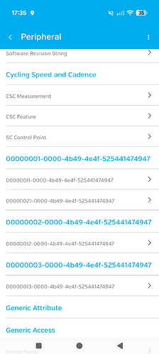

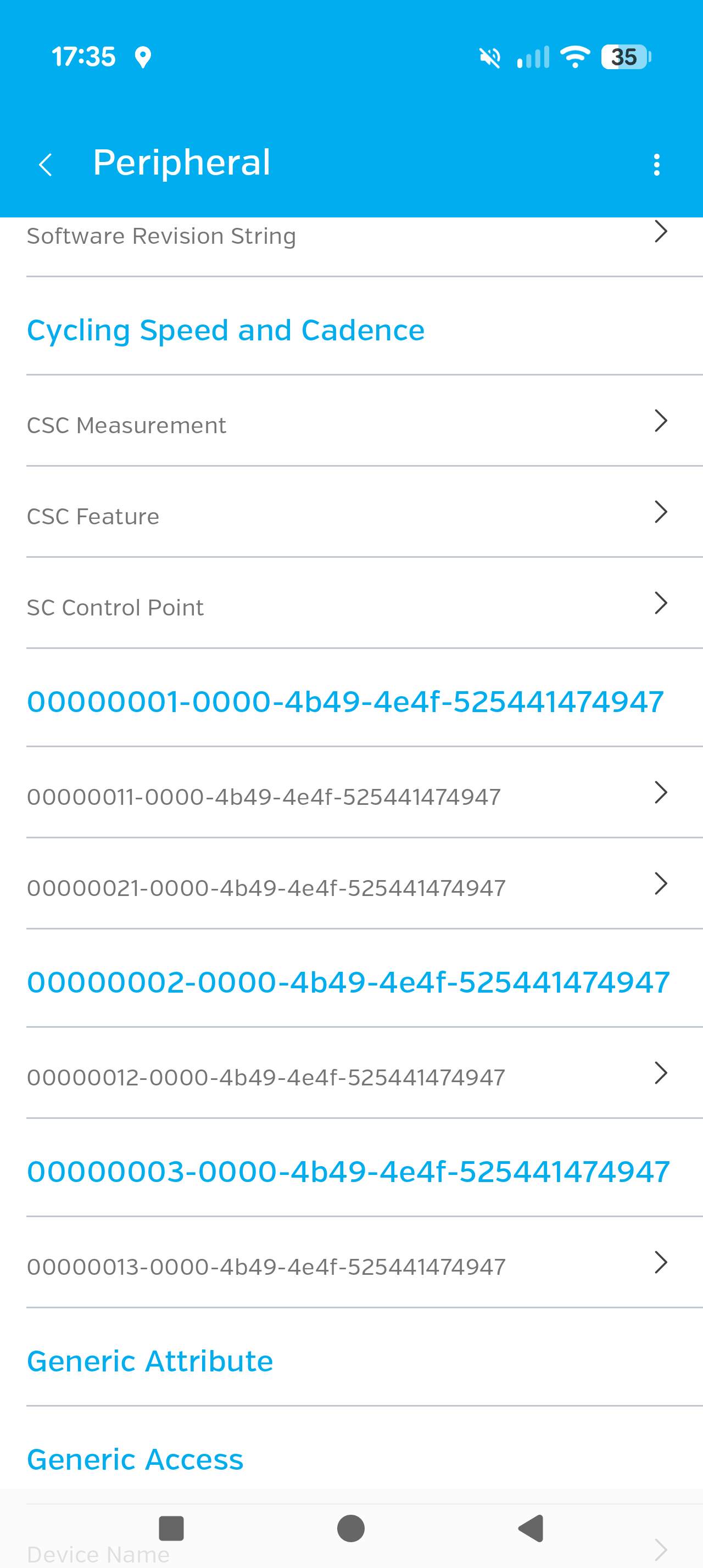

OK, I don’t understand python it seems. :disappointed_relieved: :smiley: Found mentioned manufacturer data in manifest.json, but don’t understand where is definition to which UUID to subscribe…

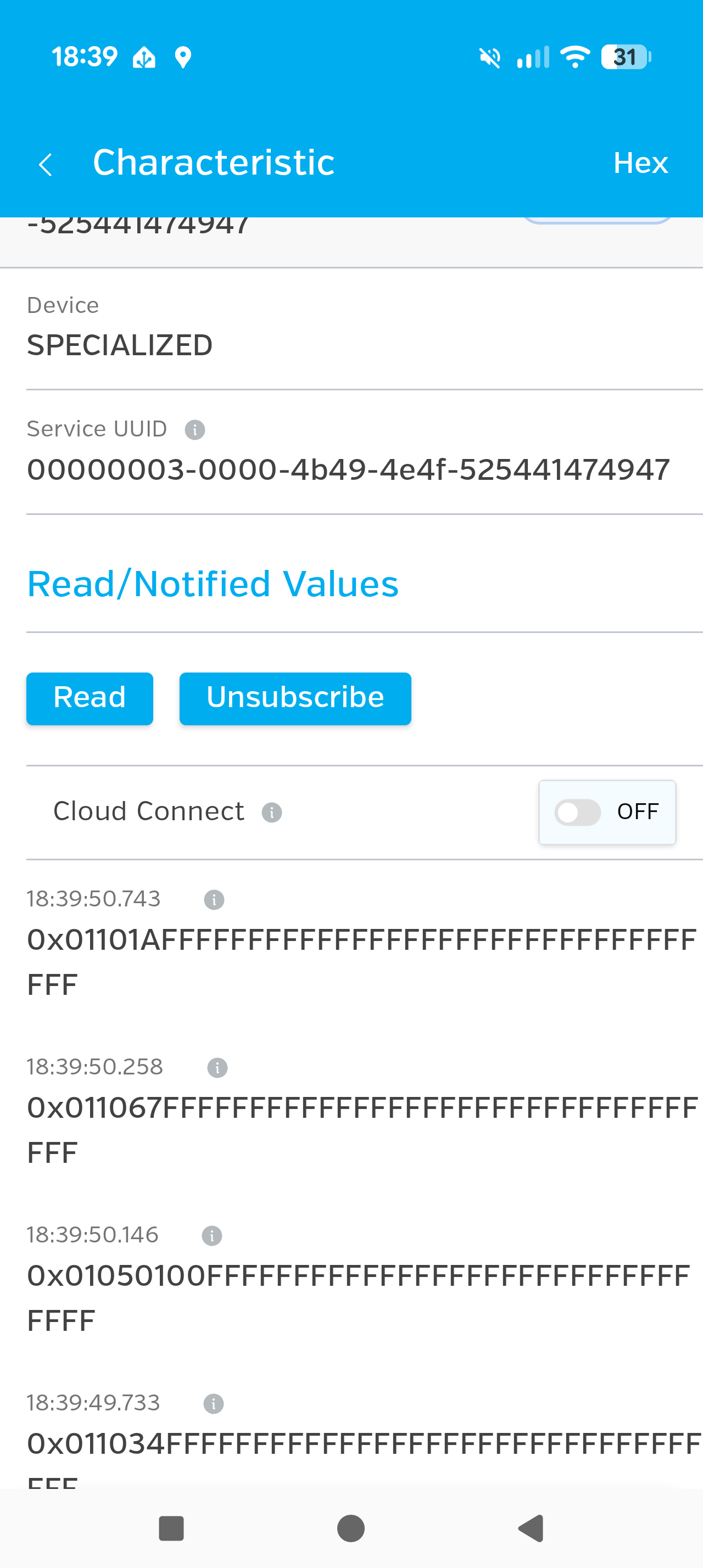

Can you please see from screenshot bellow if the data is same as on newer Levos? If I not mistaken that third payload from 18:38:50.146 contains data about assist mode I selected in that particular moment on stationary bike.
EDIT: Ah, found it. :smiley: I checked your protocol definition and at least battery_charge_percent and assist_level are defined on the “same place” as in my 1Gen Levo. (Don’t know the rest yet.) I also managed to alter _is_specialized_service_info within the code to be able to connect to my bike from HA. Unfortunately it wasn’t enough for integration to run, although Bluetooth stack in HA connected to the bike.
Hey, turns out you were right. The data format is the same between your 2018 Levo and the newer bikes. The only differences are the BLE UUIDs and the manufacturer ID in the advertisement data. Your screenshots confirmed it: the notification payloads on service 00000003-0000-4b49-4e4f-525441474947 use the exact same [sender][channel][data] message format, and fields like battery_charge_percent and assist_level sit at the same sender/channel positions.
I’m adding Gen 1 support to both the underlying library and the HA integration.
The Gen 1 UUID base is 000000xx-0000-4b49-4e4f-525441474947 (encodes “GIGATRONIK” reversed, presumably the TCU manufacturer for that generation). Same short IDs as Gen 2, just a different base.

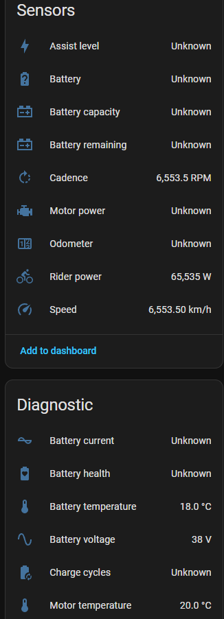

Cool, thanks! Yep, my bike doesn’t need PIN and it connects properly with the version 0.2.1. But it seems like there are some differences in data retrieval after all.
Bellow are all entities which I saw that got populated by some data. Others like battery capacity never have anything other than unknown in my case. For example when connected for the first time (until reconnect) I saw only values for both temperatures entities, nothing else.
And of course as it is visible on screen, even sensors which are showing values are wrong. Those temperatures and voltage entities are valid though. You can see that assist level payload on screen from LightBlue above, so let me please know what can I check on my side.
BTW, is there some way to easily disconnect or reconnect bike via HA? (for example when I want to free bike BT connection for other app) I only managed to do it by disabling whole integration and then setup it again.
Thanks for testing this out! The bogus values you’re seeing (cadence, speed, rider power) are almost certainly 0xFF padding bytes being read as real data. Your Gen 1 bike pads notifications to 20 bytes with 0xFF, and the parser doesn’t know to ignore those yet. I’ve got a fix ready but want to confirm a couple things first.
