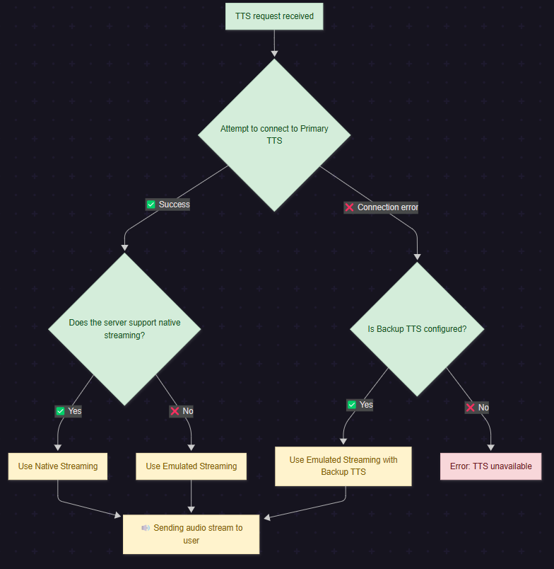

I tried to reflect the work with different satellite versions in the diagrams; there are some inaccuracies, but the idea should be clear.

Another question: after Home Assistant, Wyoming, Piper, etc. implementing support for streaming, what will be the use case for your solution? Proxy to allow streaming with other TTS solutions that still don’t support the feature?
I will use it because of the backup server functionality.
