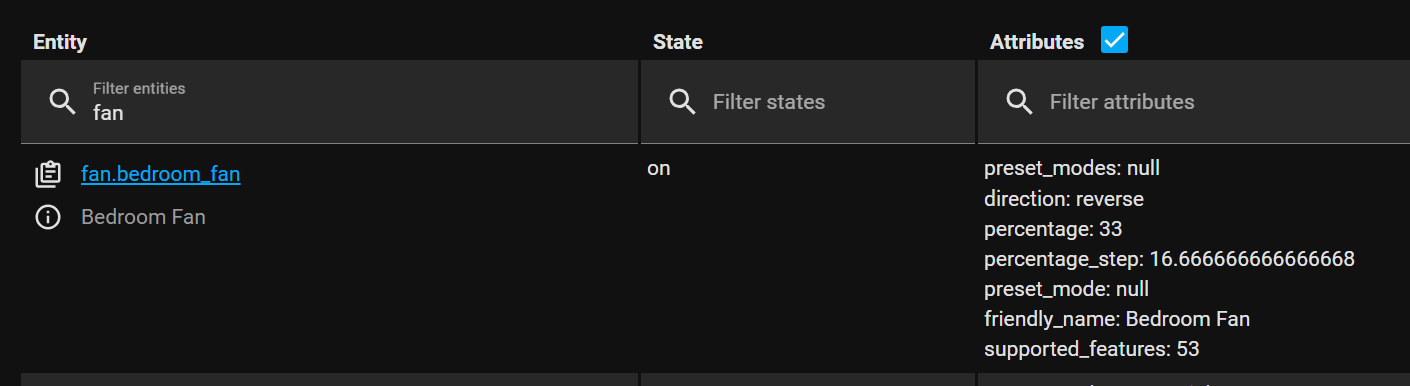

It all depends on what info your fan is providing. Can you post what the state data is from developer tools?
There are so many way to accomplish this( variables, templates, etc…)
This basic method may provide some insight on how to access the attributes

The code can be paired down a bit, but I wanted to make it as clear as possible for you.
Please provide the source of the picture.
Thanks for the code. I added in your code as a custom button and it only gave me on/off. I had similar working with the custom button code.
