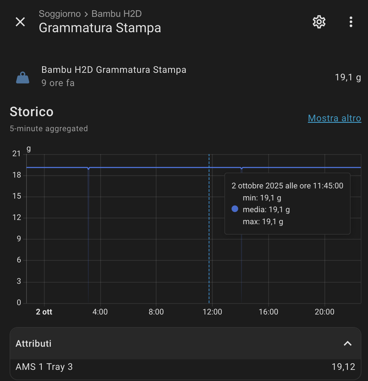

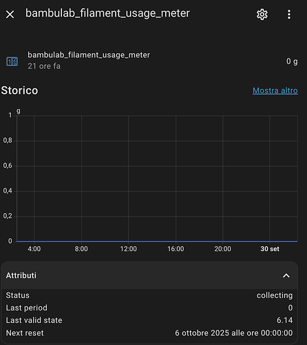

I also have to say that filament_usage_meter is always to zero, it collects data but always to zero.
Hi, please recheck all the variables in the sensors and automations. I had the same issue and I missed one entity with wrong name that caused this.

Apologies for the late response, I didn’t receive any notification.
That the weight is always zero, could be correct as you sensors, tray index and so on, are all incorrect or did you rename your Bambu within Home Assistant to bambu_h2d?
If you fully renamed your printer to bambu_h2d, I will do a full check what you put in here.
If you did not change the name, you need to check your sensor as normally the printer comes into Home Assistant somehing like this: H2D_RANDOM BUNCH OF NUMBERS (H2D_3789719874387264)
where I have to check? only in automations? or in configuration?
I renamed to bambu_h2d
If you renamed it in HA to bambu_h2d, than it is ok. You say it fails on: {{ trigger.to_state.state | int }} ? Can you check if you have set your helper the correct way?
Seeing that you have set your HA not to English, please check if your sensor attributes are in English or not.
For example: sensor.bambu_h2d_grammatura_stampa does this have the attribute unknown and unavailable or is it set to your language in HA?
it has always a value… in history
I beginning to think that the H2D isn’t acting the same as the H2S. The difference between the P1S and H2S is that the active tray was cleared before the current stage for printing was set to finished. Hence, I needed to re-write this script.
With the script for the H2S, as also stated on Git, it most likely will also work for the H2D, as the H2S is his little brother.
But seeing your problem, trigger.to_state.state | int is not being filled and is returning empty, I suspect that might be the problem. As I don’t have the H2D, I am not able to test it.
Can you please try the steps stated on Git that is used for the P1S? Let me know if this solves the issue, then I can also make the adjusted on Git.
