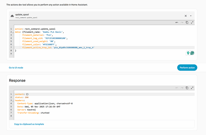

If I check the sensors via developer tools, everything seems correct, I also tried a manual (via Actions) rest_command
That manual update went through and updated my inventory
my print that finished three hours later was not updated, but my canceled print this morning was updated.

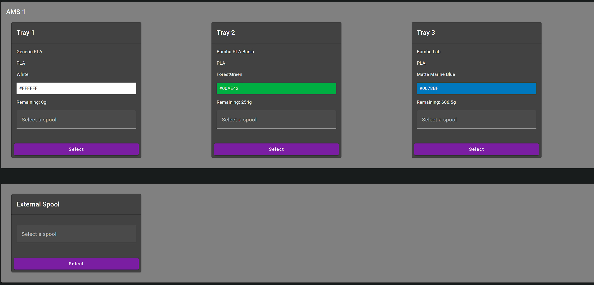

And I am curios about the website… where I should be able to select spools…
If i call the URL http://192.168.3.78:8088/Spools … it shows me a JSON of all my spools, if I call the swagger-page => it shows me the API-docs…

I was able to solve my own problems myself => which in the end was quite simple…
Docker containers, in their default configuration, do not perform DNS resolution or use their own DNS (if no DNS is provided via the Docker network).
Therefore,
-e APPLICATION__HOMEASSISTANT__URL=http://homeassistant.local:8123
cannot be resolved, no connection to HomeAssistant is established, and the available spools/trays/sensors cannot be retrieved.
After I entered the IP address there and restarted the container, I was able to see the website correctly and am now able to select my spools…

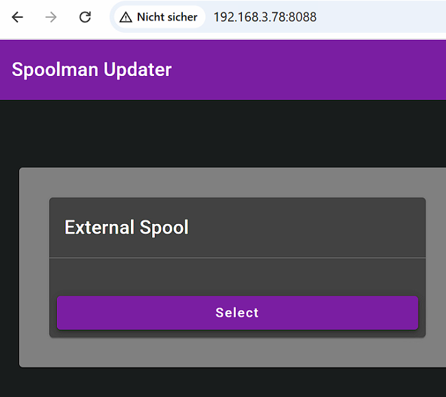

It seems to work for the AMS trays… but if I am using the external spool => I am selecting the correct spool on the Spool-Updater website, but it won’t save it… after an F5-refresh, the selected spool is gone…
Any idea?

That happens on my end also, did you check Spoolman if the active tray is updated? If so, then it is just the same as I have, a visual problem.
Unfortunately, it is not updating the usage/weight of the external spool. Yesterday I finished three prints from the external spool, but no changes in Spoolman.
That could be correct as the external spool behaves differently. I wrote an automation a while ago for that but not tested as I don’t use the external spool.

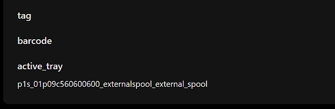

No, I mean if you set the external spool in Spoolman updater, does it update your Spoolman? If you go to Spoolman, select the spool that you set as the external spool in Spoolman updater, is the active tray field filled in?
So this is part of your remark that selecting the external spool in the updater isn’t visible.
Now I know what you mean… never have seen that field before (ok, using spoolman for abount a week now :wink: )
Yes, it is set and it changes if I am selecting another spool for the external spool. So that seems to work perfect.

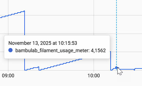

From my latest trace:
Tray 3 is correct, ColorCode White is correct, Filament is correct… even if the weight was low (3.9g) for that color-change => it is not zero.
The usage_meter shows the correct amount (with purge?)
