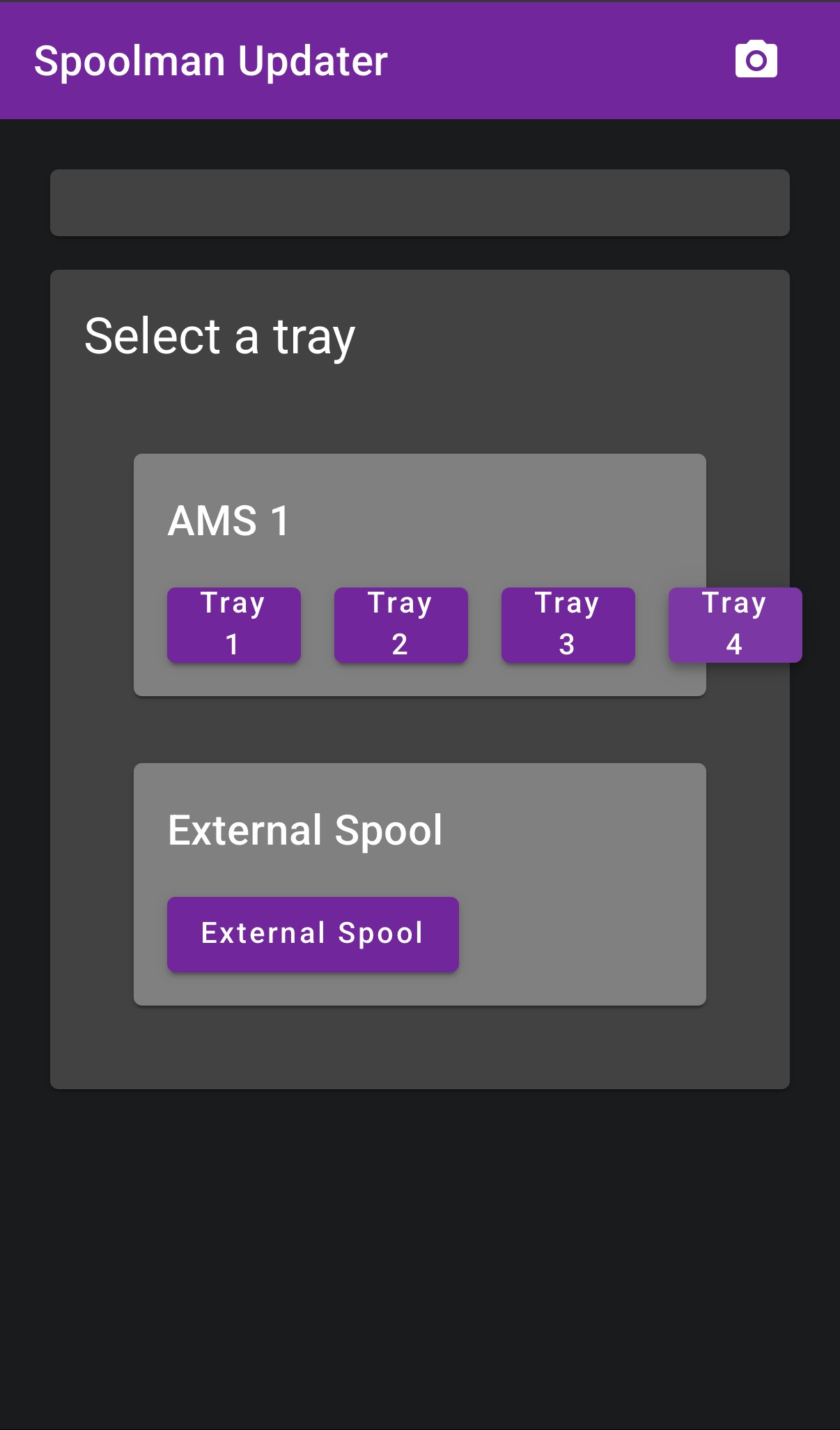

Does anyone here use the QR code scanning feature in Spoolman Updater? Is it currently working, or is there a bug?
When I go to “Show label” for a spool in Spoolman and scan the QR code with my phone in Spoolman Updater, the following page opens:
However, when I click something there, the active_tray variable for that spool is not updated. If I assign a spool to a tray directly in the GUI, the variable is set without any issues.
I’m running Spoolman Updater behind an NPM reverse proxy; without it, the scanning feature doesn’t work in the browser at all for security reasons.

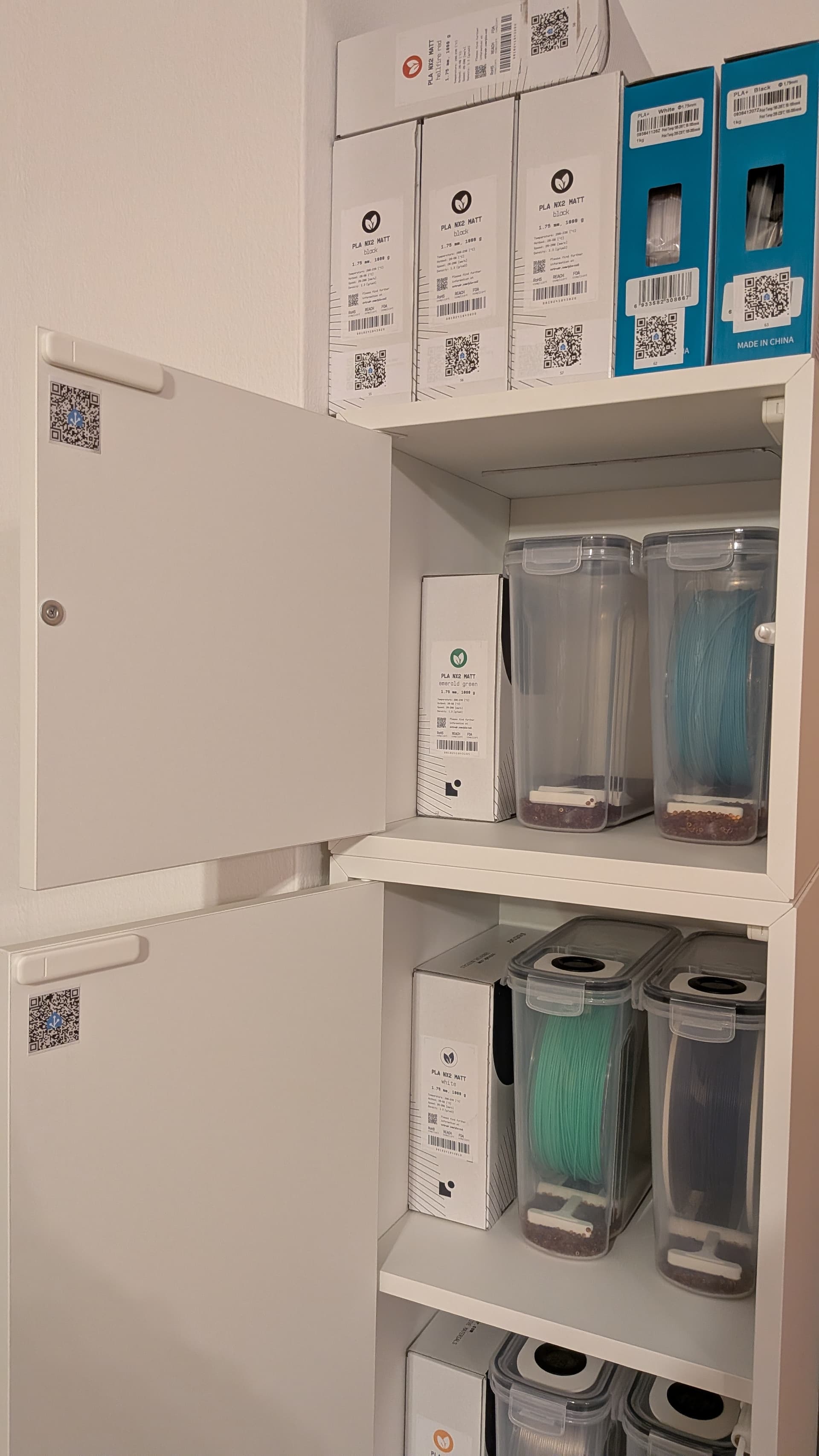

Hi everyone,
I wanted to share a small proof of concept I’ve been working on around Spoolman Updater and Home Assistant.
I uploaded a short YouTube video where I demonstrate how I assign filament spools to locations (and AMS trays) by simply scanning QR codes. The automation updates the spool location in Spoolman and Spoolman Updater automatically. For example assigning a spool directly to a specific AMS slot on my Bambu Lab printer.
This is just a PoC, but it already works quite reliably in my setup.
If there is interest from the community, I’m happy to share the Home Assistant automation and configuration I’m using. I’d also very much welcome feedback or improvements from others - especially since the current version does not yet support external spools, mainly because I don’t use them very often myself.
Thanks for building and maintaining Spoolman Updater!
It made experiments like this much easier
Nice to make use of HA scanning ability :slight_smile:
Although I am a bit confused about the use case. As you need to go to HA to scan the QR code en then scan the code for the tray, right? Is this faster then select the spool in the updater?
Hey @Lucrezia,
yes, scanning QR codes is much faster for me than manually setting the spool location in Spoolman. I do use Spoolman’s built-in scanning feature at another building, but at home I’m sticking with my own solution.

Does each spool has it’s own QR code or something? Can’t seem to find that out in the video.
Yes, each spool has it’s own QR code, but you could also use NFC tags instead.
On the inside of the doors, you can see my QR codes for the locations. The QR codes for the spools themselves are attached directly to the spool and also to the package (if it still exists).
I just noticed this now …
No, you can just scan the QR code with your camera app and that’s it. No need to open Home Assistant for that.
The tag contains a link like https://www.home-assistant.io/tag/web+spoolman:s:32.
The Home Assistant companion app will recognize and handle it automatically! :ok_hand:

hello how to get this ui?
@platini76 I opened a separate topic for this in the forum, have a look here:
