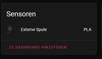

Is AMS Lite supported?.
In GUI i can only see the external spool but doesnt the AMS
It should work. Whats are the entity ids that the integration provides for the 4 trays/spool holders?
For AMS only:
For External:
I meant like sensor.x1c_xxxxxx, Those are the friendly names. If you click on one and go to the gear icon it will tell you the entity id
sensor.a1_ams_slot_1
sensor.a1_ams_slot_2
sensor.a1_ams_slot_3
sensor.a1_ams_slot_4
sensor.a1_externalspool
sensor.a1_aktiver_slot
sensor.a1_aktiver_slotindex
Thnx, can you try the latest version?
I can’t get it to work even with the latest version.

I’ve already tried all possible variations for APPLICATION__HOMEASSISTANT__AMSENTITIES:, but the AMS does not show up in the GUI.
The external spool is displayed, but I can’t select anything from the dropdown.
Could there be something wrong in the automation?
