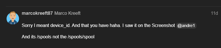

So i just tried the automation and everytime i get the following error.
 Error. Url: http://10.150.175.10:8088/Spools/spool. Status code 404. Payload: b'{\n "name": "",\n "material": "",\n "tag_uid": "",\n "used_weight": ,\n "color": "",\n "active_tray_id": "a1_03919d510504942_active_tray_3"\n}'
and
Template variable warning: 'name' is undefined when rendering '{ "name": "{{ name }}", "material": "{{ material }}", "tag_uid": "{{ tag_uid }}", "used_weight": {{ used_weight }}, "color": "{{ color }}", "active_tray_id": "{{ filament_active_tray_id }}" }'
Template variable warning: 'material' is undefined when rendering '{ "name": "{{ name }}", "material": "{{ material }}", "tag_uid": "{{ tag_uid }}", "used_weight": {{ used_weight }}, "color": "{{ color }}", "active_tray_id": "{{ filament_active_tray_id }}" }'
Template variable warning: 'tag_uid' is undefined when rendering '{ "name": "{{ name }}", "material": "{{ material }}", "tag_uid": "{{ tag_uid }}", "used_weight": {{ used_weight }}, "color": "{{ color }}", "active_tray_id": "{{ filament_active_tray_id }}" }'
Template variable warning: 'used_weight' is undefined when rendering '{ "name": "{{ name }}", "material": "{{ material }}", "tag_uid": "{{ tag_uid }}", "used_weight": {{ used_weight }}, "color": "{{ color }}", "active_tray_id": "{{ filament_active_tray_id }}" }'
Template variable warning: 'color' is undefined when rendering '{ "name": "{{ name }}", "material": "{{ material }}", "tag_uid": "{{ tag_uid }}", "used_weight": {{ used_weight }}, "color": "{{ color }}", "active_tray_id": "{{ filament_active_tray_id }}" }'
I just changed the sensors to match my printer.

How does your rest command look?
Accidentally sent the Automation twice. :smiley:
The “Spoolman-Updater” Part of my Config.yaml

Wow, this was apparently never updated in the readme. The rest command must be:
rest_command:
  update_spool:
    url: "http://<your-server>:8088/Spools/spool"
    method: POST
    headers:
      Content-Type: "application/json"
    payload: >
        "name": "{{ filament_name }}",
        "material": "{{ filament_material }}",
        "tag_uid": "{{ filament_tag_uid }}",
        "used_weight": {{ filament_used_weight | int }},
        "color": "{{ filament_color }}",
