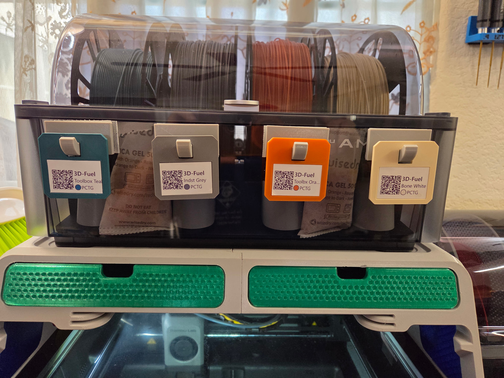

Ok so I got a weird question for you, I have a 9 shelves that are connected to an ESP32, each shelve slot is made to connect to a box that are interchangeable, it's a filament drying system. your system is awesome and especialy yuor QR codes! I would love to be able to add manual "trays" that I could assign slots 1 thru 9 to track which filaments are in which shelve slot. is this possble?

  1. Make sure you use the local instance of home assistant when making QR codes.
  2. It would be very nice to create virtual ams to choose when putting filaments in a dryer for storage for example.
Is it possible to set up virtual printer, ams for storage in dry boxes and storage for complete QR code control. Thx
When I created the QR codes, I had to be logged into ha on the local level or the QR code would not work correctly.

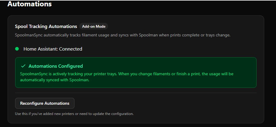

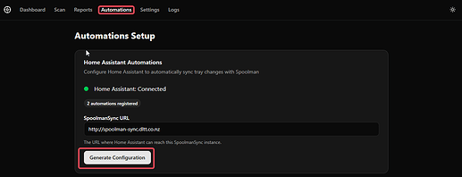

Have you added the Automations (configurations) from SpoolMan-Sync to Home Assistant ?
Yes, automations seems to be OK. But my printer is IDEX, so I’m wondering if SpoolmanSync is designed for that… I can see the spool changes in the logs, but nothing after that.
