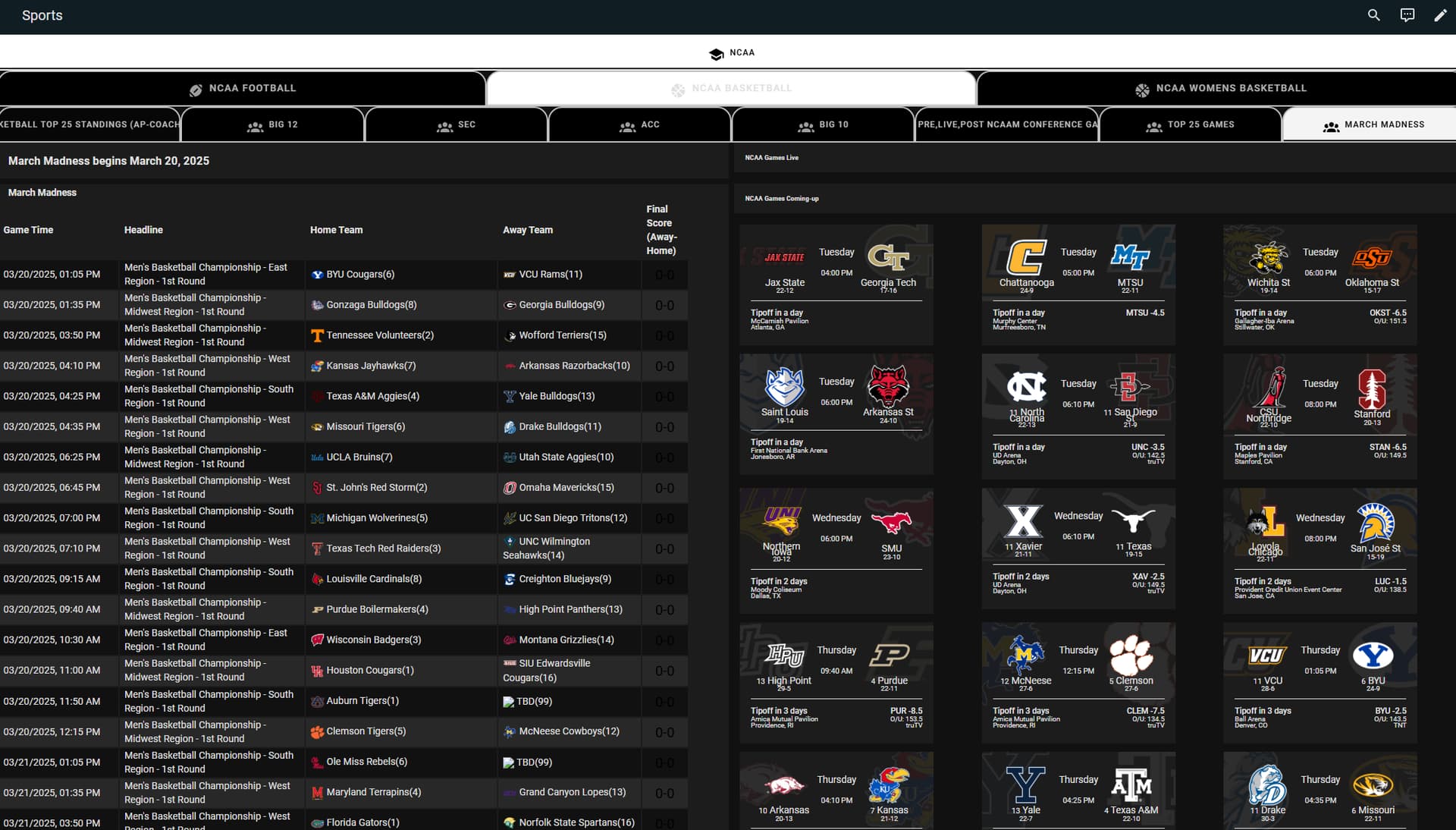

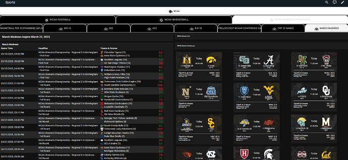

Maybe someone has moved this down the road (would love to see what you have) but if not I just started playing around with it. Feel free to use. Teams haven’t been selected so just creating a shell right now. Once they are announced I’ll be able to add Names/Logos/venue/etc.
Layout is my typical layout of everything on a single screen. Games are current but when MM starts you will see them there.
I built my March Madness tab using the api that was mentioned in the thread here - https://gist.github.com/akeaswaran/b48b02f1c94f873c6655e7129910fc3b
For those that want it - I have updated my github sensors, NCAA College dashboard and started to add a Women’s College Basketball - sensors only right now - for what I am showing below.
Here is the rough shell but you can see ESPN lays out the games through the Championship.
For those that just want the sensor here is what I am currently using:

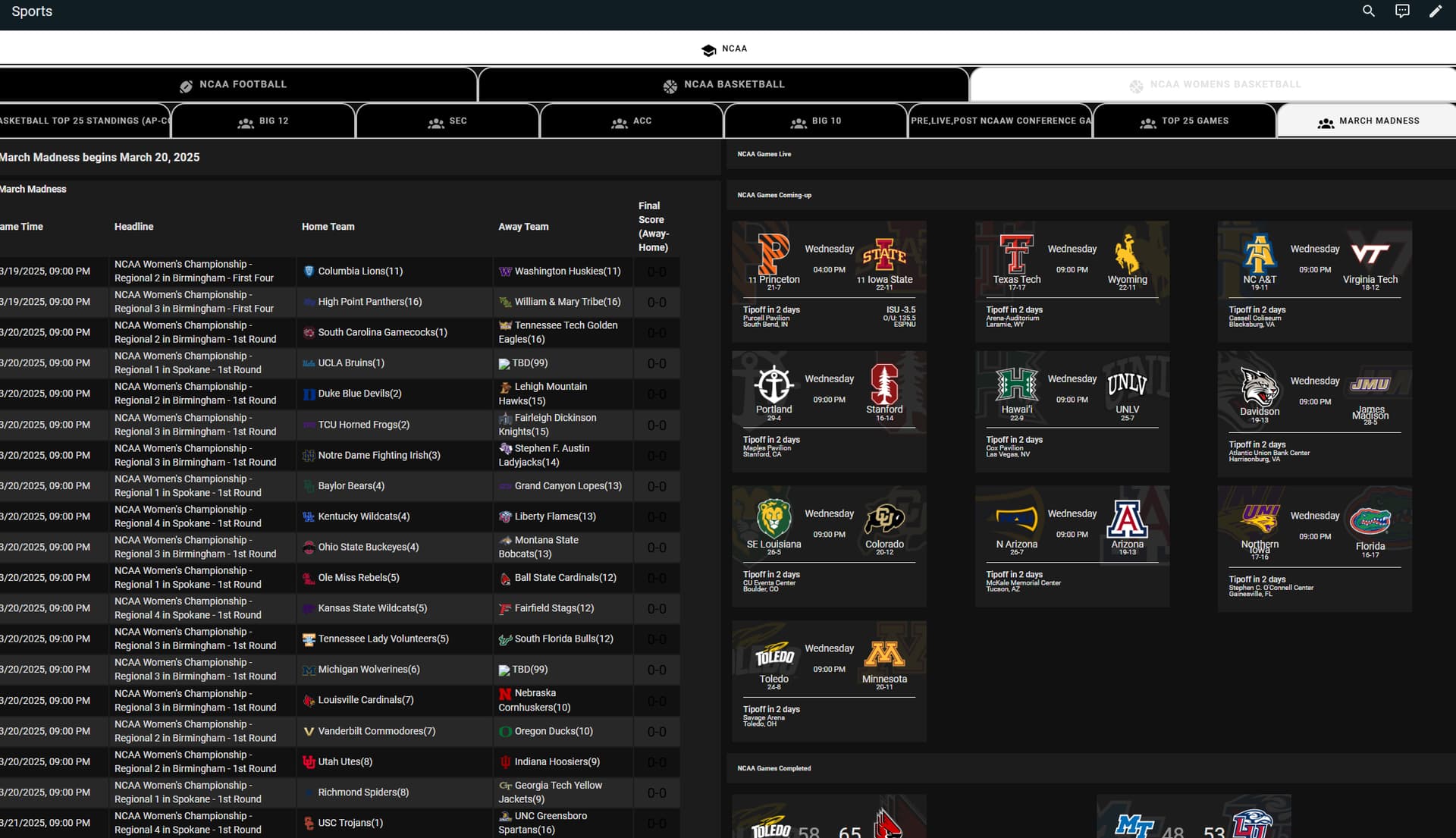

March Madness Men’s and Women’s selection was done today. Just a couple notes:
  • I tried to quickly make adjustments but I won’t be able to get back to this until next weekend. So any help or adjustments are appreciated.
  • I have updated my github for Men’s Basketball and Women’s BB. It’s rough right now but hopefully it will get cleand up.
  • I added an -odds section to the rest sensor because I was thinking about adding that in to the screen at some point. ESPN does provide Odds/Spread/etc…
  • I don’t like the formatting or the way sorting is done but I will work on that later.

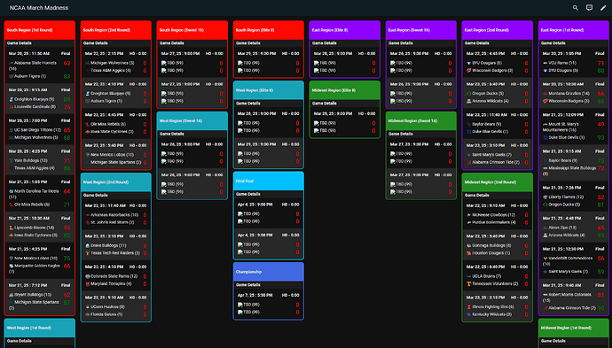

Here are a couple screen shots. Can’t wait to see what you all add/fix/improve

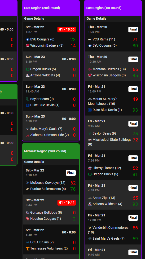

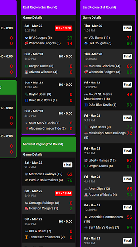

Just tried to make a couple improvements and was working to see if I could create a bracket.
I am having alignment issues/sorting challenges with it, but I figured I would put the code out there if anyone wants it. I have only focused on the Men’s bracket but the basic decluttering template works for Women’s as well.
Here are some of the changes:
  • Reformatted the basic layout to show teams with Away over Home to better show the scores. Code is updated in the Sports_US_College_NCAA dashboard on GitHub. Here is an example showing the womens MM.
  • Created a separate sandbox for MM bracket building.
    – To build the bracket I am keying off .notes.headline and filtering based on what it is saying. 1st Four/1st Round/2nd Round/Sweet 16/Elite 8/Final Four/Championship.
    – I am using a template to filter. For those that know me, I would rather use REST but ESPN doesn’t break it out easily that way. To keep things clean I put this in a separate file in my GitHub site - under templates :wink:
    – The Dashboard for the sandbox also has a separate file. I haven’t tabbed it yet but that is pretty straightforward to add.
    – I need to do the same thing for Women’s MM but their brackets require different regions (which honestly doesn’t make sense) - Region 1/2/3/4 - so not a simple cut & paste.
    – I don’t have TT in the sandbox - just became to cluttered.
    – Before you ask - yes you can change the colors. It a variable that is called color. These colors just helped me lay the bracket out to see how it works. You can see the format here - just change it.

– Here is where I am currently with the Sandbox bracket building.

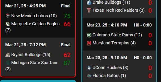

– Last point is that I have also add Game state at the top of each game in the sandbox - Games haven’t started today but you can see below the New Mexico Game Score is Final and Colorado State Starts tomorrow at 4:10 and the half/time will be reflected on the right as well as the current score. To get this I needed to update the scan interval - I picked 90 but you can adjust.

UPDATE: Just a quick update on MM dashboard. Just some highlighting to easier find games -
  • games playing have a red background with time (remember I am only updating every 3 minutes)
  • Final - White background

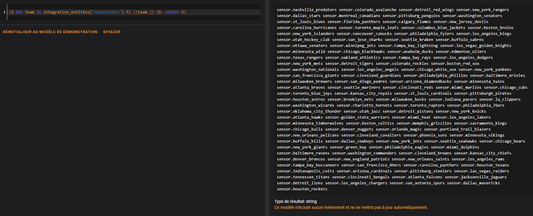

First thing to check is if you have the TeamTracker entities getting loaded. Go into Developer Tools → Template and put this in there - Is anything in result?
{% for team in integration_entities("teamtracker") %} {{team }} {%- endfor %}

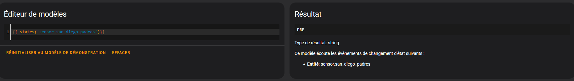

Thanks here is what I get

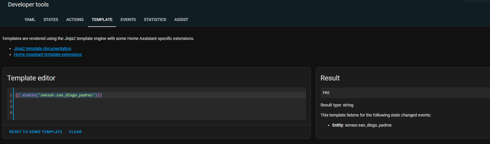

Ok if you put this in what do you get:

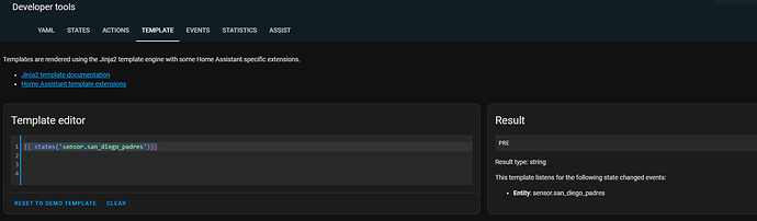

{{ states('sensor.san_diego_padres')}}

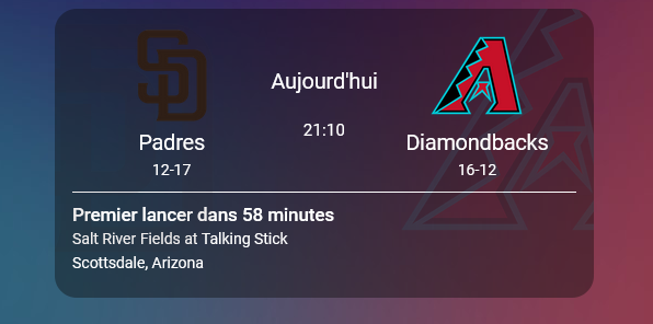

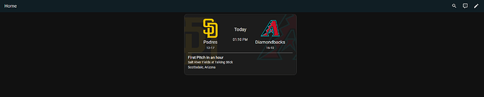

Here is what I am showing right now:
Here is what I get:
Ok so it looks like you have Teamtracker setup and the sensors are being populated.
Now you can check and see if there is something wrong with your dashboard.

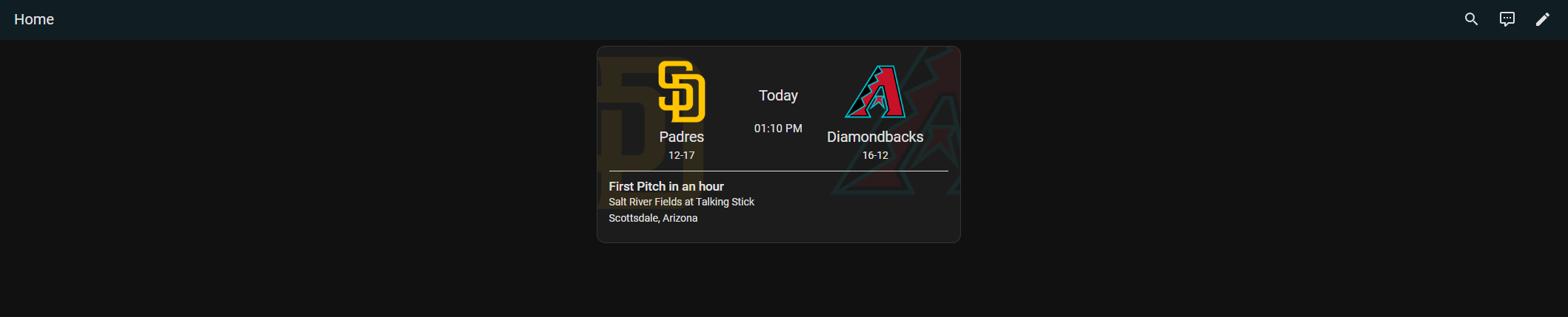

Create a new, blank dashboad and then go edit the yaml configuration.
Put this in there:
views:
  - title: Home
    cards:
      - type: custom:teamtracker-card
        entity: sensor.san_diego_padres
        outline: true
        outline_color: deeppink
You should see this:
I saw it:
Ok then it looks like there is something in the pre/in/post tabs config because everything seems to be working.

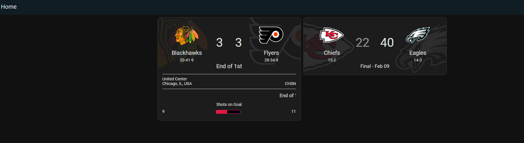

What kbrown and I are saying is that it may be the red zone piece of game_stats.
We are trying to figure out what is causing the error and it may be that the NFL sensors aren’t loaded on your system.
Put this in your test dashboard:
views:
  - title: Home
    cards:
        entity: sensor.chicago_blackhawks
        outline: true
        entity: sensor.kansas_city_chiefs
        outline: true

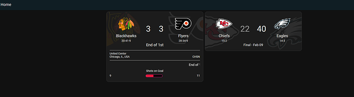

Should see this:
Edit: lets use Chiefs
I see that well
