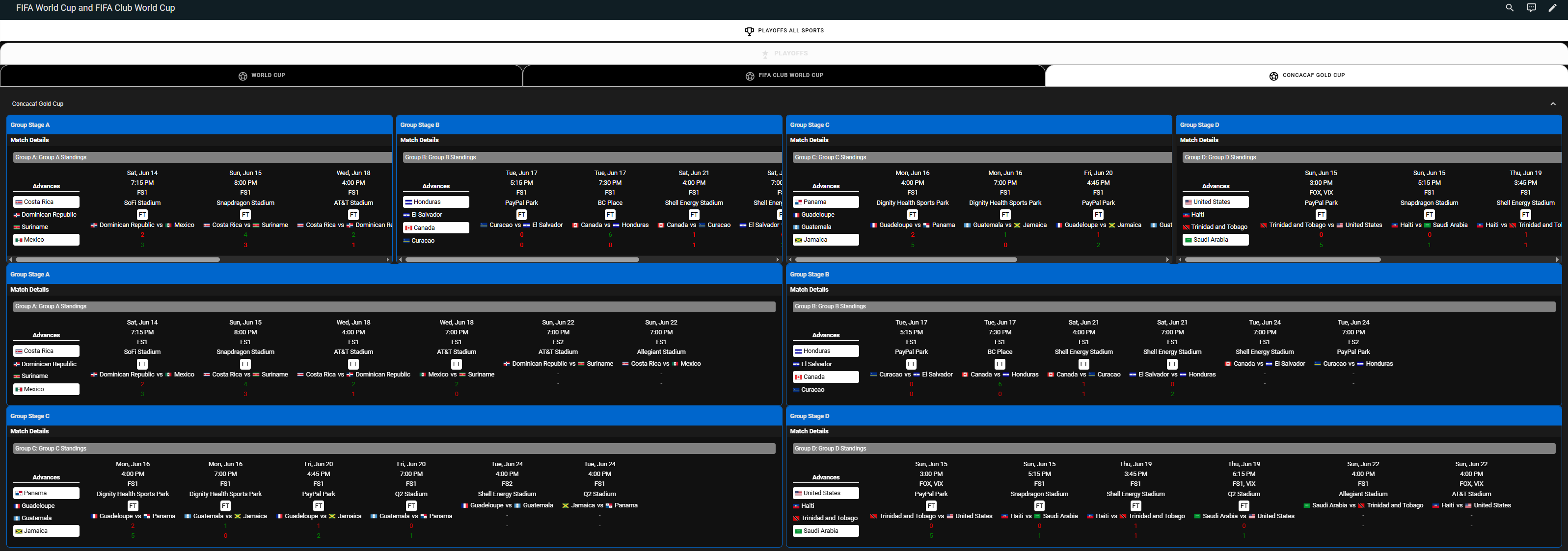

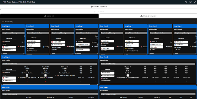

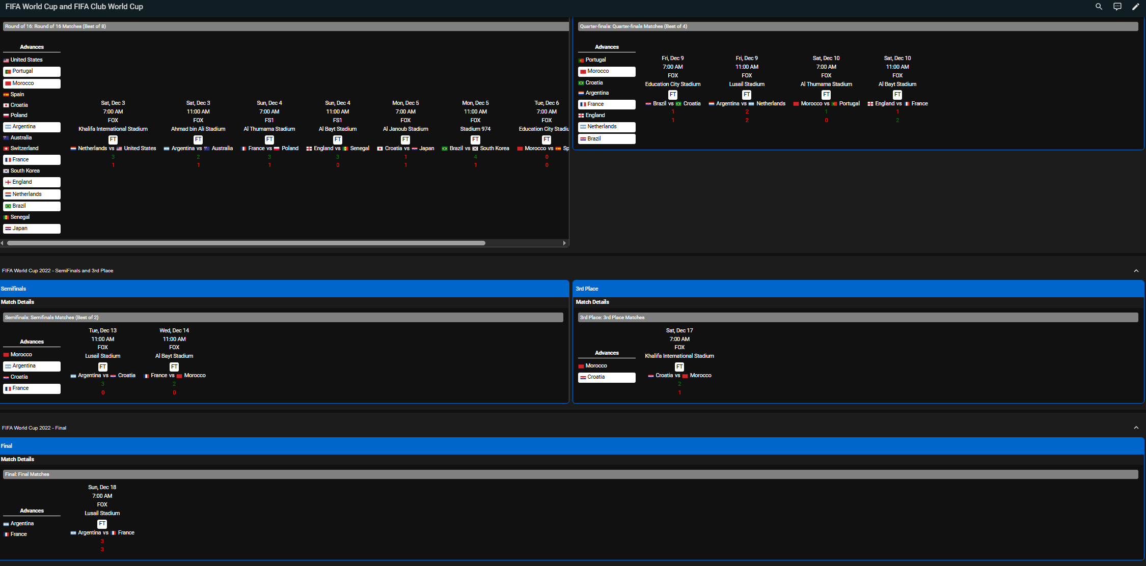

Playing with FIFA World Cup to get ready for next year (2022 data for now) and since FIFA Club World Cup is going on and FIFA has moved Club to mostly the same format as FIFA World CUp I have been playing with it as well. Not sure how much time I am going to put into it but I have put all of the code I am using right now in my Github site under Soccer - FIFA World Cup & Club World Cup section.
I have tried to layout how I am getting the data in the readme so hopefully that spells out what I am doing.
Lots of moving parts and I am using Flextable probably not how it is intended (I blame @ehcah ) but it is giving me what I am looking for on a quick dashboard.
I would love to have anyone/everyone improve this code
Here are a couple Screen Shots:
Update 6-22-2025 - Fixed names to get rid of TBD, Added Concacaf and a couple other fixes

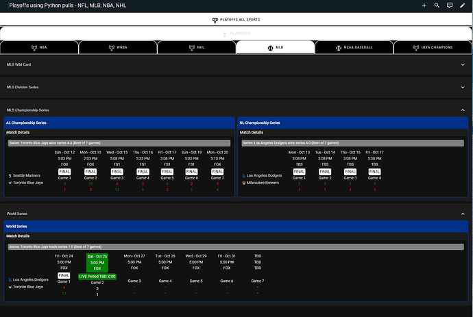

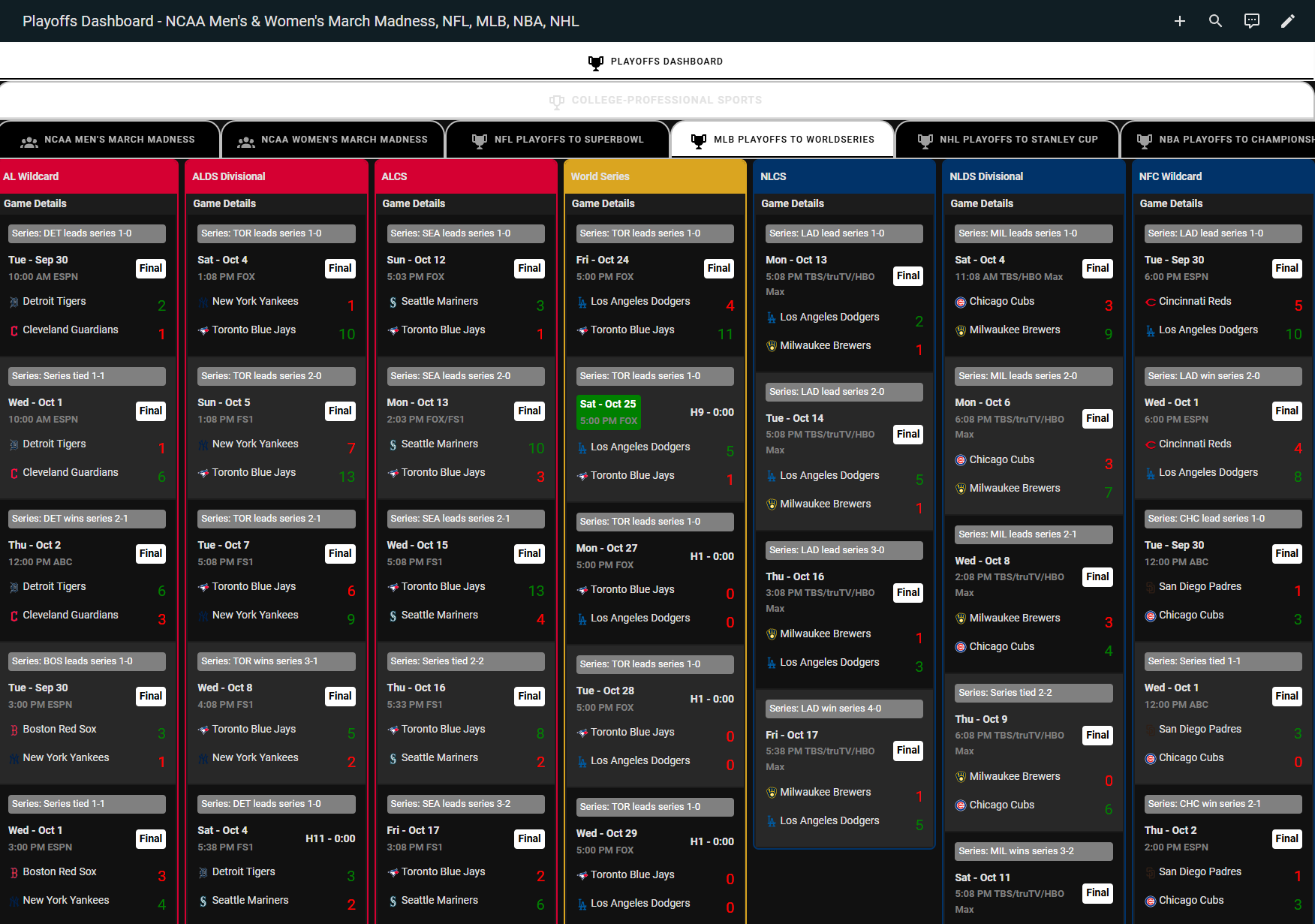

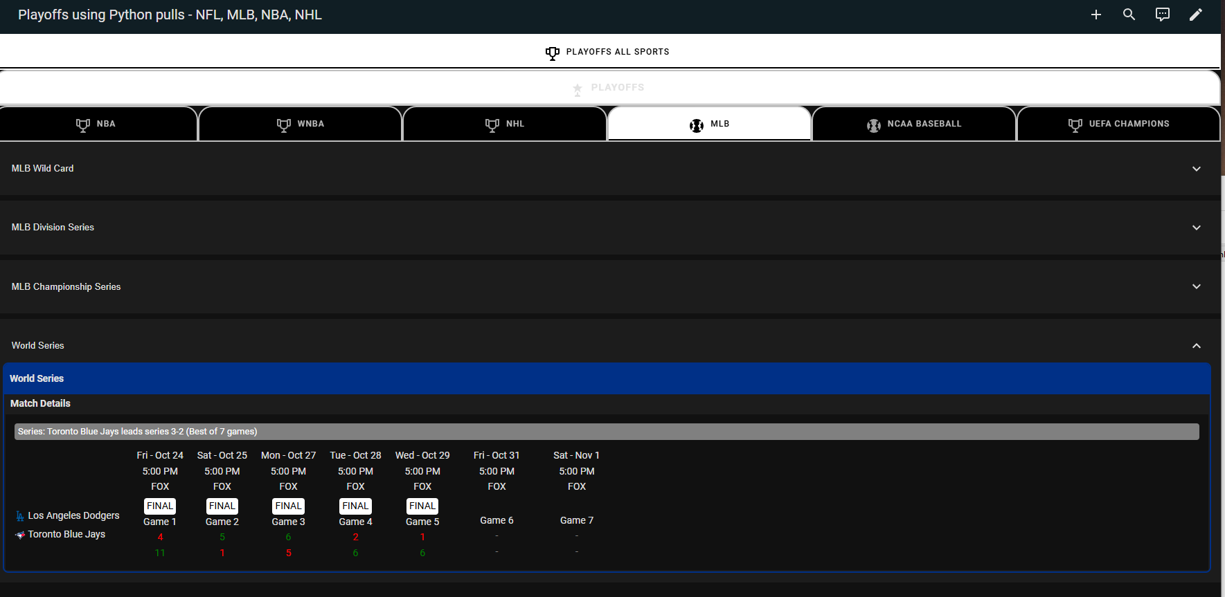

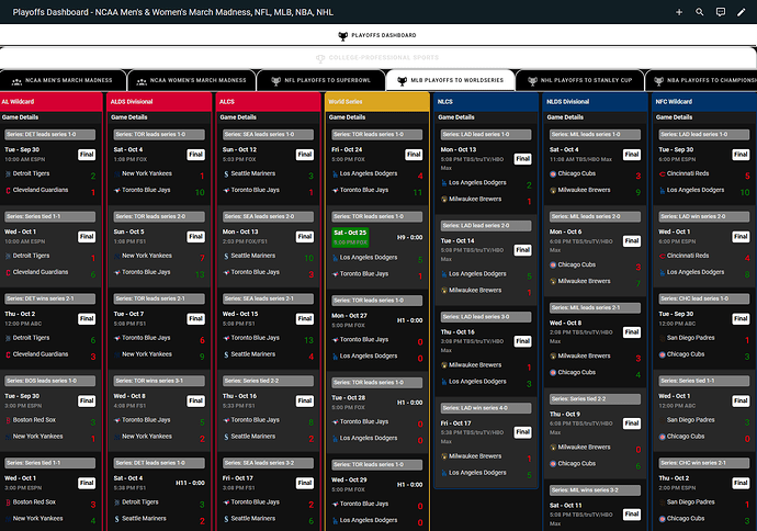

For those that are using my playoff python files and dashboard the MLB is starting to populate the api. The MLB playoffs will need to have this years dates inserted. I have updated the mlb_sensors.yaml post season playoffs sensor with the following:
resource: https://site.api.espn.com/apis/site/v2/sports/baseball/mlb/scoreboard?dates=20250929-20251024
and the mlb-1st-grok.py python file as well with:
API_URL = "https://site.api.espn.com/apis/site/v2/sports/baseball/mlb/scoreboard?dates=20250929-20251024"
This is what I am seeing right now:
I need to work on the format/layout (but I just dont have the time to play yet) but I would love to see any customizations of this that I could incorporate.

for the non-python dashboard - I break the playoffs up into filtered events and then use them when I call the decluttering card. Specifically these 2:
- entity: sensor.mlb_playoff_filtered_events
- events: al_wild_card
you can see that in this example under variables in the dashboard
                           - attributes:
                                label: MLB Playoffs to WorldSeries
                                icon: mdi:trophy
                              card:
                                type: horizontal-stack
                                cards:
                                  - type: vertical-stack
                                    cards:
                                      - type: custom:decluttering-card
                                        template: sports_playoffs
                                        variables:
                                          - title: AL Wildcard
                                          - color: '#D50032'
                                          - show_rankings: false
                                          - show_series: true
                                          - show_broadcast: true
After cleaning up my template.yaml file, there were indentation errors that were preventing it from loading, I was able to get the one with template sensors to populate. But still no luck with the python one. But I’ll keep working on it. One thiong to note, both of the dashboards you have in the new dashboard folder are the same. I needed to pull one from the archive folder.
Lou - apologize I see that I duplicated the dashboard code. Should be fixed now and hopefully Github is cleaned up.

Let me know if that helps. Here is what I am seeing today:
