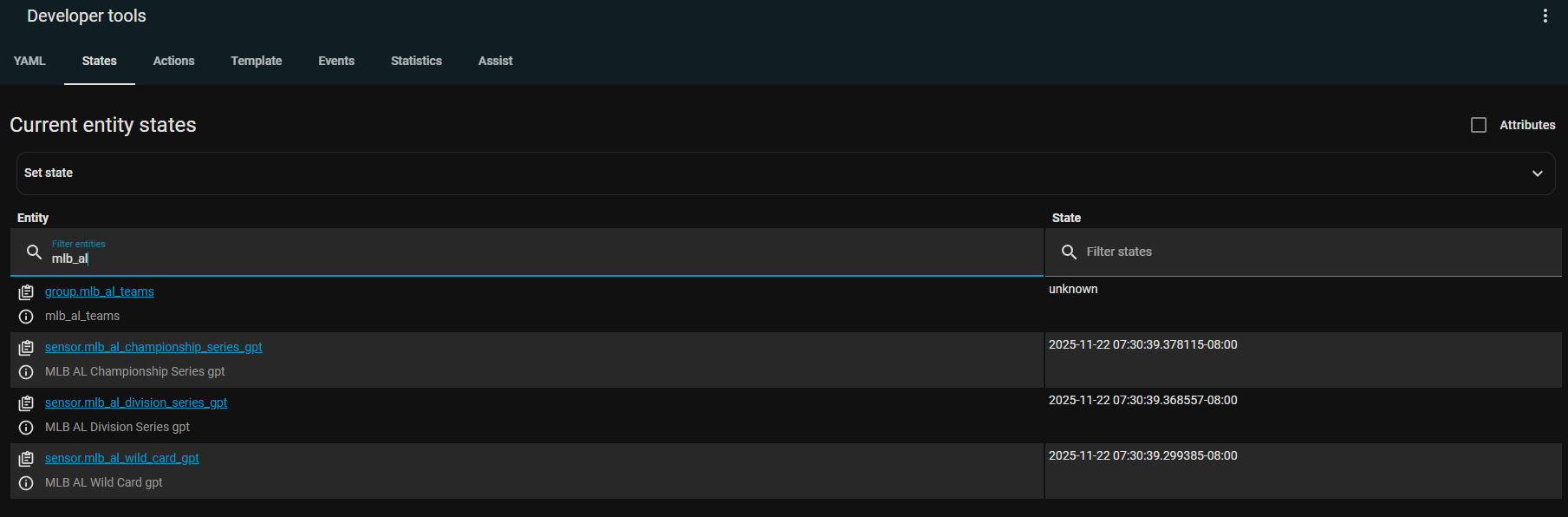

Great - sounds like you are close. When the python script runs it creates a .json file which it sounds like you have. Think of this file like an ESPN endpoint that we have used for other sports/statistics. We have to get that json file data into a sensor.
For each sport I break them out into their own sensor yaml file. For example MLB it has its own mlb_sensors.yaml file in the sensors subdirectory.
You will see a couple examples in there of how data gets put into the sensors that we name.
I would always make sure to go through the developers tab and the logs - here is an example in tools:
So for python script data you will see that the json files are grabbed locally like this (you can see the local IP address in the resource):
- platform: rest
  name: MLB AL Wild Card gpt
  unique_id: sensor.mlb_al_wild_card_gpt
  resource:  http://192.168.xxx.xxx:8123/local/mlb_al_wild_card_gpt.json
  value_template: "{{ now()}}"
  json_attributes:
   - events
   - series

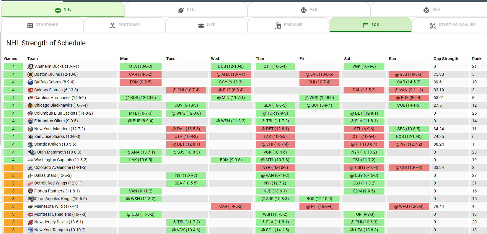

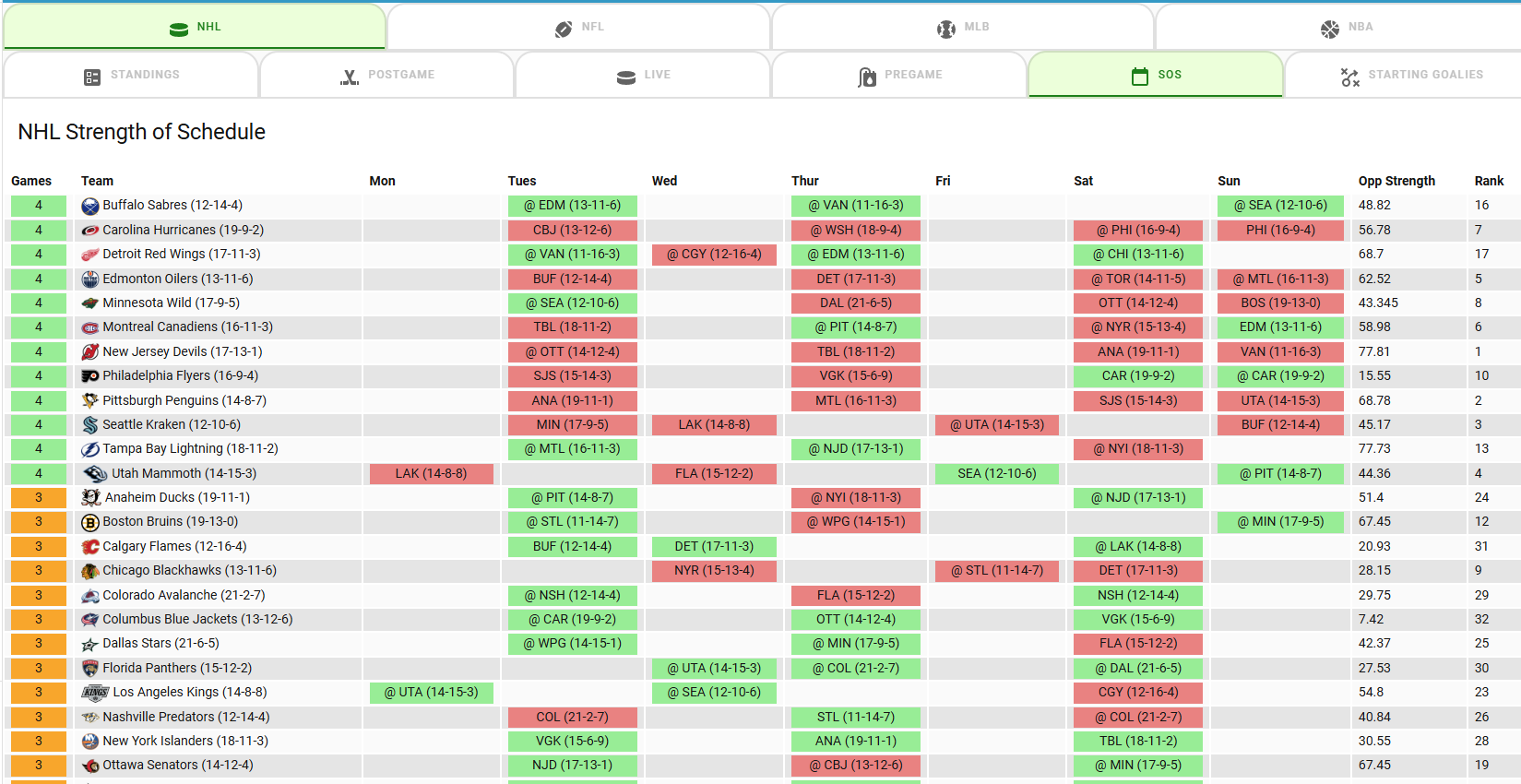

Side note: I refactored the Strength or Schedule view from dailyfaceoff.com to not use the plugin route for Flex Table. Posting here the relevant tidbits:
The sensor (uses multiscrape) so an include to multiscrape.yaml in configuration.yaml as::
multiscrape: !include multiscrape.yaml
Then the sensor itself to store the data:
  - name: SOS scraper
    resource_template: "https://www.dailyfaceoff.com/nhl-weekly-schedule/{{ (now().timestamp()+(0-now().weekday())*86400) | int | timestamp_custom('%Y-%m-%d') }}"
    scan_interval: 3600
    sensor:
      - unique_id: hockey_strength_of_schedule
        name: Hockey Strength of Schedule
        select: '#__NEXT_DATA__'
        value_template: '{{ now() }}'
        attributes:
          - name: sos
            value_template: >
                {{ (value | from_json)['props']['pageProps'] }}
Now the decluttering template:
  sos_settings:
    card:
      type: custom:flex-table-card
      title: '[[title]]'
      css:
        table+: 'padding: 0px; width: 100%;'
        tbody tr:hover: 'background-color: lightgreen!important;'
      card_mod:
        style: |
          ha-card {
              overflow: auto;
              .card-header {
                 padding: 12px 0px 8px 4px!important;
                 font-size: 16px!important;
                 line-height: 18px!important;
                 font-weight: bold!important;
      entities:
        include: '[[entity]]'
      sort_by: sos.dataRows-
      columns:
        - name: Games
          data: '[[attribute]]'
          modify: |-
            if (x[8] > 3 ){
                '<div style="display:none;">'+ x[8] + '</div>' + '<div style="background-color:lightgreen;text-align:center">' + x[8] + '</div>'; }
            else if (x[8] == 3) {
                '<div style="display:none;">'+ x[8] + '</div>' + '<div style="background-color:orange;text-align:center"">' + x[8] + '</div>'; }
            else {
                '<div style="display:none;">'+ x[8] + '</div>' + '<div style="background-color:red;color:white;text-align:center">' + x[8] +'</div>'}
        - name: Team
          modify: >-
            '<div><img src="' + x[0].team.logo + '"
            style="height:20px;vertical-align:middle;">&nbsp;' + x[0].team.name
            + '&nbsp;' + '(' + x[0].team.wins + '-' + x[0].team.losses + '-' +
            x[0].team.overtimeLosses + ')' +'</div>'
        - name: Mon
          modify: |-
            if (x[1] === null ){
            } else {
              if (x[0].team.strengthOfSchedule.strength > x[1].team.strengthOfSchedule.strength){
                '<div style="background-color:lightcoral;text-align:center">' + (x[1].home == true ? "" : "@&nbsp;") + x[1].team.abbreviation + '&nbsp;' + '(' + x[1].team.wins + '-' + x[1].team.losses + '-' + x[1].team.overtimeLosses + ')' + '</div>'
              } else {
                '<div style="background-color:lightgreen;text-align:center">' + (x[1].home == true ? "" : "@&nbsp;") + x[1].team.abbreviation + '&nbsp;' + '(' + x[1].team.wins + '-' + x[1].team.losses + '-' + x[1].team.overtimeLosses + ')' + '</div>'
        - name: Tues
          modify: |-
            if (x[2] === null ){
            } else {
              if (x[0].team.strengthOfSchedule.strength > x[2].team.strengthOfSchedule.strength){
                '<div style="background-color:lightcoral;text-align:center">' + (x[2].home == true ? "" : "@&nbsp;") + x[2].team.abbreviation + '&nbsp;' + '(' + x[2].team.wins + '-' + x[2].team.losses + '-' + x[2].team.overtimeLosses + ')' + '</div>'
              } else {
                '<div style="background-color:lightgreen;text-align:center">' + (x[2].home == true ? "" : "@&nbsp;") + x[2].team.abbreviation + '&nbsp;' + '(' + x[2].team.wins + '-' + x[2].team.losses + '-' + x[2].team.overtimeLosses + ')' + '</div>'
        - name: Wed
          modify: |-
            if (x[3] === null ){
            } else {
              if (x[0].team.strengthOfSchedule.strength > x[3].team.strengthOfSchedule.strength){
                '<div style="background-color:lightcoral;text-align:center">' + (x[3].home == true ? "" : "@&nbsp;") + x[3].team.abbreviation + '&nbsp;' + '(' + x[3].team.wins + '-' + x[3].team.losses + '-' + x[3].team.overtimeLosses + ')' + '</div>'
              } else {
                '<div style="background-color:lightgreen;text-align:center">' + (x[3].home == true ? "" : "@&nbsp;") + x[3].team.abbreviation + '&nbsp;' + '(' + x[3].team.wins + '-' + x[3].team.losses + '-' + x[3].team.overtimeLosses + ')' + '</div>'
        - name: Thur
          modify: |-
            if (x[4] === null ){
            } else {
              if (x[0].team.strengthOfSchedule.strength > x[4].team.strengthOfSchedule.strength){
                '<div style="background-color:lightcoral;text-align:center">' + (x[4].home == true ? "" : "@&nbsp;") + x[4].team.abbreviation + '&nbsp;' + '(' + x[4].team.wins + '-' + x[4].team.losses + '-' + x[4].team.overtimeLosses + ')' + '</div>'
              } else {
                '<div style="background-color:lightgreen;text-align:center">' + (x[4].home == true ? "" : "@&nbsp;") + x[4].team.abbreviation + '&nbsp;' + '(' + x[4].team.wins + '-' + x[4].team.losses + '-' + x[4].team.overtimeLosses + ')' + '</div>'
        - name: Fri
          modify: |-
            if (x[5] === null ){
            } else {
              if (x[0].team.strengthOfSchedule.strength > x[5].team.strengthOfSchedule.strength){
                '<div style="background-color:lightcoral;text-align:center">' + (x[5].home == true ? "" : "@&nbsp;") + x[5].team.abbreviation + '&nbsp;' + '(' + x[5].team.wins + '-' + x[5].team.losses + '-' + x[5].team.overtimeLosses + ')' + '</div>'
              } else {
                '<div style="background-color:lightgreen;text-align:center">' + (x[5].home == true ? "" : "@&nbsp;") + x[5].team.abbreviation + '&nbsp;' + '(' + x[5].team.wins + '-' + x[5].team.losses + '-' + x[5].team.overtimeLosses + ')' + '</div>'
        - name: Sat
          modify: |-
            if (x[6] === null ){
            } else {
              if (x[0].team.strengthOfSchedule.strength > x[6].team.strengthOfSchedule.strength){
                '<div style="background-color:lightcoral;text-align:center">' + (x[6].home == true ? "" : "@&nbsp;") + x[6].team.abbreviation + '&nbsp;' + '(' + x[6].team.wins + '-' + x[6].team.losses + '-' + x[6].team.overtimeLosses + ')' + '</div>'
              } else {
                '<div style="background-color:lightgreen;text-align:center">' + (x[6].home == true ? "" : "@&nbsp;") + x[6].team.abbreviation + '&nbsp;' + '(' + x[6].team.wins + '-' + x[6].team.losses + '-' + x[6].team.overtimeLosses + ')' + '</div>'
        - name: Sun
          modify: |-
            if (x[7] === null ){
            } else {
              if (x[0].team.strengthOfSchedule.strength > x[7].team.strengthOfSchedule.strength){
                '<div style="background-color:lightcoral;text-align:center">' + (x[7].home == true ? "" : "@&nbsp;") + x[7].team.abbreviation + '&nbsp;' + '(' + x[7].team.wins + '-' + x[7].team.losses + '-' + x[7].team.overtimeLosses + ')' + '</div>'
              } else {
                '<div style="background-color:lightgreen;text-align:center">' + (x[7].home == true ? "" : "@&nbsp;") + x[7].team.abbreviation + '&nbsp;' + '(' + x[7].team.wins + '-' + x[7].team.losses + '-' + x[7].team.overtimeLosses + ')' + '</div>'
        - name: Opp Strength
          modify: x[0].team.strengthOfSchedule.averageOpponentStrength
        - name: Rank
          modify: x[0].team.strengthOfSchedule.rank
And the result:
Perfect for NHL Fantasy Hockey players to visualize the upcoming week.

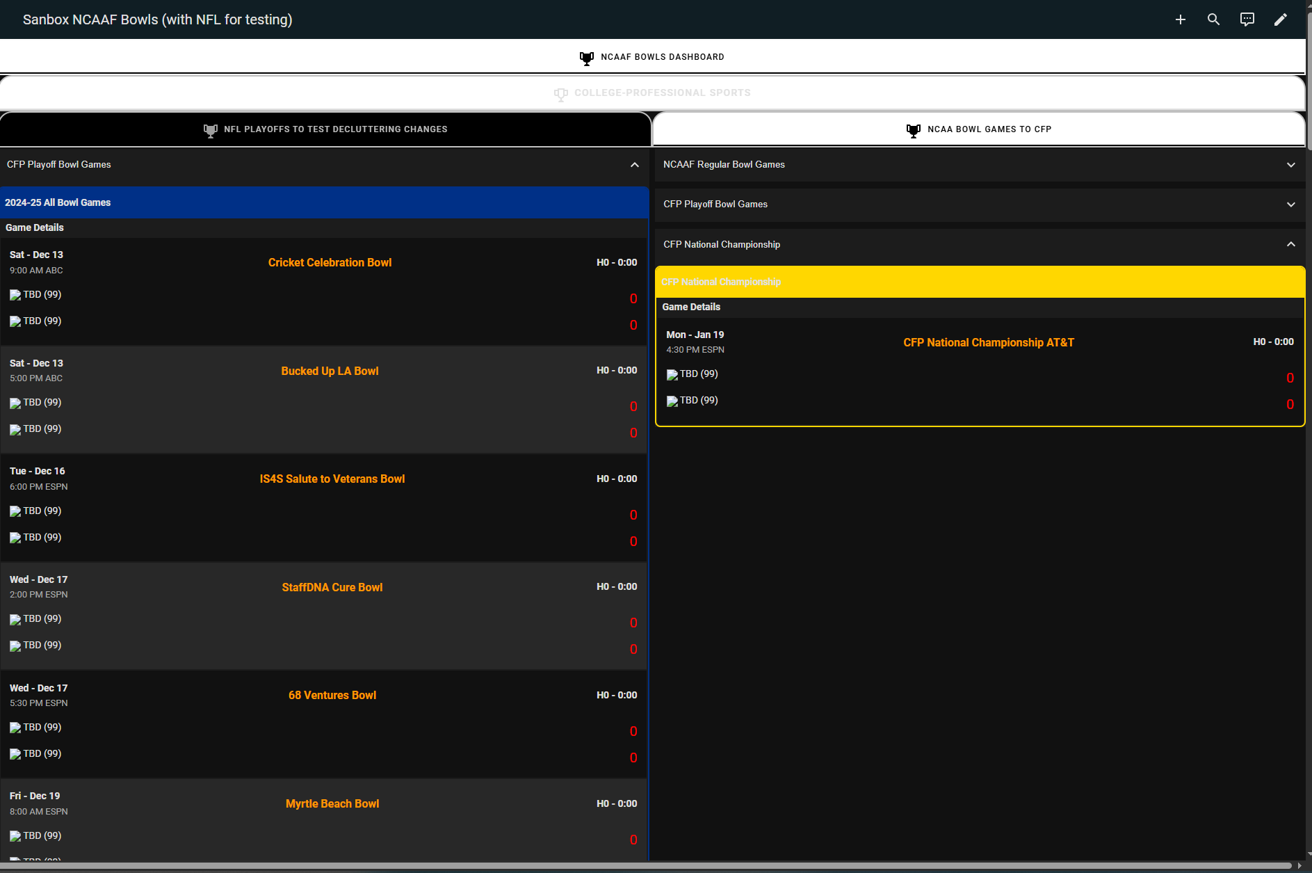

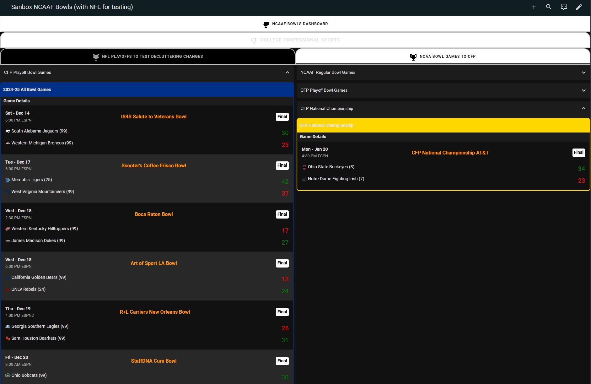

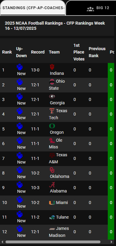

So I have been playing with the NCAAF College Bowls. I wanted to try to use Sensors/Template, but like before Template has a problem with size. So I had to go back to using python to make an ESPN call that then separates out All Bowls, Regular Bowls, CFP Playoffs and CFP National Championship into their own json files that I then pull into their respective sensors that I have added to the ncaaf_sensors.yaml file.
Here are the adds to the ncaaf_sensors.yaml file:
###########################NCAAF Bowl Games
### NCAAF Bowl Games
- platform: rest
  name: NCAAF Regular Bowl Games
  unique_id: sensor.ncaaf_regular_bowl_games
  resource:  http://192.168.xxx.xxx:8123/local/cfb_regular_bowls.json
  json_attributes:
   - events
### CFP Bowl Games
- platform: rest
  name: NCAAF CFP Playoffs Bowl Games
  unique_id: sensor.ncaaf_cfp_playoffs_bowl_games
  resource:  http://192.168.xxx.xxx:8123/local/cfb_cfp_playoffs.json
  json_attributes:
   - events
### CFP Championship Bowl Game
- platform: rest
  name: NCAAF CFP Championship Bowl Game
  unique_id: sensor.ncaaf_cfp_championship_bowl_game
  resource:  http://192.168.xxx.xxx:8123/local/cfb_championship.json
  json_attributes:
   - events
### NCAAF All bowl Games
- platform: rest
  name: NCAAF All Bowl Games
  unique_id: sensor.ncaaf_all_bowl_games
  resource:  http://192.168.xxx.xxx:8123/local/cfb_all_bowls.json
  json_attributes:
   - events

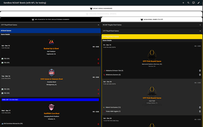

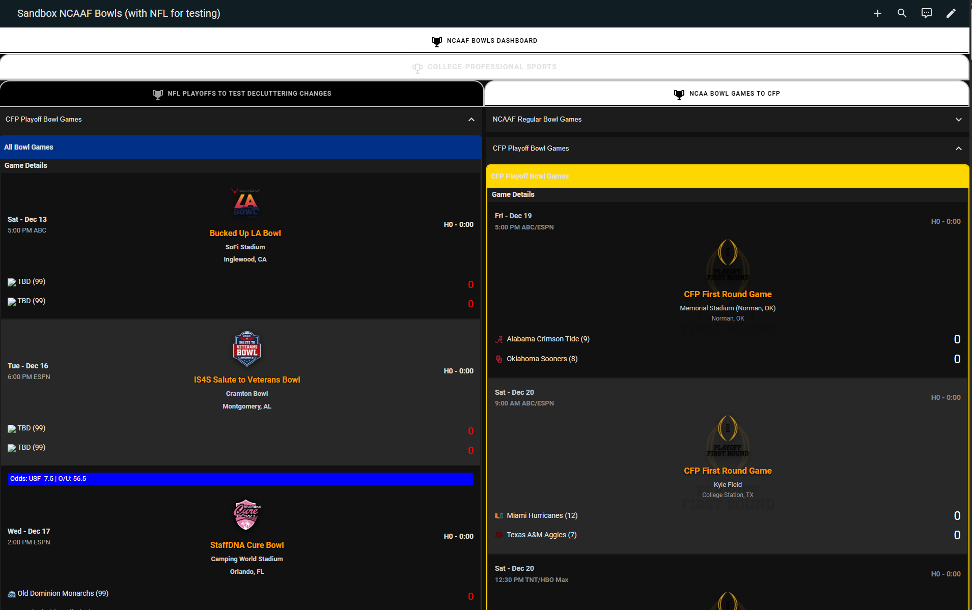

  • The Dashboard that I am using is called: Sanbox NCAAF Bowls (with NFL for testing)
    ** I am still working on changes that I will then most likely incorporate into the other playoffs that is why I have the NFL in there for testing. I am also looking at adding bowl logos but that most like will need to be added to the python files. ESPN doesnt populate bowl pngs that I can find. I will eventually put this into the college sports dashboard once I am happy with the decluttering changes - yea I know I called it SANbox :wink:
  • You will need to create an automation because it should update during the games with live data but no way to test yet and last years are finals.
  • The sensors above have also been added to the ncaaf_sensors.yaml on github.
  • I am using expander-card as I do in other areas.
  • You will see all bowl games on the left and then on the right the layout is Regular Bowls, CFP Playoffs and then CFP National Championship.
Here is what last year looks like:
This years bowls haven’t been selected yet so this is what it looks like today:
Please make suggestions, changes and I will try to incorporate when I have time.

It looks like the CFP Playoffs and Bowl Games for 2025-2026 are starting to populate. I have updated the Sandbox NCAAF Bowls on my github.
In the decluttering template I have 2 templates - sports_playoffs and sports_playoffsv2. I am working to have the v2 display more information especially during live bowls - but still a work in progress. You can see from this image sports_playoff on the left and sports_playoffv2 on the right. Not alot to see yet but will update as bowls start to be played.
You can change to either one by changing the template being called. Heres a section that you can see where in my Sandbox - CFP dashboard. template: sports_playoffs or sports_playoffsv2
- type: custom:expander-card
                                        child-margin-top: 0.6em
                                        padding: 0
                                        title: CFP Playoff Bowl Games
                                        title-card-button-overlay: true
                                        title-card-clickable: true
                                        expanded: false
                                        cards:
                                          - type: custom:decluttering-card
                                            template: sports_playoffsv2
                                            variables:
                                              - title: CFP Playoff Bowl Games
                                              - color: '#FFD700'
                                              - entity: sensor.ncaaf_cfp_playoffs_bowl_games
                                              - events: events
                                              - show_rankings: true
                                              - show_series: false
Also the CFP playoff teams are populated as well:
Bro, I love this! but I can’t get it to work. I created the sensor in multiscrape exactly as you indicated (I can see all the info in atrributes already):
- name: SOS scraper
  scan_interval: 3600
  sensor:
      attributes:
        - name: sos
          value_template: >
And I changed '[[entity]]' to the name of the created sensor sensor.hockey_strength_of_schedule
entities:
In addition to changing all the '[[attribute]]' to the attribute sos in all the lines data: '[[attribute]]' Do you know what I might be doing wrong?
You should post the code that is not working instead of a list of items you ‘think’ you changed in case you missed some :slight_smile:
Yes, please post the code. The “older” SOS page used to use JS functions I wrote. I did rewrite that later to remove the functions. Possibly that is it.
Yes @anon60850888 / @kbrown01, you’re absolutely right, sorry — here’s the full code. You can find the strength calendar code starting from line 2 and the label card from line 617 decluttering_templates: sos_settings: card: type: custom:flex-tab - Pastebin.com"
My decluttering is:
  sos_settings:
    card:
      title: '[[title]]'
      css:
      card_mod:
        style: |
          ha-card {
              overflow: auto;
              .card-header {
      entities:
      columns:
        - name: Games
          modify: |-
            if (x[8] > 3 ){
            else {
        - name: Team
          modify: >-
        - name: Mon
          modify: |-
            } else {
              } else {
        - name: Tues
          modify: |-
            } else {
              } else {
        - name: Wed
          modify: |-
            } else {
              } else {
        - name: Thur
          modify: |-
            } else {
              } else {
        - name: Fri
          modify: |-
            } else {
              } else {
        - name: Sat
          modify: |-
            } else {
              } else {
        - name: Sun
          modify: |-
            } else {
              } else {
        - name: Rank
which gives:
I’m not sure if this is the best place to post this, but I’ve not been able to find the answer on any other discussion boards. The rest sensor, resource: http://192.168.xxx.xxx:8123/local/somefile.json, does not create the sensor nor populate it. The rest sensor that uses the espn link works fine, it’s just the local call that I’m having the problem with. I have tried everyway I can think of to get this to work including disabling duckdns, adblock, and nginx with no luck. The only log entry I’ve seen related to it said the Rest sensor could not parse the json file, but that has cleared itsalf as well. If anyone has run across this I would appreciate any guidance you might have.
Lubo - the ip should be the IP of your HA system - so something like http://192.168.1.2:8123/local/somefile.json
I am guessing you are trying to use my python file to pull data from ESPN into a json file which is the first part of the process. Here is the logic:
  1. Python file is run and pulls data from ESPN into a json file or json files that are placed in the /config/www directory.
  2. Then I setup RESTful sensors to grab the data in the json files and put them into the sensor. I do this for a couple reasons. Primarily because Home Assistant Templates have size issues and can only hold so much data before they fail/break. Other is that I want to organize the data - eg. All NCAAF bowls in a sensor, non-cfp bowl games, CFP bowl games, etc… Here is an example of the NCAAF Bowl Game Sensor I have: `### NCAAF Bowl Games
  1. I put 192.168.xxx.xxx - so that you can put your own HA IP number in there and not run into problems using mine. I am old so I use IP’s but you could probably use the DNS name if that is configured in your house.
Correct, I’m using the same code after decluttering_templates: and in the tab where I add the card I use the following:
                    - attributes:
                        label: Calendar
                        icon: mdi:clock-start
                      card:
                        template: sos_settings
                        variables:
                          - title: Calendar
                          - attribute: sos
                          - entity: sensor.hockey_strength_of_schedule
I get the titles but not the information, I don’t know if I might have something wrong in the card code.
