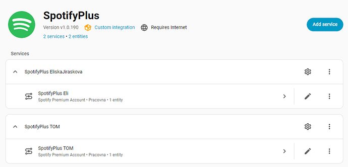

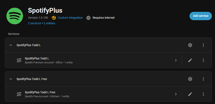

  1. Go to the Settings \ Devices & Services \ SpotifyPlus screen and take a screen capture of what you see there. This will tell me what SpotifyPlus services / accounts you have configured. It should look something like this:
Thank you for your support. I really appreciate it.
Here is the result:
result: |
  **Domain: spotify**
    Application Credentials:
      - ID: `spotify_0b58a575xxxxxxxx`, Client ID: `0b58a575xxxxxxx`, Name: `Spotify`
        - Entity ID: `media_player.spotify_tom`, Name: `Spotify TOM`, Unique ID: `2edjewxxxxxx`
  **Domain: spotifyplus**
      - ID: `spotifyplus_0b58a575xxxxxxxxx`, Client ID: `0b58a575xxxxxxx`, Name: `Spotify Plus`
        - Entity ID: `media_player.spotifyplus_tom`, Name: `SpotifyPlus TOM`, Unique ID: `2edjewxxxxxx_spotifyplus`
        - Entity ID: `media_player.spotifyplus_eliskajiraskova`, Name: `SpotifyPlus EliskaJiraskova`, Unique ID: `eodvg02xxxxxxx_spotifyplus`
@Tomm206
Ya, I think the issue here is that you are sharing the same HA Application Credentials between both SpotifyPlus services. It appears you are sharing the same credentials with the HA Spotify integration as well.
I would suggest the following:
  1. remove (or disable) the HA Spotify integration service.
  2. remove (or disable) one of the SpotifyPlus integration services.
When (if?!) Spotify opens up their Developer App process again, create a new App for the disabled SpotifyPlus integration service, as well as a new App for the HA Spotify integration service. You can then create new HA Application Credentials for the new Dev Apps, and add them back into HA.
