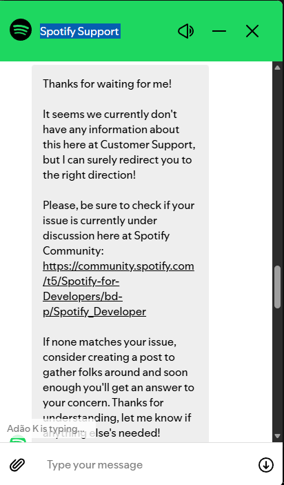

I’ve been trying to connect HA to my premium spotify account, but seem to have hit a wall since Spotify have blocked creation of new apps in the developer dashboard - the create app button is greyed out and it says “New integrations are currently on hold …”.
Spotify community has this thread full of unhappy customers:
Their “solution” is to confirm that it’s broken and functionality is “on hold”.
As far as I can see, this is essential for all Spotify integrations - the core one and the custom Spotifyplus one from @thlucas.
Anyone else struggling with this or have a solution/workaround?
