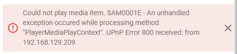

what can be the problem here ? I get this error when trying to play a playlist…
@Faecon
The UPNP errors are a Sonos-specific issue, and can vary on what causes them.
Have you configured the SpotifyPlus Integration Spotify Web Player Authentication Setup steps? Note that this is different than the OAuth2 token setup (required for Sonos device activation).
The Spotify Web Player Authentication Setup allows better control of the player for Sonos devices.
I did … But can I see somewhere if i did it works ?
@Faecon
If you select a Sonos source in the media player, it should transfer control to Sonos via Spotify Connect. Check the Sonos App to see if the local queue is in use or not. If it’s NOT in use (e.g. is says Queue (not in use)) then you have the Spotify Web Player Authentication Setup correctly.
