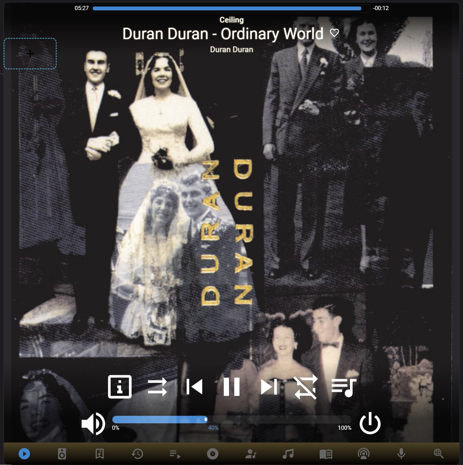

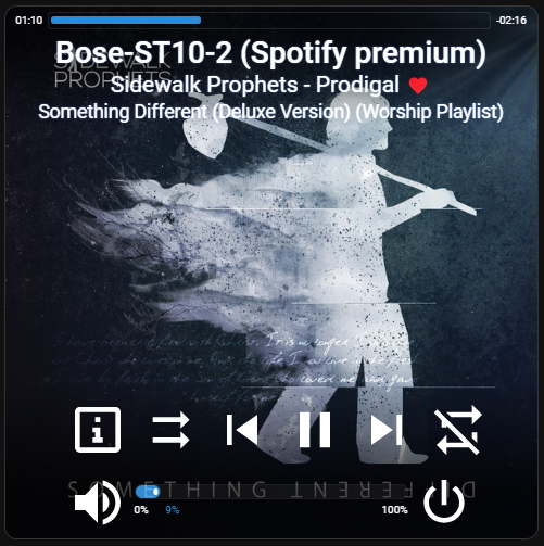

Are there css variables to change the player control icon size? << Play >>, etc. I’ve dug in to try this with card mod and mod card, but without success. (AI tells me the elements are 5 shadow dom layers deep, and untouchable :slight_smile: At least for my skillset.)
Or is there an easier way that i’m missing? I think all of the footer config is for the row of icons below the controls i’m looking for.
Have you tried:
playerControlsIconSize: 2.5rem
The visual editor allows you to change it also: Player>Controls. The default is 2.0rem
@brett91
You can customize button sizes / colors / fonts / etc using the player theming options. There is no UI Editor support for these options, but you can specify them via the code editor or in an HA theme file.
UPDATE: As @PlayedIn pointed out in a reply, the playerControlsIconSize is supported via the UI editor; I omitted the other settings from the UI editor, as there were so many to add, and limited real-estate on the editor UI form that I just decided to make them manual. Hopefully the documentation does a good job of explaining what options are available.

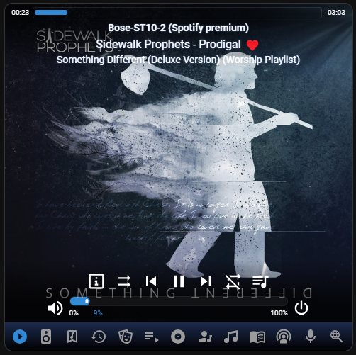

For example, the default format:
Can turn into this:
by specifying these 4 theming configuration options in the card configuration via Show Code Editor:
playerControlsIconSize: 4rem
playerHeaderTitle1FontSize: 2rem
playerHeaderTitle2FontSize: 1.5rem
playerHeaderTitle3FontSize: 1.25rem
Nice integration and card! Very responsive and configurable :star_struck:
Thank you. I hadn’t found the secondary menu buttons under player! I looked several times. Perfect. Great card for my use case.

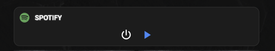

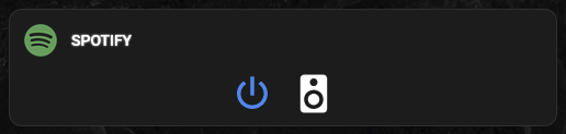

Is it possible with the current configuration to add the device button to the card if the card is minimized?
or
Is it possible to expend the card (like it does right now with the power button) without starting a playback on the recent used device ?

I want to start music on a device of choice (Not a default device). I think that is impossible right now when using the nice and compact “minimize” option.
Thanks
@woempiej
Sorry, that is not possible right now. You can submit a feature request though and I’ll see if I can get it added.

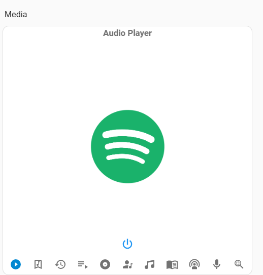

Im using this card and it’s awesome. Im just using it in my games room, to control spotify to one alexa device. Works a treat.
One little issue I have though is that most times, people play music by voice command. So ‘alexa play whatever on spotify’.
When somthing is already playing, the card stays looking like the below photo. Is there any way to get it to show what is currently playing instead?
@hamd01
Absolutely - check out the SpotifyPlus integration Always On configuration option. This tells the integration to always remain turned on (just like HA Spotify). The integration is turned off by default.
Note that it can take between 1-30 seconds to detect Spotify Player state when it’s controlled by players outside of HA (just like HA Spotify). You can also reduce that delay from 1-4 seconds by setting the SpotifyPlus integration Spotify Polling Scan Interval value. Just make sure you read the documentation for the pros / cons of adjusting the polling interval.
that worked beautifully!!! Thank you

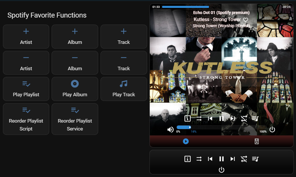

I have an idea… what if you made those specific buttons a separate card, separate buttons. (and allow for completely hiding those buttons on the main card)? If they are separate exposed entities this is possible, I think easily?
This would allow for separate positioning logic in the dashboard, and thus no responsiveness issues based on positioning since the card itself is not doing any of that. The cool thing about that is in a separate card, the user could then make them horizonal, vertical, grid, whatever… and place them anywhere in the Dashboard view itself.
@Ltek
You could do this already by setting up a separate instance of the card, and setting the card height (see screenshot below), as well as hiding the player icons in the card above it. The problem with that (currently) is that the card logic specifies a min-height value of 15rem, but that could be easily changed.

You could also setup a vertical stack with your own custom icons / titles. You would just issue a service call to the appropriate service to perform the function (pause, resume, etc). The following is an example of adding an artist favorite; you could use something similar for a “Pause” button, etc.
type: vertical-stack
cards:
  - square: false
    type: grid
    title: Spotify Favorite Functions
    columns: 3
    cards:
      - type: button
        icon: mdi:plus
        icon_height: 32px
        show_name: true
        show_icon: true
        tap_action:
          action: call-service
          service: spotifyplus.follow_artists
          target: {}
            entity_id: media_player.spotifyplus_todd_l

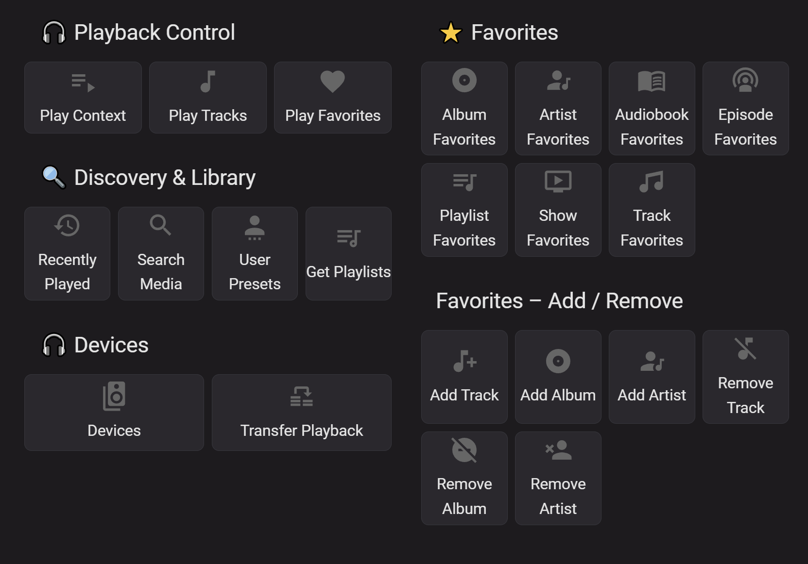

I tried creating buttons but many of them I cant find the service commands. Is there a master list that shows all of them at once?
sections Add/Remove & Playback Control work; Devices, Discovery, top Favorites do not
@Ltek
Have a look at the SpotifyPlus Integration Services Provided wiki doc for a list of supported services. Also check out the Media Player Service Enhancements list for standard HA media player entity services that have been enhanced.
The Player Media Play Track Favorites service can be used to start play of your Spotify favorite tracks list.
Not sure what you are trying to accomplish with most of the other buttons / features, as they require input criteria to use.
Regarding the “Recently Played”, you might be able to create your own dashboard with those entries. The closest working example I have would be the Queue Info List Dashboard, which works pretty much the same but would use the Get Player Recent Tracks service call to get the media list instead of the Get Player Queue Info service call.
