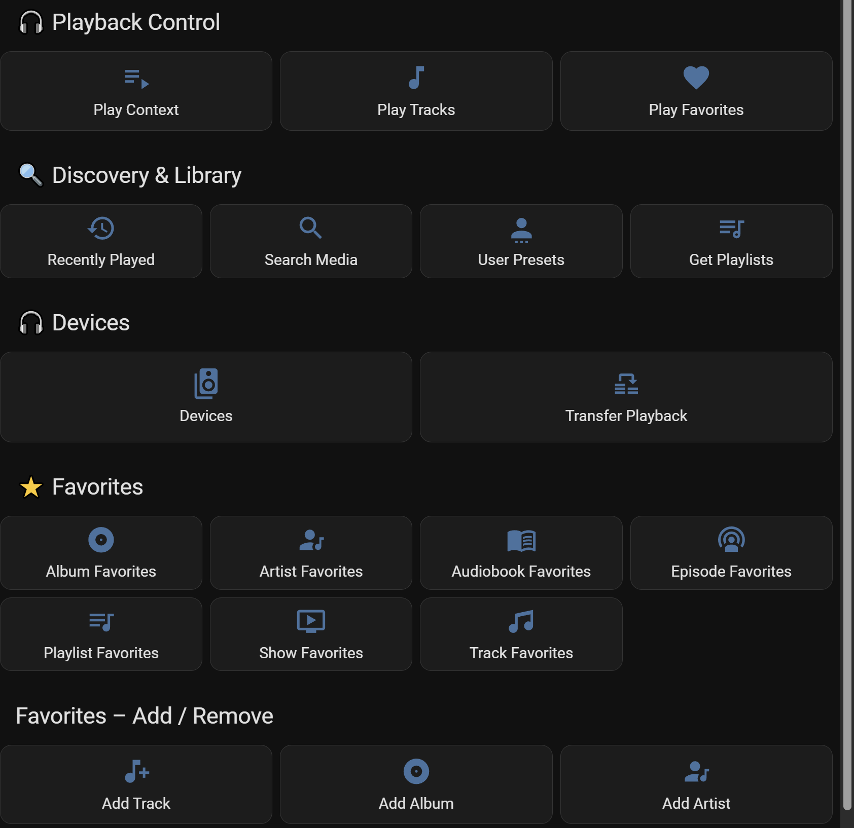

@thlucas Hope you would be willing to help by fixing a few of the buttons with the corrected YAML to show me what they should really be so I can fix the rest.
I’ve made a few attempts to get these buttons working and mostly failing.These buttons will make it a lot easier for family and guests to use it the controls since they are larger with descriptions.
thank you!
Dashboard YAML file here
@Ltek
Not sure what you are trying to do with this …
Is the idea to click on a button, call a SpotifyPlus integration service, and have something display in the SpotifyPlus Card? If so, that is not the way the SpotifyPlus integration services work. They are built more for automations and scripts to control the player and return results in a non-interactive way.
You can obviously define front-end UI buttons that call these services to do SOME things, but nothing that is interactive. You would need to write your own card / dashboard for something similar to what the SpotifyPlus Card does. You might have a look at the Queue Info List Dashboard example for some ideas on how to call a SpotifyPlus service that returns data, then builds a dashboard dynamically.
The only buttons that will work on your interface “as-is” are the “Favorites - Add / Remove” buttons, and those will only work if the appropriate content is currently playing on the Spotify player. For example, you cannot add / remove a track if the currently playing content is a podcast show or audiobook chapter (e.g. it does not contain “track” information). Some of the other buttons can be made to work, but would contain static content; for example, the “Play Context” button would always play the same playlist / album / artist.

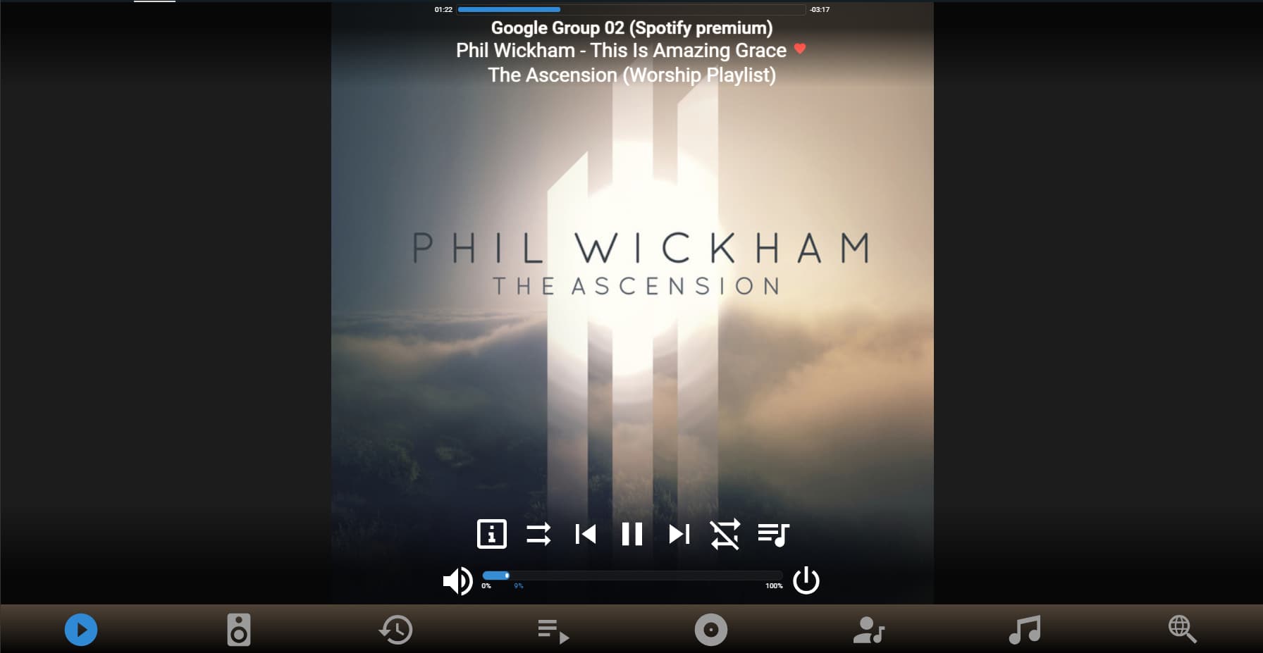

Another possibility is to use the SpotifyPlus Card Theme Options to make things in the display bigger (buttons, text, etc).
For example:
type: custom:spotifyplus-card
sections:
  - player
  - devices
  - playlistfavorites
  - albumfavorites
  - artistfavorites
  - recents
  - searchmedia
  - trackfavorites
entity: media_player.spotifyplus_todd_l
width: fill
height: fill
playerHeaderTitle: "{player.source} (Spotify {player.sp_user_product})"
playerHeaderArtistTrack: "{player.media_artist} - {player.media_title}"
playerHeaderAlbum: "{player.media_album_name} {player.sp_playlist_name_title}"
playerHeaderNoMediaPlayingText: "\"{player.name}\" - No Media playing ({player.state})"
footerIconSize: 4rem
deviceBrowserItemsPerRow: 6
deviceBrowserItemsShowHiddenDevices: false
deviceBrowserItemsHideSubTitle: true
mediaBrowserItemsTitleFontSize: 2rem
mediaBrowserItemsSubTitleFontSize: 1.3rem
playerControlsIconSize: 4rem
playerHeaderTitle1FontSize: 1.8rem
playerHeaderTitle2FontSize: 2rem
playerHeaderTitle3FontSize: 2rem
playerMinimizeOnIdle: false
Player Section

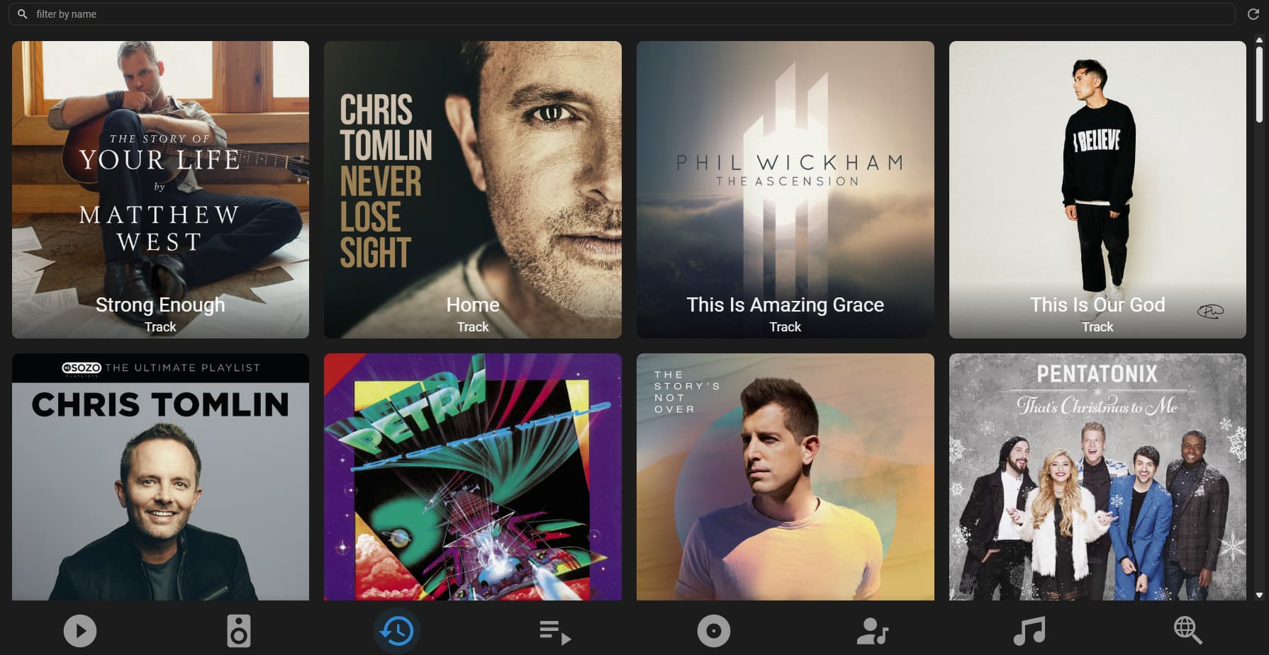

Recently Played Section

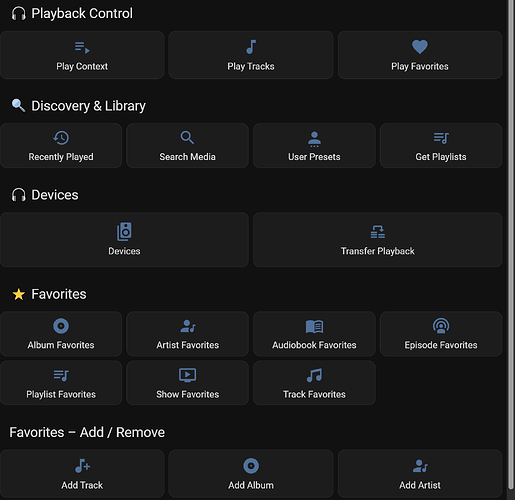

Yeah, that was the idea since the stock card buttons are too small, do not have descriptions, and missing many of the functions.
I changed the size using the theme setting, so that helps but having controls be a separate card would be more ideal for a control panel (like my screenshot has). This way we could position it where we need to, and manipulate it like we do any other card, using mod-card, CSS, etc.
Please consider making a ‘control panel’ integration. Things like the
SpotifyPlus Queue Info Update Template Sensor could be built-in as to ensure functionality. Playlists and control buttons could be dynamic. You have a ton of functionality and the documentation is deep and overwhelming, even to a techie like me. It is a ton on manual config and unless you are an expert, hard to understand what some of the required items like Spotify Connect device id (is this the canonical ID?).
Also would help to avoid “hidden code” like template sensors (I wish HA would change template sensors, they are not a good design being hidden/buried in a file)
thx
@Ltek
You could create multiple instances of the card, and enable only 1 section in each of them. You could then use the width and height options to control the size of each card to your taste.

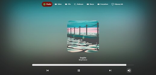

First of all, thank you very much for this excellent work.
I previously had a Spotify card project that was even published in the Home Assistant newsletter. That card was entirely created using Mushroom and Card Mod, and I had released version 3 as its latest update. I hadn’t refreshed it in a long time.
In the old card, the playlist name I was using wasn’t fully visible and I couldn’t get efficient use out of it. After the recent changes on the Spotcast side, the card had also become completely non-functional. That’s why I decided to update it, and while browsing the internet I came across your work. You’ve truly done an amazing job. Honestly, I’m so happy now that I no longer need Spotcast. On top of that, I’ll be using your media player in my card. I’ve even done a few small test runs, which you can see in the screenshots.
With this new Spotify card I’ve built, it has now become possible to use Spotify fully functional without even needing to open the original Spotify app. And all of this is thanks to you. I’m also planning to feature this on my YouTube channel soon.

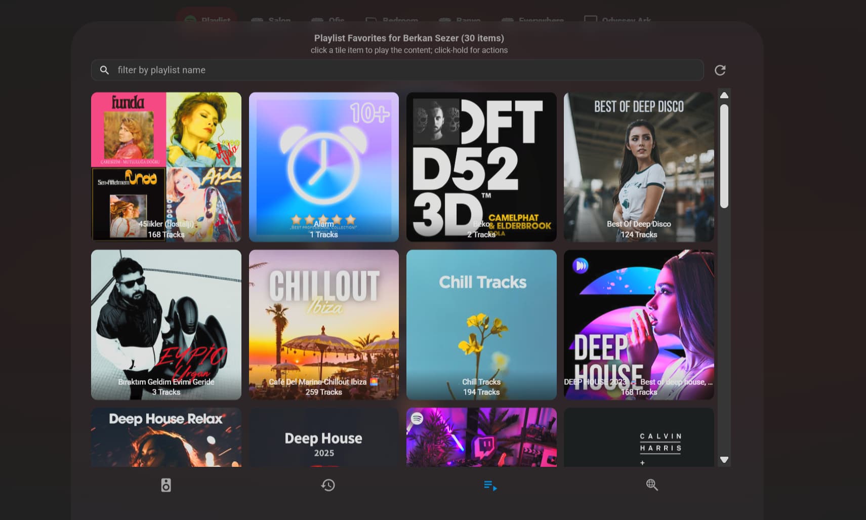

  2. In your media player card, when we click once on a playlist, it starts playing the song, and when we hold on it, it goes into the details. Is it possible to assign another function instead of long-press? Since I’ll be using the card inside a bubble card, I often scroll down, and I accidentally enter album details repeatedly. If there were an option like double-click instead of long-press, it would be much more convenient.
  3. When we go into the details of an album from a playlist, it shows all the songs with great detail. However, even if I press the play button before the song title, it doesn’t start playing. Is this a bug?
Thanks again for everything.
@berkans
Thank you for the kind words; I’m glad to hear you are enjoying the card.
To answer your questions …
  1. Use the SpotifyPlus Integration Always On configuration option to put the integration into “turned on” state automatically. Just check out the wiki docs link above for the performance impact (minimal) this can have on your HA instance due to continuous polling in always on condition.
  2. I don’t think I can change the press and hold behavior in the SpotifyPlus Card, as it uses special logic to detect the hold condition. I tried to stay true to other HA controls that utilize the press and hold functionality.
  3. In the SpotifyPlus Card, the button icon before the song title is actually a “Add item to play queue” function for various context (e.g. Album Tracks, Playlist Tracks / Episodes, Show Episodes, Audio Chapters, etc) items. It is not meant to play the item immediately, but it will play it as the next track if there are no other tracks in the play queue.

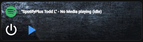

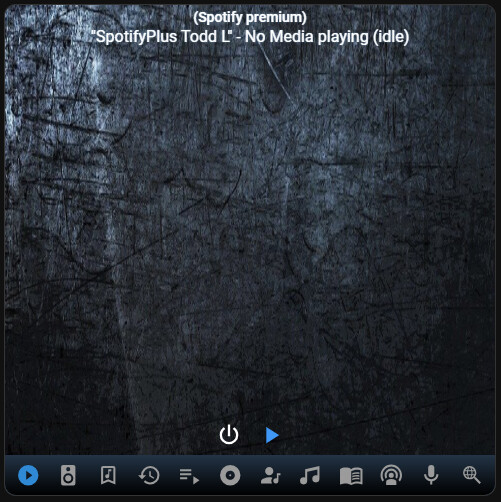

Can you send a screen capture of what you see so I can diagnose?
It sounds like you might be using the playerMinimizeOnIdle configuration option, which minimizes the player card height when player state goes to idle (or off) AND card height is not set to fill.
If that is the case, then there will only be 2 transport icons displayed (power, resume). Like so:
Versus regular mode when the player is idle:
