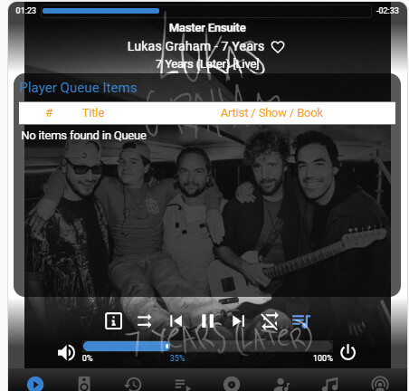

I am using old Sonos devices if that matters? I’ve also noticed the Queue is always empty and when I click to add an item to the queue it does nothing.

As for the queue always being empty, that is a known limitation of using Sonos devices with SpotifyPlus. Since they are considered “restricted” devices by the Spotify Web API, some functionality is disabled. In the case of Sonos, the Sonos local queue is used for the play queue.

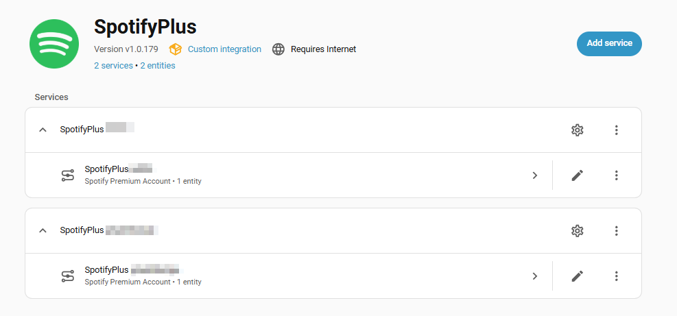

I setup multiple Spotify accounts so there are two in my spotifyplus_tokens.json and I have two setup in the integration. It’s a Connect:Amp (ZP120).
@Helheim
Try executing the following from Developer Tools \ Actions (yaml mode). This will list what application credentials are mapped to your individual SpotifyPlus media player instances.

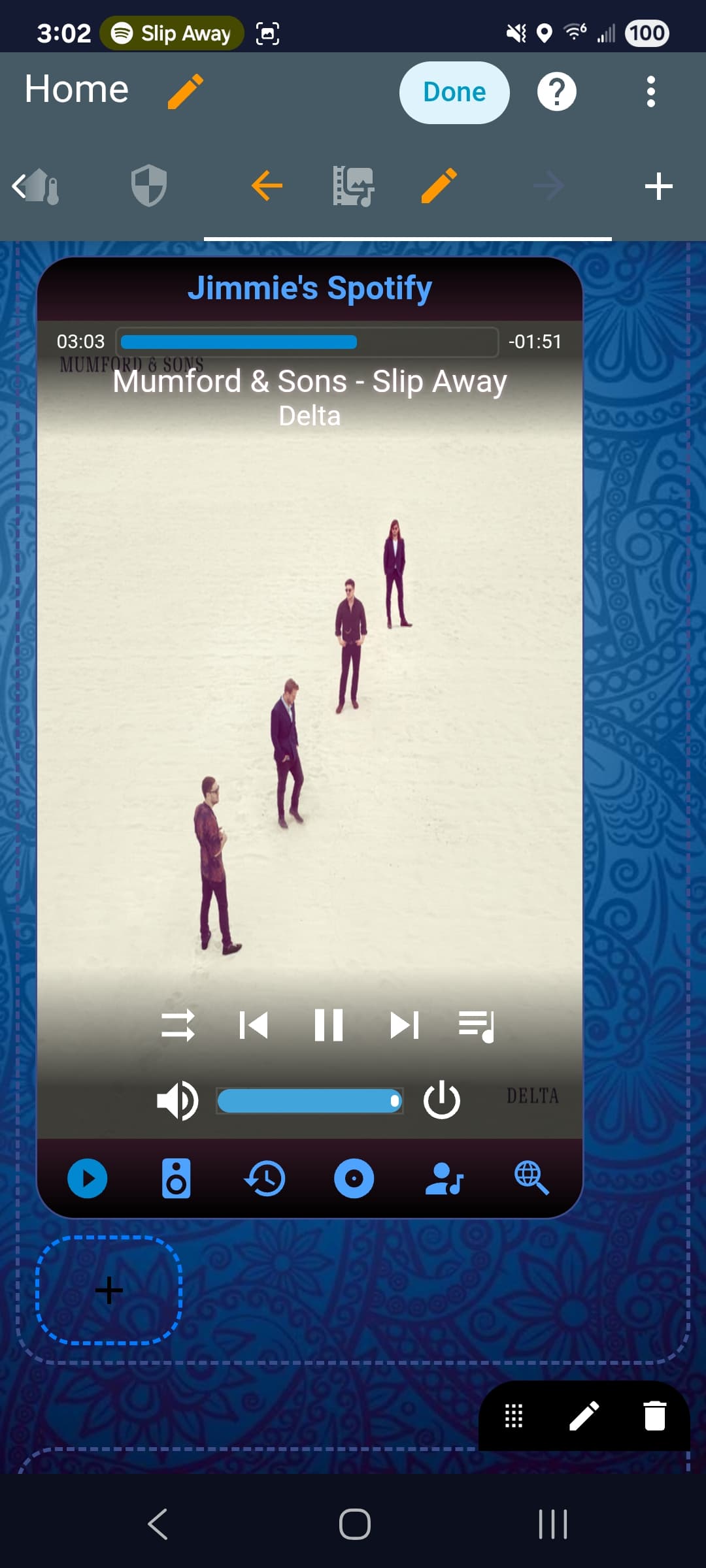

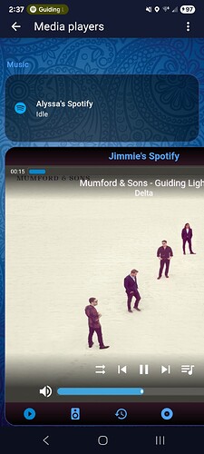

How exactly do you resize the card?
Here is the default view on my phone:
I’ve tried changing the width in the card, but it always looks like this, regardless of the rem size:
(example of Rem Size 2)
@jmm003
Renders the card with a width of 100%.

Does this look right?
What type of dashboard do you have the card in? You will need to set it to “Panel (single card)” view. I would suggest creating 2 different dashboards - 1 for mobile use, and 1 for desktop use.

Here’s mine on an iPhone 16 Pro Max:
The error was mine. I initially capitalized “fill.” Lower case fixed the issue. Renders perfectly now.

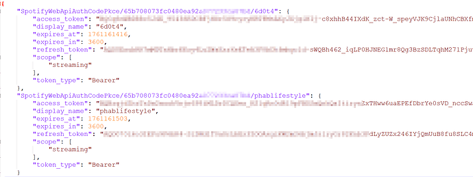

The 2 tokens appear to be good.

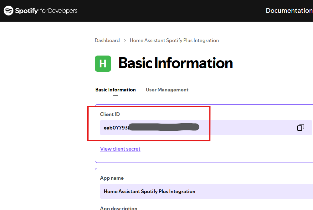

The App Credentials look good, though I could not verify that the ID: "spotifyplus_..." values were different between the 2 entries. You just need to make sure that the unique id value (e.g. 6d0t4) corresponds to that Spotify Developer App Client ID value. The easy way to do that is to logon to Spotify Developer Dashboard using your 6d0t4 username, click on your Home Assistant Spotify Plus Integration application, and verify the Client ID value.
Then repeat that process for the phablifestyle user and it’s client id value.
