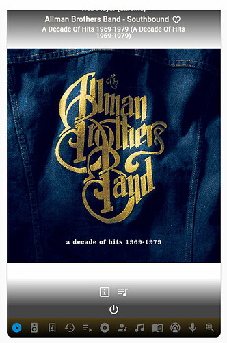

Hi! Great card and control - TY! Can you help me find why I’m missing controls and anything other than what you see? I believe I have everything set to display and no hiding.
@Grendelkid
It appears you are using a Spotify Free account with the integration; player control requires a Spotify Premium account (Spotify rules, not mine). This include player deck controls (pause, resume, skip next / prev, shuffle, repeat, volume up / down / mute) as well as starting play of tracks / context. You basically have to control the player on a Spotify mobile / desktop / web player.
The only things you can do with a Free account with SpotifyPlus are manage your favorites, and search for / display Spotify catalog information.
