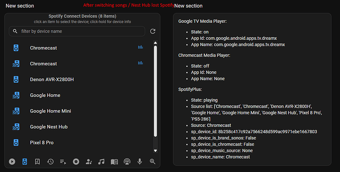

Some more information, after this I’ll get the trace but maybe you already have a better idea based on these 2 screenshots.
I created a debug dashboard showing the SpotifyPlus card and some info of my Google TV remote entity, the Chromecast mediaplayer and the SpotifyPlus mediaplayer. The first image is the state when I ask the Nest Hub to play music:
The second image is after I pressed the next track button:

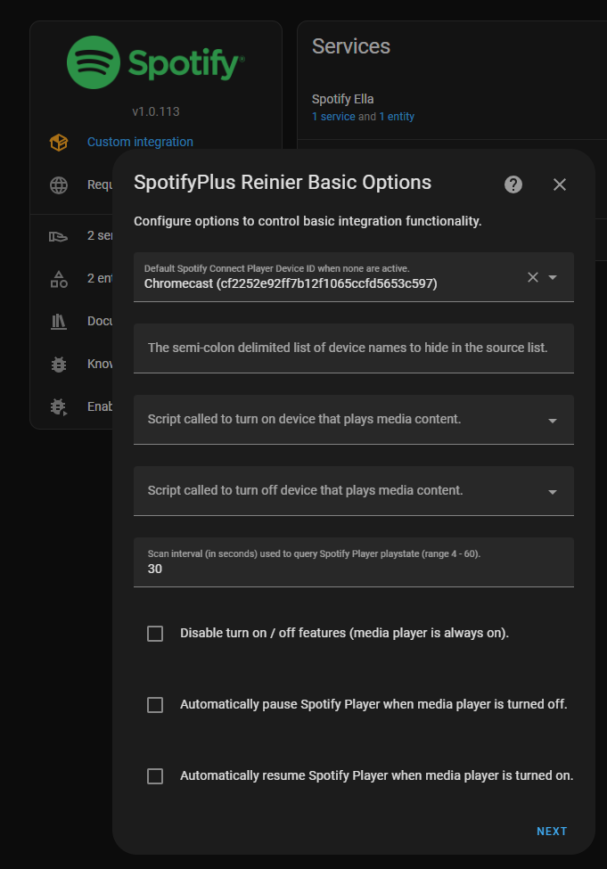

You can clearly see the sp_device_id changed and that the casting is no longer happening. The SpotifyPlus integration is configured with the device id that is used while casting with the Nest Hub, although what my expectation would be is that the integration doesn’t do anything with this default device if another device is already playing:
I also see why earlier I thought it didn’t matter which device is configured as default. Even though I have the cf2 device (the one used while casting) as default, it still resumes playback on the 8b2 device if I initiate playback with the SpotifyPlus integration.
This issue is caused by the 2 “Chromecast” devices having the same device name.
The skip next is passing in a device NAME (not device ID) to resolve, which is “Chromecast”. When it performs the lookup, it looks for a device name (not id) of Chromecast" and finds the 8b258c417c92a7566248d599ac9971ebe1667803device instance. The active Spotify Player device is "Chromecast (cf2252e92ff7b12f1065ccfd5653c597)", which is a different device. So the integration switches to the8b258c417c92a7566248d599ac9971ebe1667803` device id that was resolved.
I think all you need to do is rename one of the “Chromecast” devices to something else (e.g. “Chromecast Ella”, “Chromecast Reinier”, etc).
Here are the log entries that show what is happening:
Spotify Connect device skip next (deviceId = Chromecast)
Spotify Connect active device detected: "Chromecast" (cf2252e92ff7b12f1065ccfd5653c597)
Spotify Player device "Chromecast" (8b258c417c92a7566248d599ac9971ebe1667803) was found in the Spotify Connect Devices collection (by Name)
SpotifyClient http request: 'https://api.spotify.com/v1/me/player/next?device_id=8b258c417c92a7566248d599ac9971ebe1667803' (with urlparms)

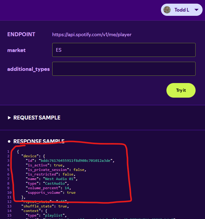

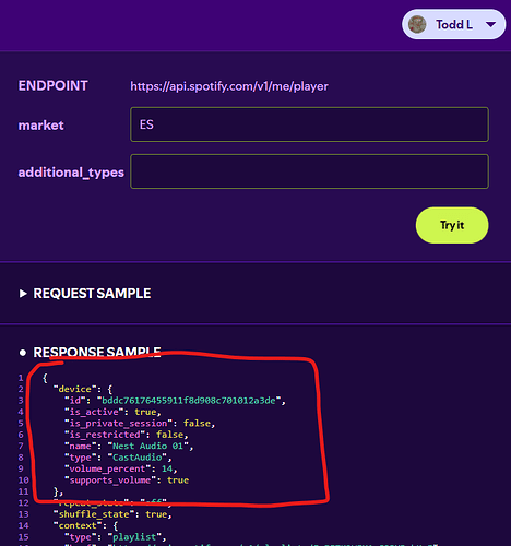

The get_spotify_connect_devices service will return all the information that is known for the devices at the time of registration, as well as the Spotify Connect Zeroconf getInfo call results.

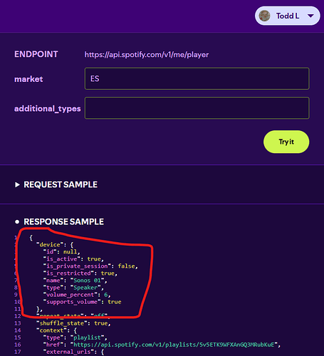

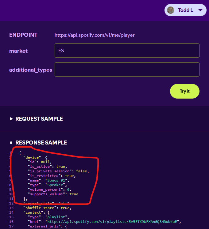

You can see what I am talking about with the device id not being populated for restricted devices in the Spotify Web API playerstate by issuing a call via the Spotify Developer web portal.
Here’s what the portal returns for a Sonos device (notice id is null, and name is populated):
Here’s what the portal returns for a Chromecast device (notice id and name are populated):
With the id value not being populated for restricted devices, I am forced to match on the name value to see if the device is already active. I use the results of the get_spotify_connect_devices service to perform the lookup on the name. In your case, you have 2 devices with the same name so it’s pulling the last one it finds in the device list for that name. The id’s are different though, so it’s transferring playback to the other device id.
The odd thing is that I have both the device name and the device id after discovering the devices via zeroconf. Why the Spotify Web API does not resolve the device id for restricted devices is beyond me. It’s just one of the hoops that I have to jump through to get playback to transfer to a device. If I can do this from a Python interface, why can’t the Spotify Web API do it natively?! It frustrates me sometimes, because the Spotify Player apps handle this just fine but their Spotify Web API does not handle it at all!
