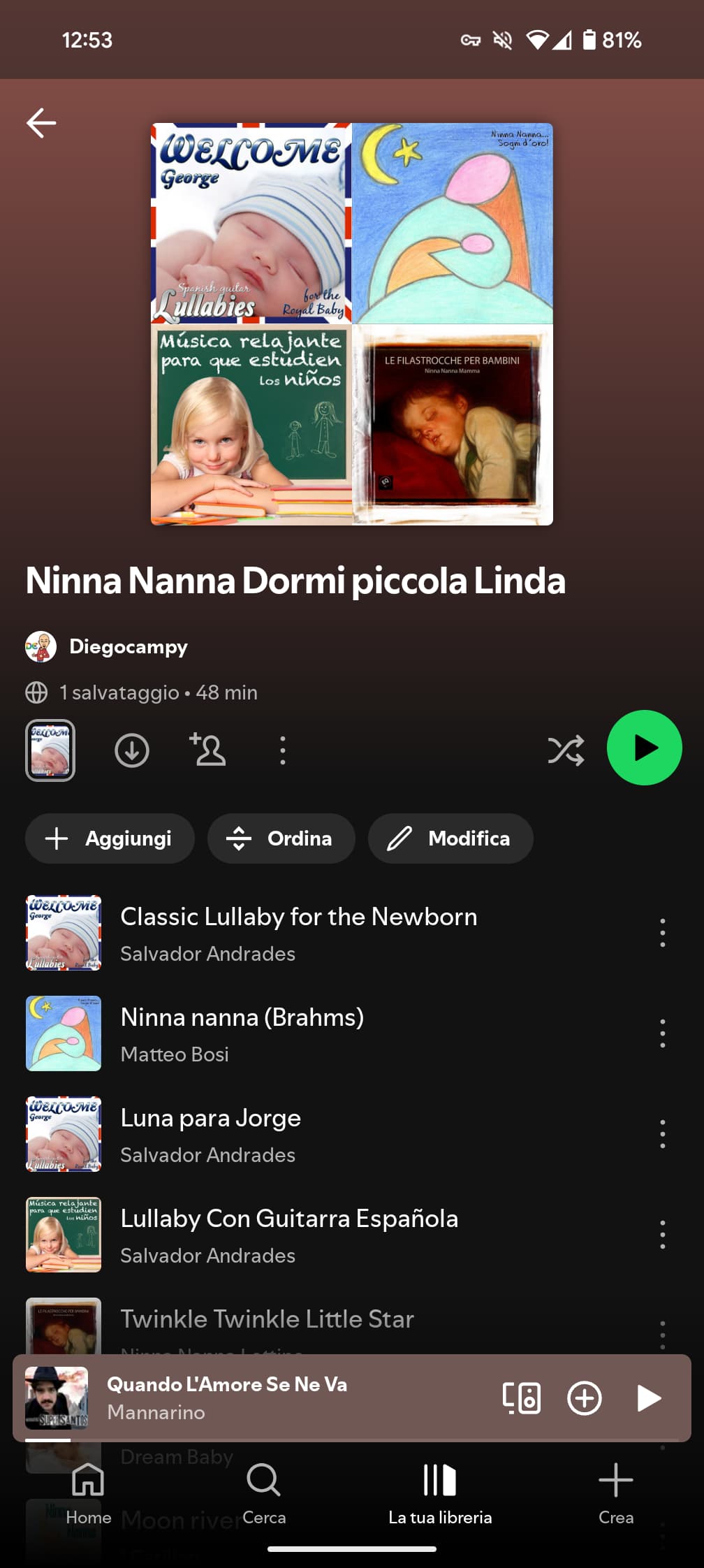

This is my famous ninna nanna playlist for my daughter. I don’t understand why despite if I listen to Spotify you start in the correct order, if used with integration, the order changes. ideas?
This is the code I Use :
action: spotifyplus.player_media_play_context
metadata: {}
  entity_id: media_player.spotifyplus_paintervale
  context_uri: >-
    https://open.spotify.com/playlist/4ufyQwaLq1MR49KvGRCNAo?si=AbYrmWorRKeW7G20B4c44A&pi=kT5FCDevRke6T
  device_id: Camera Linda
enabled: true
