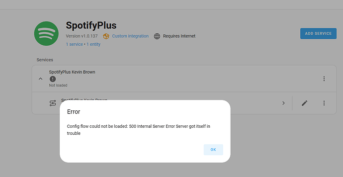

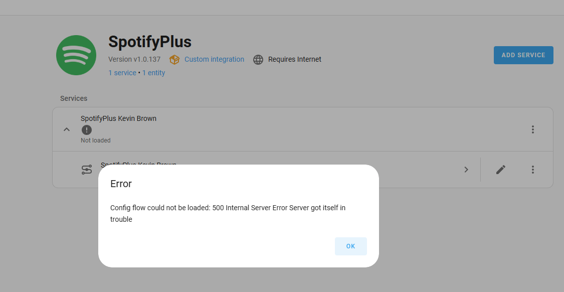

I think you have a real issue with latest Home Assistant software upgrade.
Even deleting everything, just choosing to add SpotifyPlus integration yields 500 error, config flow could not be loaded.
So I cannot even add back.

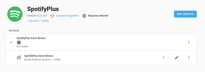

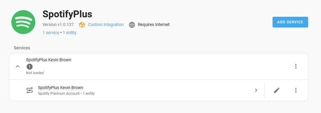

@kbrown01
If you installed Home Assistant 2025.7.0, then you must upgrade SpotifyPlus to v1.0.139 (or later), which was just released a couple of hours ago.
SpotifyPlus v1.0.137 (which is what you have installed based on your screen captures) will not work with HA 2025.7.0. The integration fails to load due to a RequirementsNotFound: Requirements for spotifyplus not found: ['spotifywebapipython>=1.0.221'] error, as shown in the HA system log.
The HA developers updated their urllib3 requirement from urllib3>=1.21.1,<1.27 to urllib3>=2.0 in the 2025.7.0 release. The SpotifyPlus integration, as well as 3 other supporting libraries, had to be updated to support this change by HA since they had requirements of the previous urllib3 version (1.26.0 I believe).
Hope that makes sense. Just update your SpotifyPlus to v1.0.139 via HACS and you should be good.
