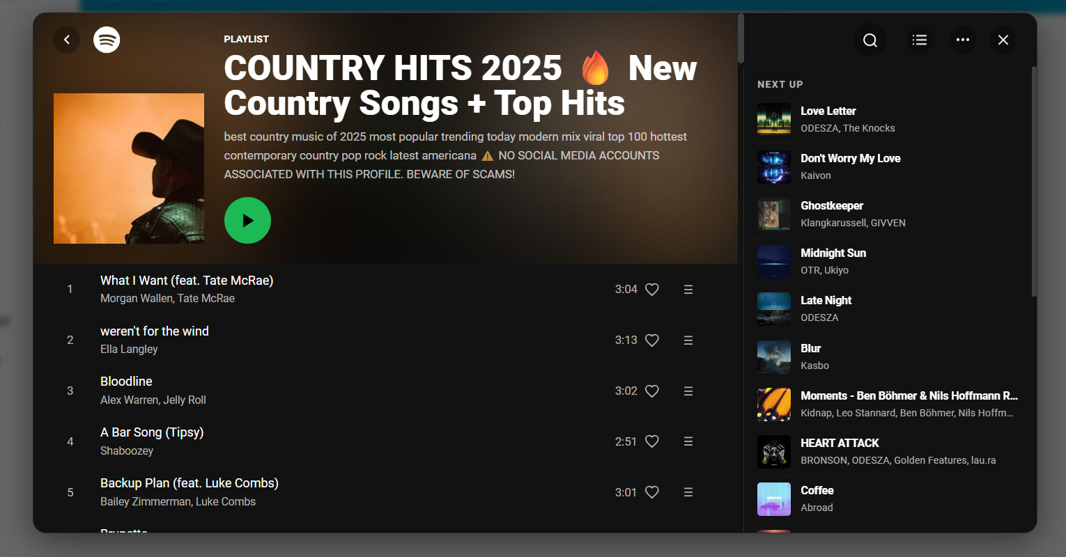

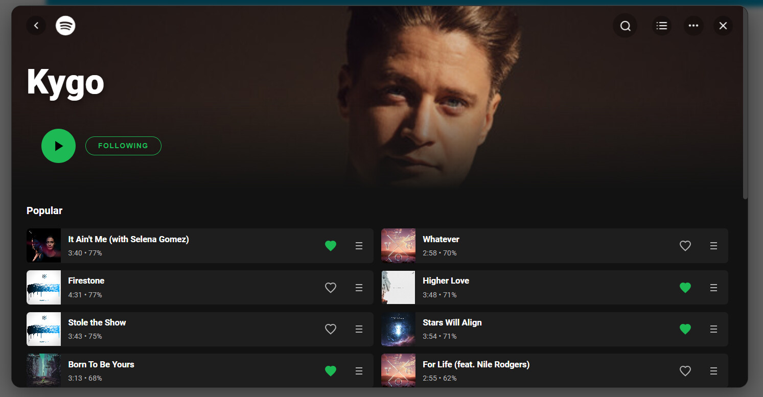

Excited to share a sneak peak of a lovelace card I’ve been working on that uses Spotify Plus.
