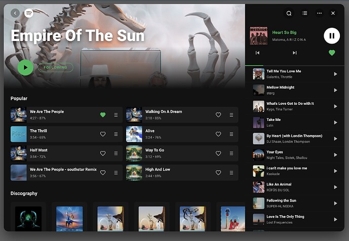

That looks awesome! Could you publish the yaml code here? Best regards
Stefan
@Richi No yaml really. Custom card that will be released via HACS shortly. Needs some more tweaking but hoping to release early next week.
Looks awesome. Exactly what the integration needs… you’re going to be a hero to many of us!
Will dump a beta tonight.
