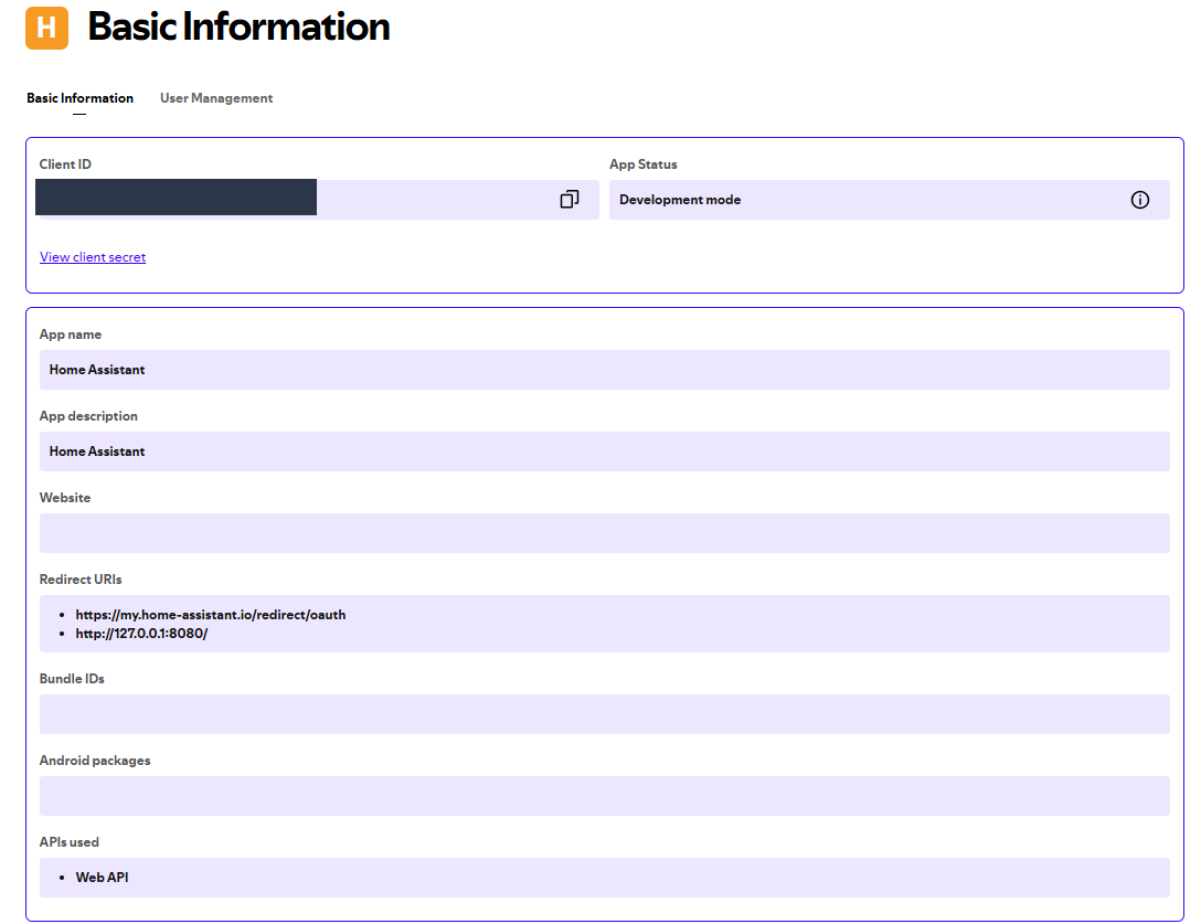

Can you send a screen capture of your Spotify Developer App settings (hide the client I’d and secret values).
Do you have any other processes that are using that Spotify Developer App client I’d?
Also, did you download the latest AuthTokenGenerator.py source? And did you update the spotifywebapipython library to the latest version prior to running the script?
Below the screen capture:
I don’t have any other processes for the Spotify developer app. I only set it up recently and used it for the standard Spotify Home Assistant integration, but I had deleted the standard Spotify integration before installing SpotifyPlus.
I installed SpotifyPlus + the associated scripts/libraries today - so it should be the latest ones.

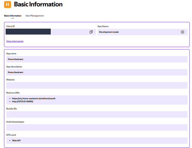

… just wanted to try something and set the Spotify app up from scratch. I have deleted it and wanted to create a new one. This is what I get:
Seems like an issue in the Spotify development environment right now.

Based on your screen capture, it seems your Developer App settings are correct. The “API rate limit exceeded” indicates something is making too many requests to the Spotify API using your client id / secret. I have never heard of anyone experiencing this error using the integration or the AuthTokenGenerator process. This leads me to believe it’s either a temporary condition with the Spotify authorization servers, as your Spotify Developer App settings look good.
